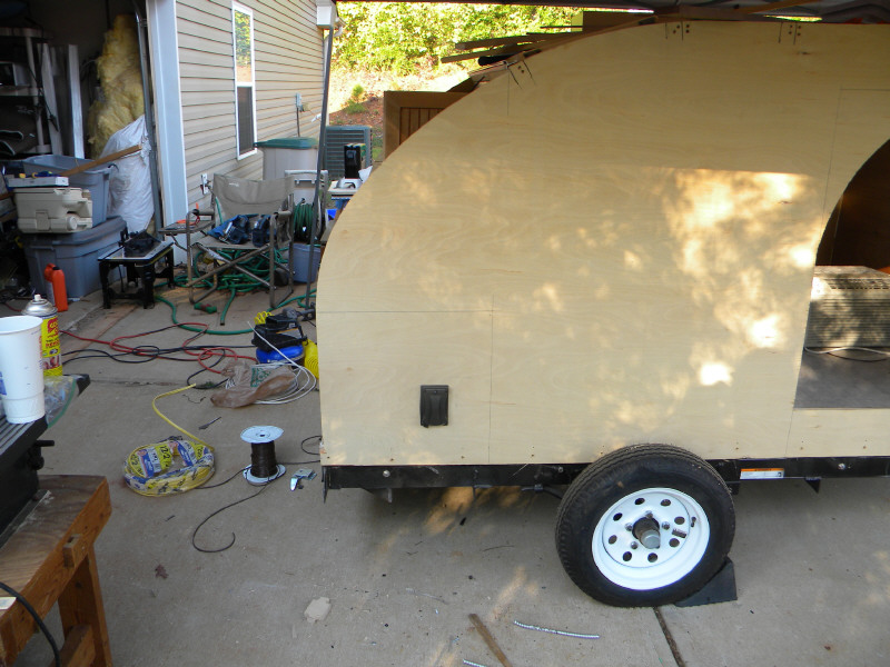

Postby CliffinGA » Sun Sep 25, 2011 9:43 pm

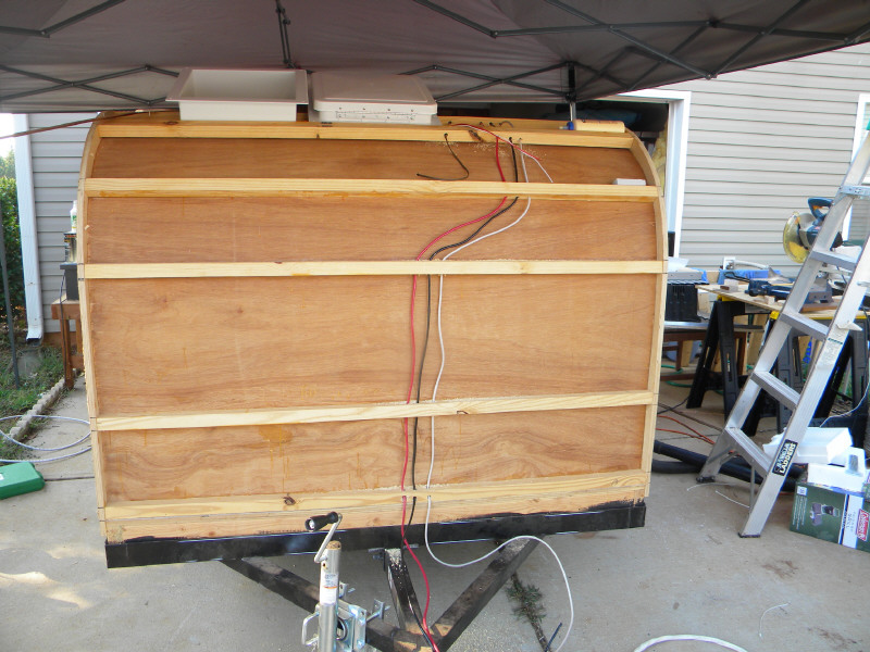

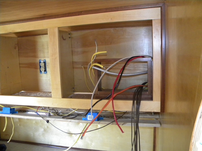

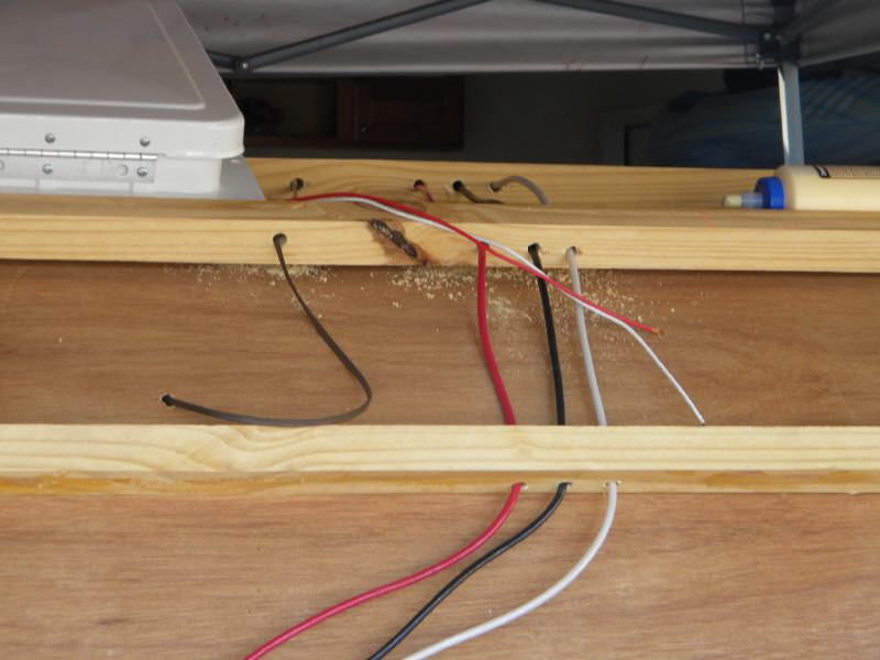

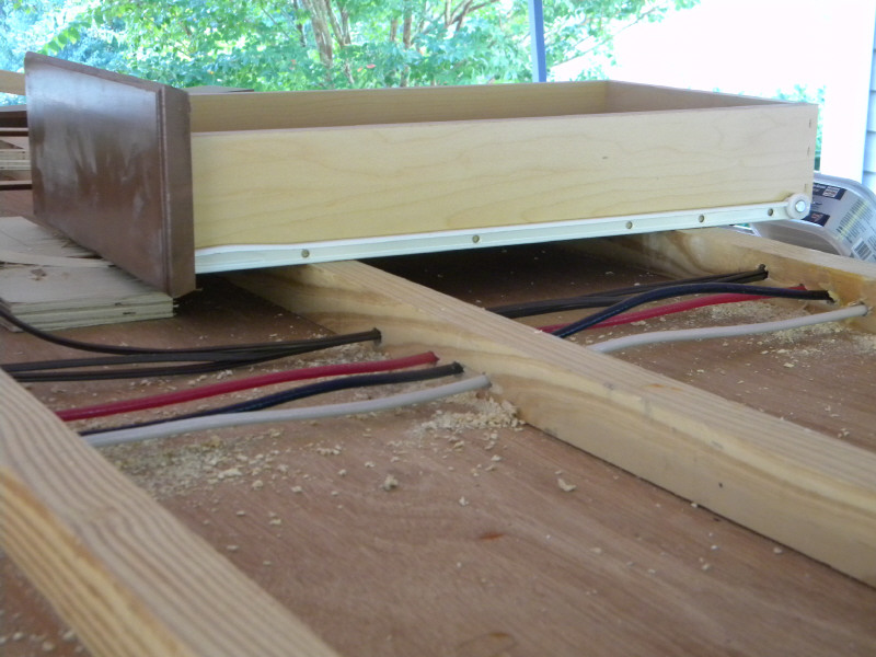

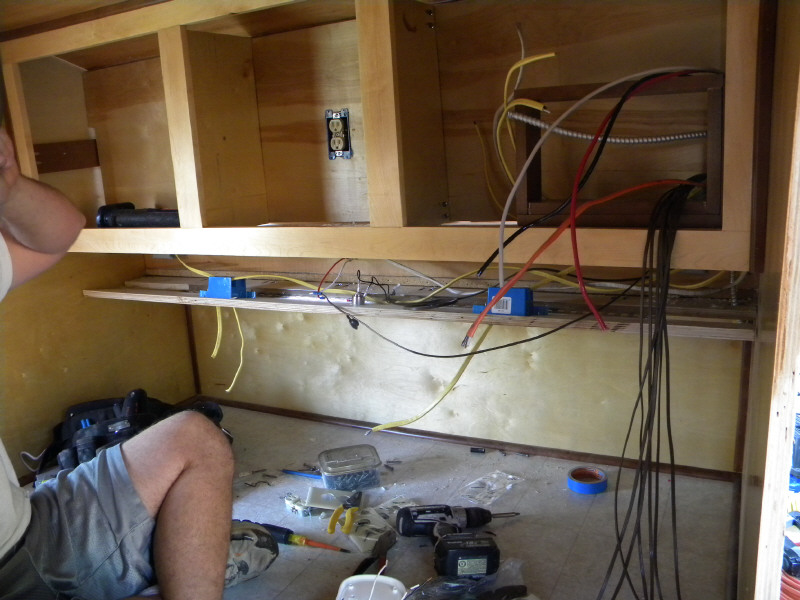

Ol all tired today but mostly got the "Hole" wired, some stuff will be finished later due to some issues: The vendor I bought the double 15A and 20 amp breakers were wrong ones for my Elixir center (Also perchaed from him) and some the fixtures will be wired when I get exterior finished but the wire has been run.
30 amp Inlet (will be painted black)
Exterior outlet
7/16" hole drilled for 12V acc (Create a breeze, map light, double dome light and porch light) 3-3/8" holes for the main ground to frame, pos and neg battery cables (6 gauge), I know some say you don't but the Elixir power converter box specifies it.
Front run
Wires for battery
Wiring inside waiting for the box, moved inside so I could hide the wires better
view of my bud JR and the electrical run

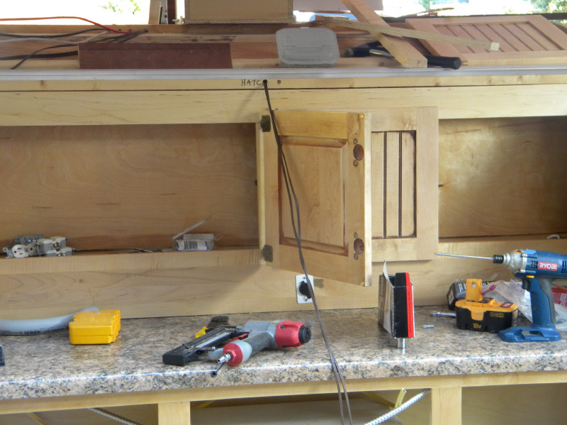

Last the galley but it cut the plugs out :lol: , we have 3 outlets inside 2 above the ctop, 1 exterior and 1 in bottom cabinet for the microwave, and 2 12V outlets 1 inside 1 in galley, 1 create a breeze fan,1 map light below shelf, 1 double dome light inside,2 double dome light for inner hatch/galley and 1 porch light!
Last but no pic tried to rework the hatch but will start over as the thing is still torquing when you open it and is going catty wompas so it goes to one side and does not close completely with one side always catchinh the side of the tear :?. At this point I believe the plwood sides of the hatch are warped so I will recut next week and willdo it differently :lol:.
Thats all and I'm tired and so is my "Hole" Kirk :lol:
Cliff (& Sheri) :thumbsup:

Postby Woodstramp » Sun Sep 25, 2011 10:07 pm
Cliff, sorry all our wires got crossed for Cloudland. (electrical pun) 8)
Where'd you order this 30A inlet fixture? And how much? What I'm using is working, but I'd like to add one of these one day.

Postby CliffinGA » Sun Sep 25, 2011 10:34 pm
Thanks Chuck, we'll catch up at another one when Im done this tear. I got that it ay West Marine for $62 I think, if you need 15amp you can get those from bass pro.
