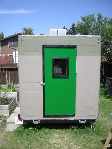

Today we tried to install the door, and ran into 2 problems. One was that the top of the door (somehow) was narrower than the bottom of it. I had to put shims into the right side of the door frame, to get rid of a huge gap at the top left side. Then the door fit, but was catching on the bottom a little. I could still close it, but I had to lift it a little bit each time. I took the door down and planed the bottom a little, so it wouldn't drag.
Now it won't stay closed! I am wishing I left it the way it was before. :cry: I installed the latch on the outside, and have a screwdriver stuck through it so the door won't swing open. Doors are so tricky!

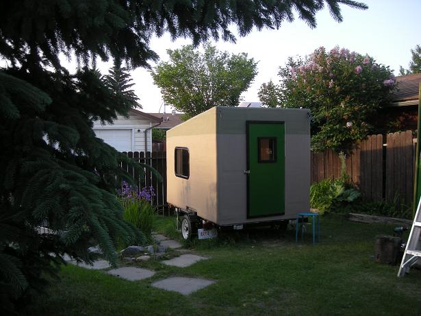

A momentous day! We bolted the trailer back to its frame (I had taken the bolts out when I tucked the canvas edges underneath) and I closed up the small panels where the bolt heads are hidden. All the big jobs are done, and I have turned a corner from "building the trailer" to "prepping the trailer for its shakedown trip". :thumbsup:
Though there are still details to take care of, there is nothing that would prevent the trailer from being "campable". On Tue we will carefully check and tighten everything (lug nuts, etc) then on Wed we will take a spin to the Red Deer area (a couple of hours away) to see how she behaves on the highway. If any problems arise, we will still have several days to fix them before our longer trip begins.

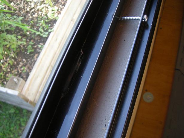

The trailer had its first rain test last night. I found one small leak. There was a little bit of water between one of the windows and its inner frame. Now to figure out how it got in. :thinking:
The other window, door, and roof vent held up wonderfully.
In this photo you can see a wide black line (the window), a narrow black line (the clamp frame on the inside) and a beige area in between (the canvas-covered surface of the window opening). That beige area is where the water was.

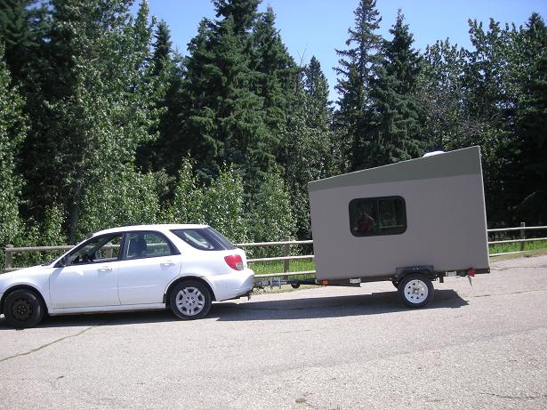

First highway test today! :P
We drove to Red Deer, which is about 1 1/2 hrs from Calgary, had lunch with friends, and drove back. The trailer towed well, though Mark says he can feel a tiny amount of drag. The front end of the trailer was originally supposed to have a triangular section out on the tongue, for wind deflection, but as you may recall I got behind due to lots of weather troubles and had to postpone that. The front end, as it is right now, is higher than the car and not as aerodynamic as it could have been.
That said, the trailer should work just fine for our camping purposes. I will calculate a gas mileage soon.
I haven't weighed the trailer yet, but it is light enough that Mark and I backed it into the yard (uphill) by pushing it manually; it seemed easier than maneuvering with the car. ;)

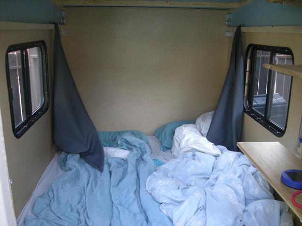

One last pic before we go- the morning after the sleep test!
