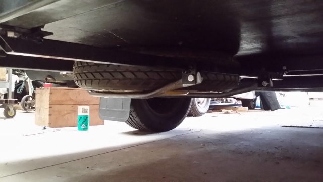

Thanks again guys for your support. :applause: The riv-nut idea would have been good, but not having any to hand would have meant a trip into town to get some and I doubt that there would have been anyone open today that would have had what I needed. And having to fit five days of work into 3 days I wont have much time through the week. We are heading off on Thursday morning, and I have just seen the weather for cast for the week and Friday is looking like crap :EXP :rainy:
Anyway its coffee time again :coffee: this time will a dash of Baileys in it to celebrate :D
It is all done and I am very pleased with the way it came out. :ok: You're not wrong about welding underneath the frame it is bad enough just getting up and down under that thing now that the ground is much lower than it used to be. :shock:
So here are the results.

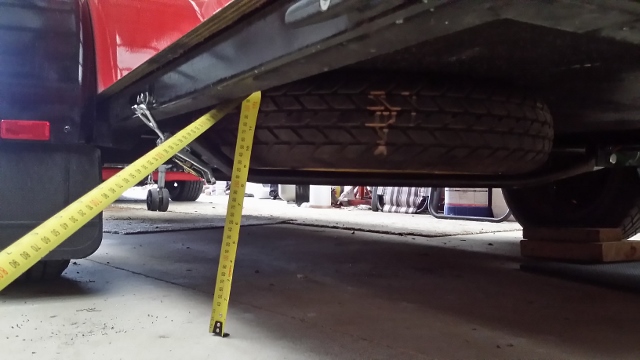

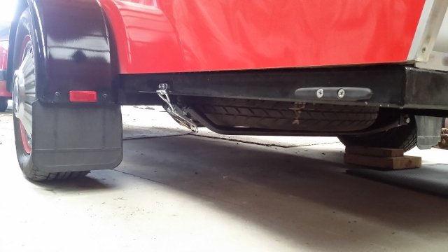

I have got 200 mm (8 ins) ground clearance and it sits well above the exit angle between the bottom of the wheel and the rear of the frame. The wheel weighs about 9kg and there is not much weight in the rest of it,
2015-02-01 17.52.32 (640x360).jpg (105.57 KiB) Viewed 2848 times
2015-02-01 17.53.59 (640x360).jpg (118.8 KiB) Viewed 2848 times
2015-02-01 17.55.29 (640x360).jpg (117.35 KiB) Viewed 2848 times
With 8 bolts in that bar it should be as solid as a brick :poop:

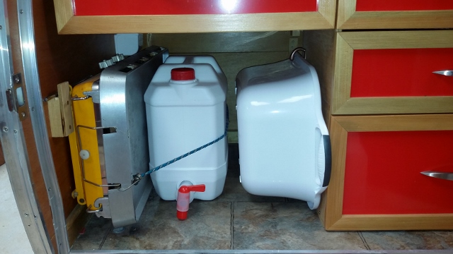

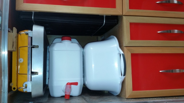

We are having a bit of a re-hash in the galley. It started with wanting to change our water container to something a little better than the transparent 10 litre disposable supermarket bottled water type with the funny little squeeze valve.
Bar-B-Q, water container, folding crate, wash basin.
On our way through Auckland recently, with the TD, we called in on a plastics manufacturer to look at what options they had, and bought a more substantial 10 litre container with a proper tap on it. The tap has an air bleed vent built in to it, so you can keep the lid on top shut tight.
The container was a bit wider than the old one, which meant finding another place to stow our folding crate.
There is space in the drawer behind the chiller with the portable cooker and gas canisters but that would make things a bit awkward to get in and out.

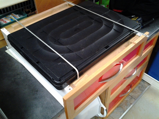

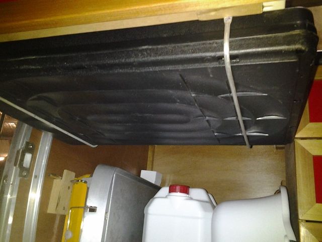

Then I saw I had space to hang it under the drawer above the water container.

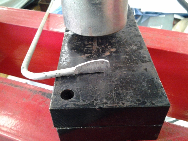

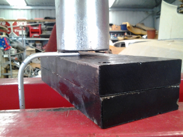

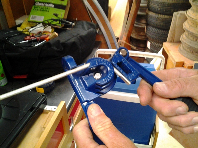

Next issue, how to stow it there. A timber frame was going to be too bulky, so I went looking amongst the scrap metals in the corner of the shed and spotted some 3mm alloy rod (parts of an old tv aerial).
Thanks to a 20 tonne press I flattened the ends to take screw holes,
and bent it to shape with a tube bender and screwed it in,
perfect. :EXP

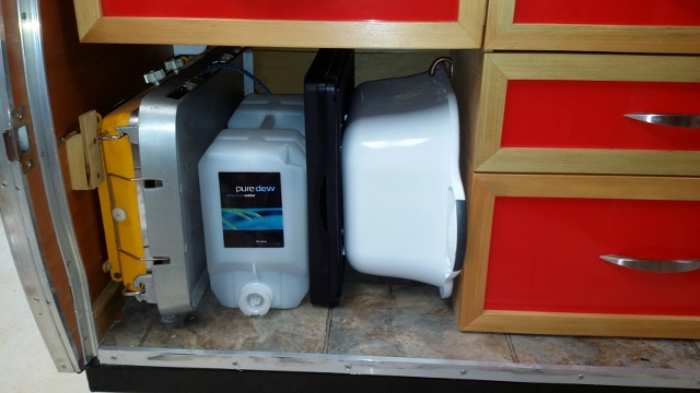

So now that I am thinking about it, I am going to re organise the chiller drawer.
