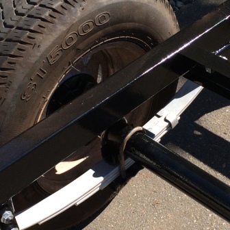

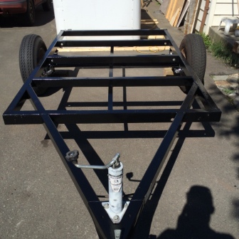

you've all seen it before but it IS another phase in the journey---
axle and springs reattached to chassis----the springs are spray-painted w/ tremclad 'aluminum' rust paint
chassis flipped back and ready for a new body
most likely some bearing work in the future but i'm only concerned with getting things ready for the transplant tomorrow night :beer:

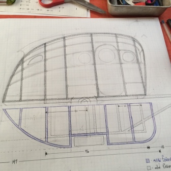

Postby dave campbell » Sun Sep 13, 2015 2:37 am

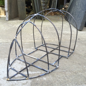

well-----here i am. started building the construction platform on or around july 14........from drawing to model to real thing.
living the dream !!

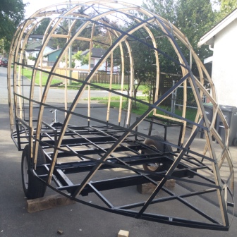

Postby dave campbell » Sun Sep 13, 2015 1:06 pm

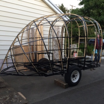

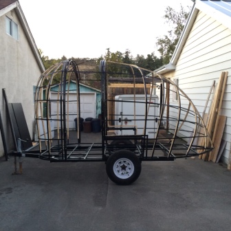

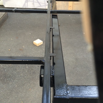

dales133 wrote:Looking good dave whats your next step?
next step ?--- weld the two together
next step after that ? ummmmmm........ how about install the floor. ya that's it. also i will be starting the card-board templating in preparation for aluminum, gathering PEX tubing for wire conduit, and dialing in the wooden ribs. (i have to countersink about 90 screws, as i just quickly installed them to hold on the 1/4"x 1 ply strips. i found that if i drove them home, the thin plywood strips usually just split----so i just screwed them in enough to hold the stips in place and play with the curvature a bit while the glue dried )
i like to say that this was good planning for ( some wee over the wheel drawers ?) but more than likely a combo of bad math and caution. it works well with the height of the bed (15") but i could have made these a bit lower and built up with something lighter...
not quite what i intended back here but it works. ideally the two bars would be one on top of the other....
a little short.JPG (49.61 KiB) Viewed 2440 times
one more angle
cage on frame--another angle.JPG (73.82 KiB) Viewed 2440 times

Postby dales133 » Sun Sep 13, 2015 1:13 pm
Nice!
Have a look out for something like this http://www.bunnings.com.au/p-n-10g-quic ... t_p6370310
You might want it in a smaller gague though
Or this http://www.bunnings.com.au/p-n-12g-quic ... -_p6320596.
I use both at work and they will drill into steel numerous time for a pilot hole plus countersink for you no probs.
What glue are you using?

Postby dave campbell » Sun Sep 13, 2015 1:14 pm
noseoil wrote:Dave, looking really good now. I can see more people doing one now that you're showing how it's done. Looks great on the frame!
thanks noseoil !! it is sure taking some getting used to though. my initial response to the added height was chagrin. after seeing it on the ground for so long i grew used to the height of it---felt more stretched than up on the frame. it's a giant friggin' toaster---no wait it's an iron----doh !! as for more people doing a build like this ? it would be great to see some improvements on the build technique !!
