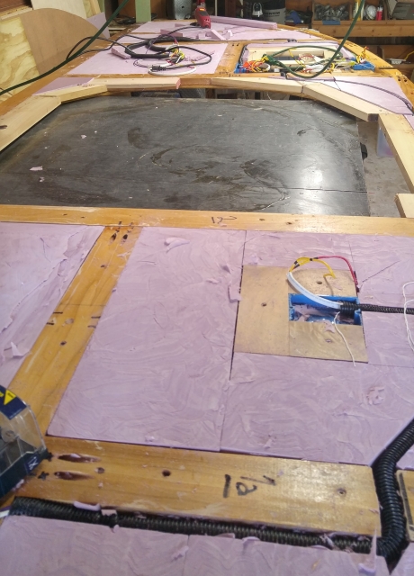

Now that the driver's side 12v wiring is more or less squared away, I've been working on the insulation and framing the door & window. Shaving the insulation down to the height of the studs (it was something like 1/8" too thick <eyeroll>) is the sort of repetitive, fiddly task that is halfway between "annoying" and "meditative." And those darn foam shavings have the worst static cling I've ever seen--they blew everywhere and then adhered, just out of sheer cussedness. Anyway, we're almost all levelish now. I've got a few small pieces left, and then I'll fill in the gaps with puffy foam and THEN it will be ready for the inner skin to be cut and installed.

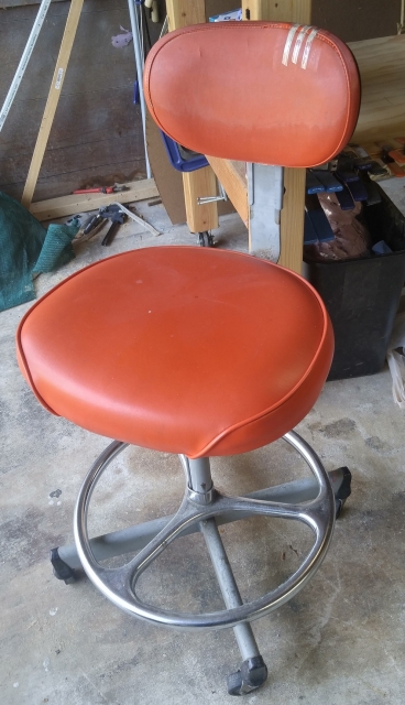

Oh, and I almost forgot! I was at the Texas State Agency Surplus warehouse the other day, when I stumbled on this lovely orange vinyl chair. For NINE DOLLARS. Yes, one of its seams is splitting, and yes, it's clearly about 50 years old, and yes it is exceedingly, even criminally, orange. But still. NINE DOLLARS. And the casters work. So I've now got an official Shop Chair, so I can do my staring, frowning, muttering, frowning, staring, and knuckling my forehead from the comfort of an upholstered rolly chair.
Artisanally hand-shaved insulated. Well, shaved by a hand holding an oscillating tool:
The Throne:

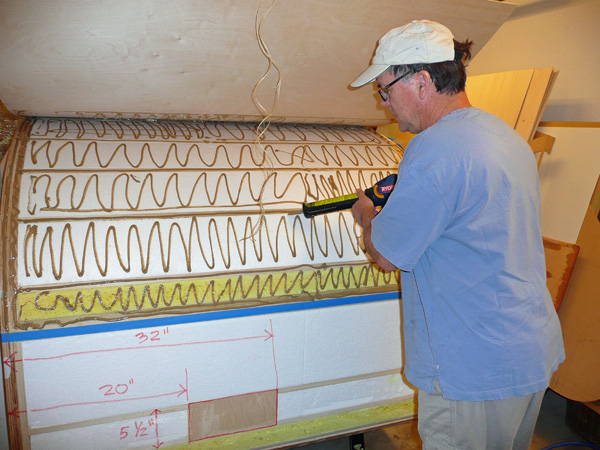

I'm a big fan of PL Premium for gluing skins.
You really don't need complete coverage of the PL for the skins. I applied the PL in a zizg-zag pattern:
Image.
Then I used a disposable plastic v-notch (1/4" notch) trowel to spread the PL. The trowel creates many small "hills" of adhesive. Then I added the plywood skins. Even though there is a not full adhesive joint, the end product is very rigid.
This method is similar to applying thin-set mortar for ceramic tile.

It's a Pondering Chair! A wise investment, teardrop builder.

My foam was a little to thick also. I used a piece of 1"x 1" square steel tubing with a strip of 40 grit sand paper glued on one edge to sand it down. It worked great but a HUGE MESS.

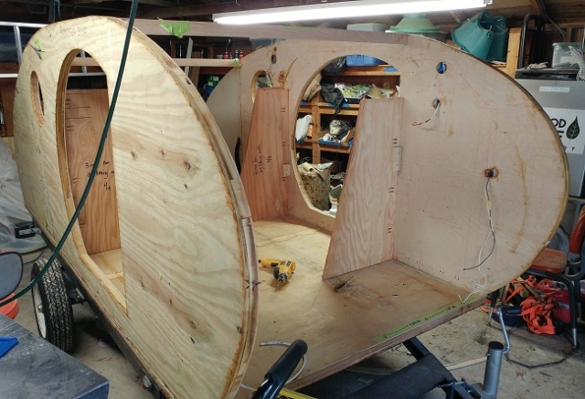

Anyway, by mid-May I had whacked most of the moles I could find to whack, so I decided to finally get the walls up by the end of the Memorial Day holiday. This entailed finally gluing and nailing the interior skins on, a terrifyingly permanent step. I tested all the wires with an ohm meter, but none of the batteries or switches or light fixtures are connected to them. What if... I dunno... I discover that I miscounted the number of circuits I need? What if...the wires I used turn out to be some cheap knockoff that melts when I run a current through it? What if... an infestation of robot cockroaches attacks the trailer and eats all my wiring right out of the walls? Huh? What then?!?
But, sometimes, you just have to stick a fork in it.
So with Mr P's help, we closed up the walls. Permanently.
And then we glued and screwed them to the floor! Hot diggity!
I had used The Mix on the floor and the bottom of the walls, so for adhesive I used great heaping globs of PL Premium and screwed everything down with pocket holes. We screwed some temporary plywood braces to the walls to hold them upright during the proceedings, and installed a couple of oak crosspieces to hold the two walls parallel.

One wall up:

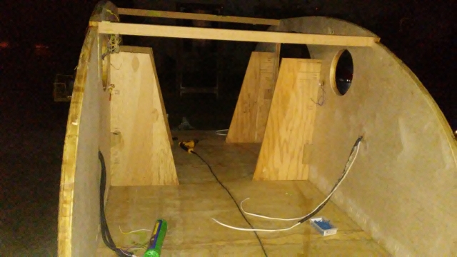

The braces:

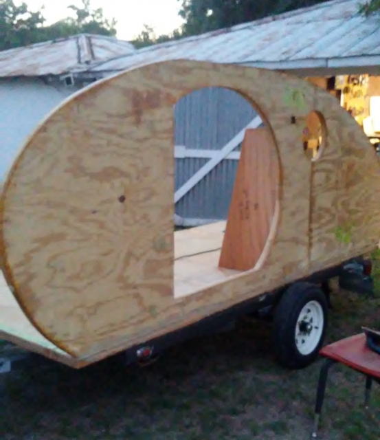

The final product:
