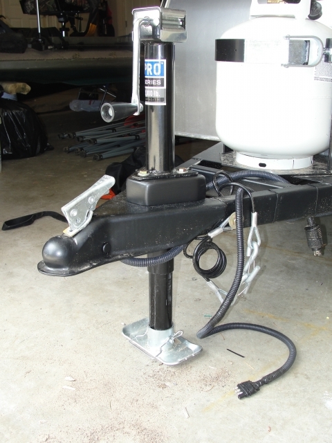

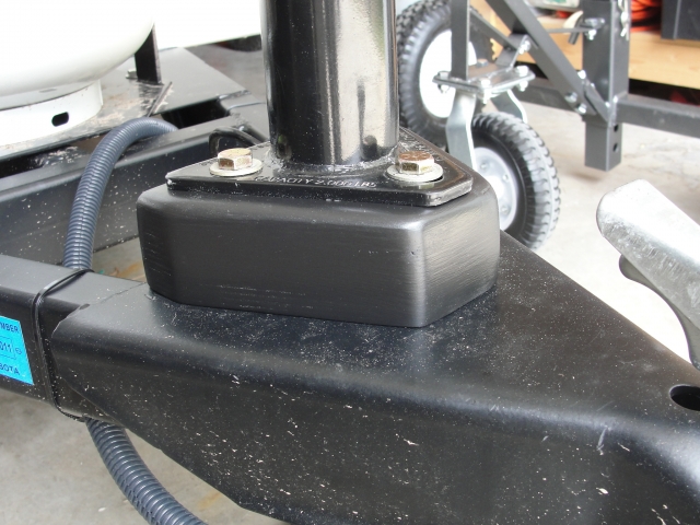

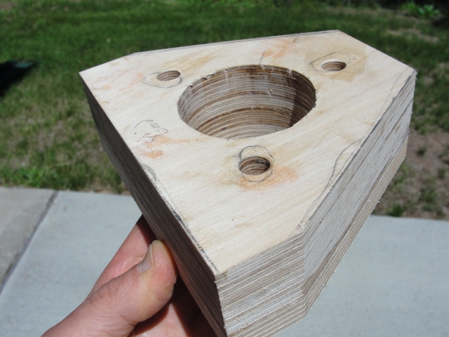

I bought the smallest A-frame jack I could find and it still rode too low to the ground while towing. This could cause some damage while towing if the car and trailer got in different planes while maneuvering across something steep. My brother convinced me that I should build a spacer to raise it up a bit.
Three layers of Baltic birch scrap provide a means to raise the jack another 1 3/4" from the road.
Here's the final product after sanding, two liberal coats of CPES, and two coats of black paint.
I dislike folding tongue jacks, so making this A-frame jack work was a priority. I believe that it's raised up high enough now and this dense spacer will easily hold the static tongue weight. Another post-build item completed on my punch list...

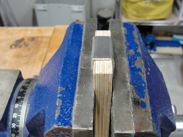

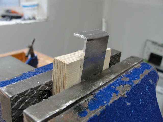

Winds crippled the stove on our second trip. I built a wind deflector of scrap .060" aluminum from the roof. The first step was to build brackets to support the shield on the sides of the stove.

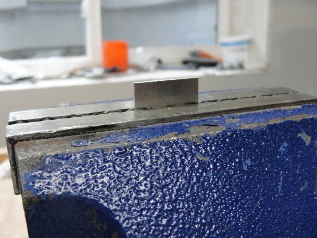

This piece is 1" by 2". 3/8" is exposed for the first bend.
I used a dead blow mallet to bend it 90 degrees.

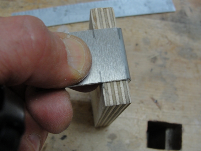

I wanted about a 1/2" shelf. This scrap of 1/2" plywood makes a great bending form for the second bend. Here I used it to mark the second bend.
Positioned for the second bend.
Second bend complete.

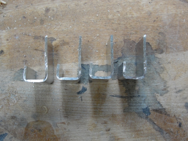

Four brackets complete that look pretty much the same.

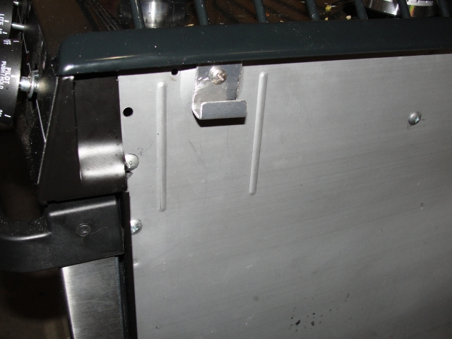

Bracket installed on side of stove.
Two-sided wind deflector complete.
