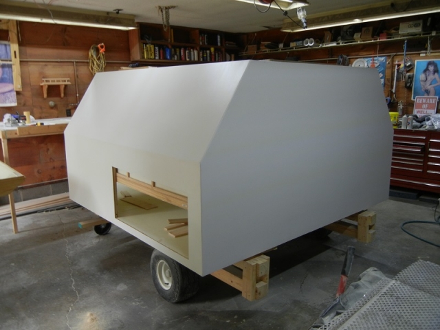

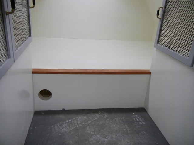

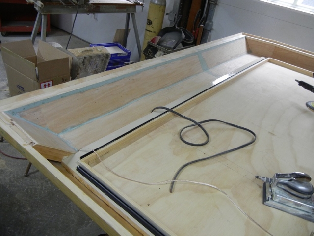

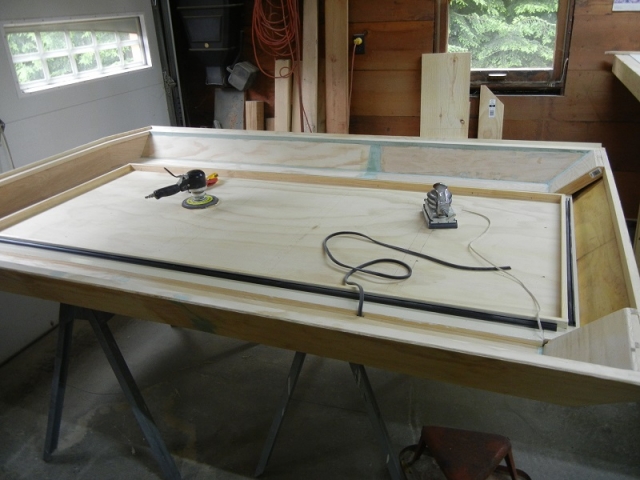

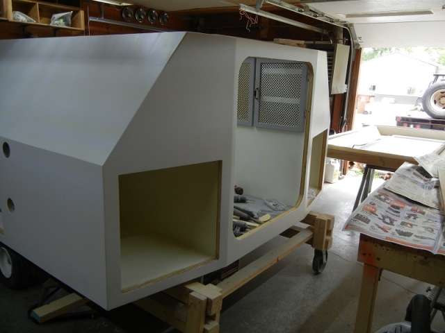

Time for another update. The last post I was ready to pull the top off and sheet the inside with plywood. Here are two pic's of the sheeting work. At the point when these pic's were taken the inside was ready for glass and resin. The green strips is the epoxy fairing compound I used on the warped side walls. Rather than try and buildup the corners with regular epoxy and thickners. It was faster to use the fairing compound. One pass and done.

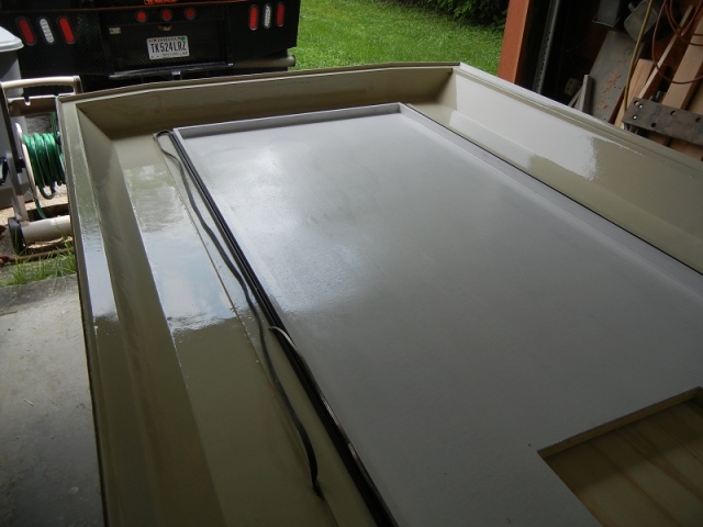

These next two pic's show the inside with all painting done. I forgot to get pic's of the glass work I did. I have cut the exhaust fan opening on the inside of the top. I'll cut the outside after the top has all the glass work is done.

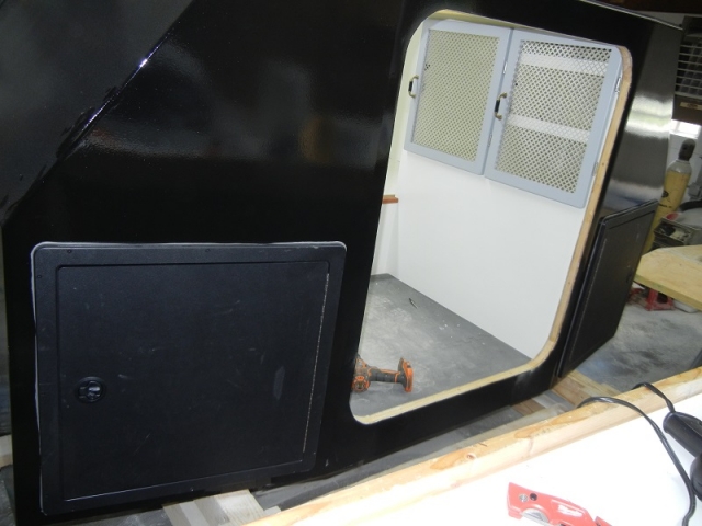

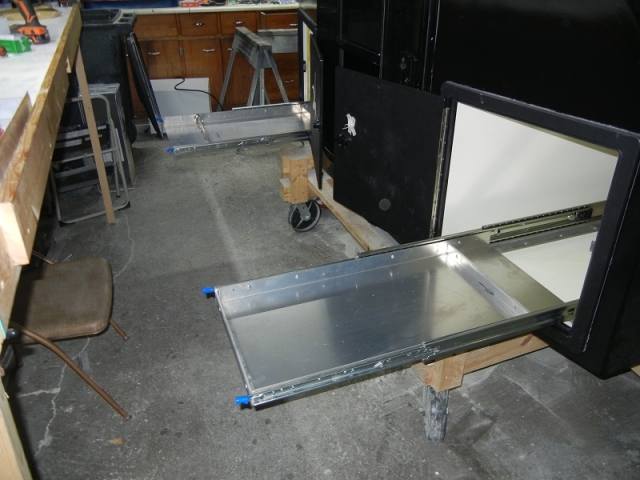

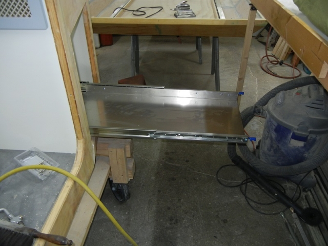

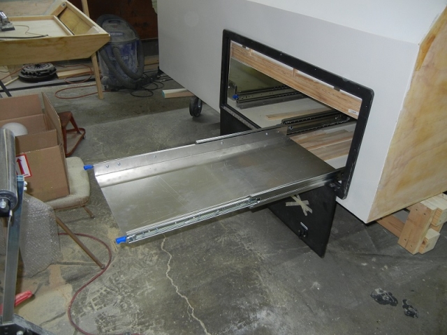

Now for a few other pic's of other things I was doing while glass or paint work was drying. These two pic's are two of the slide outs with the pans installed. I have the other two pans. I haven't got them drilled for mounting yet. The slide outs have not been mounted in yet. I'll do that after the body is painted. I don't want to gum up new slides with sanding dust.

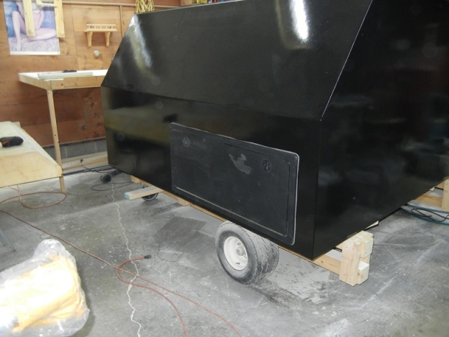

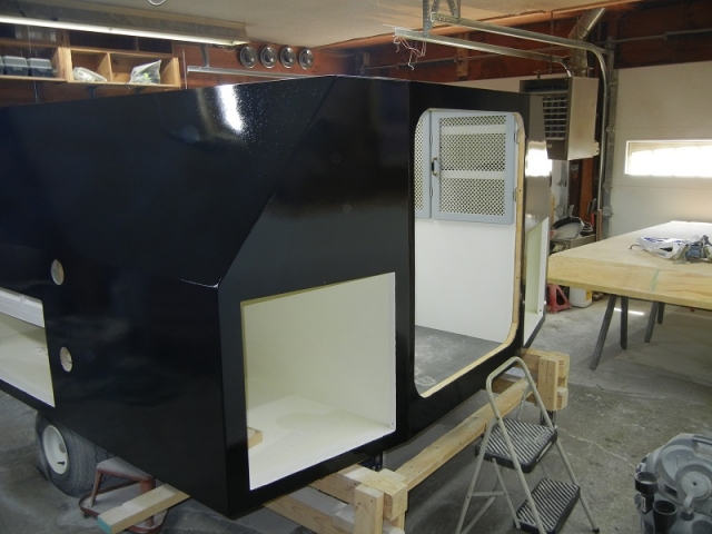

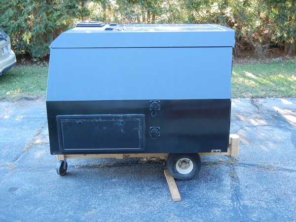

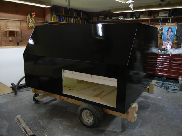

I also have the main body in full primer now. I'll be sanding it out while I am sanding the outside of the top. When both are done I'll do all the outside paint on both parts. It now looks like an odd sized refrigerator setting there. :lol:
I have also painted the bed area. I put the second coat on it today. I didn't get a pic of it yet. I'll get one the next time I take the camera out there.

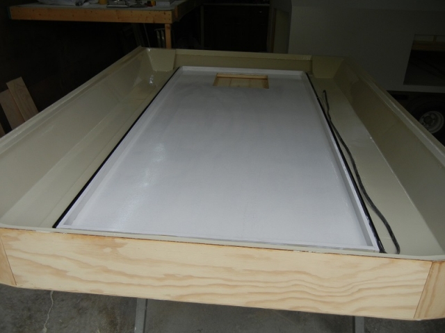

Here is a pic of the finished bed area.

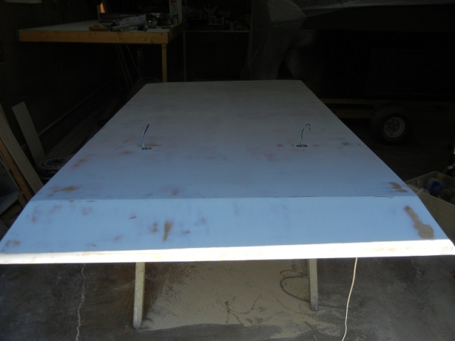

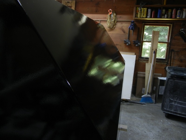

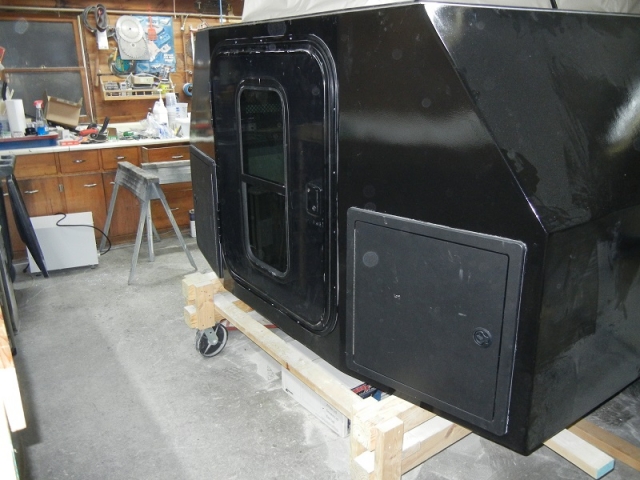

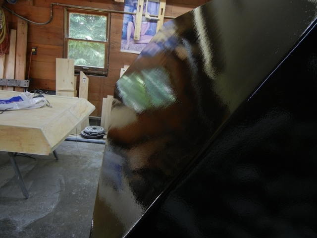

I ran into problems with my epoxy in the high temps we had here early last week. So I didn't get the top finished off. I did get all the primer sanded on the main body. Today I painted the main body.
Now for the members that wondered why I went a long time without posting while I was doing the body work. The work on that warped side wall was something you couldn't get good pic's to show progress. Here are two pic's showing the finished slanted walls. The first pic is the drivers side wall. That one had very little work. The second pic is the passenger side slanted wall. That one had a lot of work that wouldn't have showed till paint was applied.
Just a note here. Do not use Sherwin Williams micro fiber rollers on dark colors of paint. The one I used today left roller lint on all panels I painted today. The paint I used said to use 1/4" nap roller. I couldn't find any local. I found a 3/16" nap roller that was micro fiber. So I gave it a try. Wish I hadn't.

On Monday and some of Tuesday I installed the storage bay doors and the seal for the top.

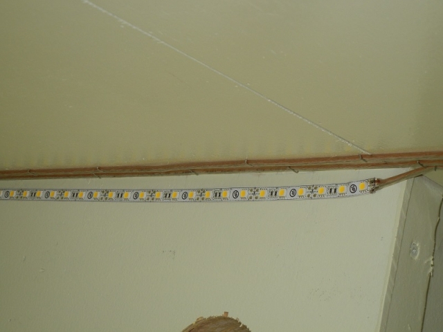

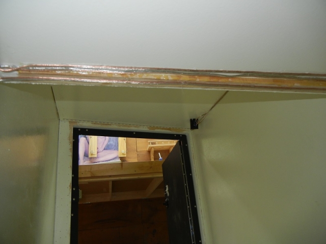

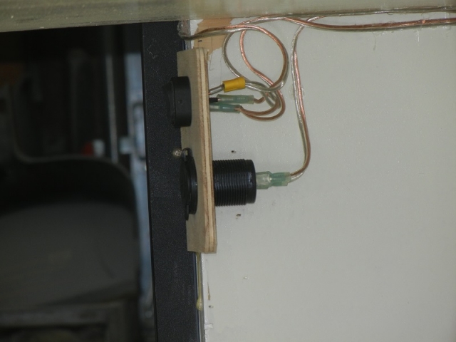

Then I moved into wiring work. The rest of Tuesady and all of yesterday. I was doing wiring and lights in the lower bay area. All four lights for the bays are done. Wiring just needs terminated at the fuse panel. which was not mounted at that time. I also installed a USB plug and a cig lighter plug for the cooler. Here are a few pic's on that wiring. First pic is passenger side switch and USB plug.
This pic is the light strip for the drivers side bay and some of the wring for the right side.
This pic shows the passenger side cooler bay LED strip and switch. The driver side bay is the same setup.

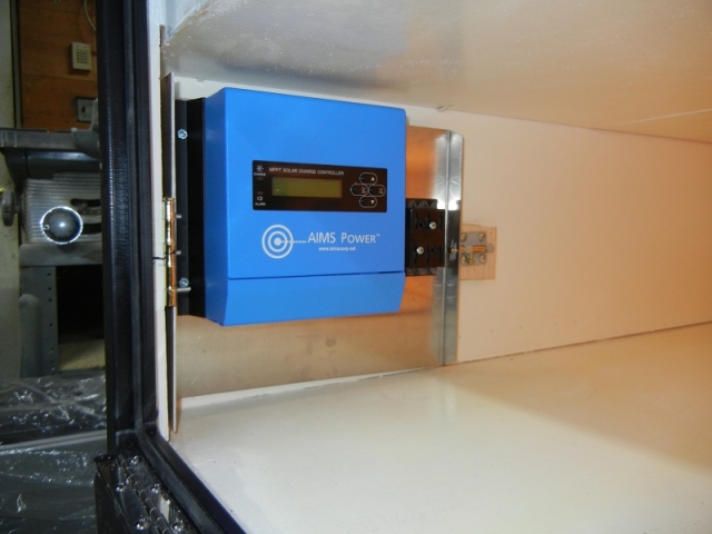

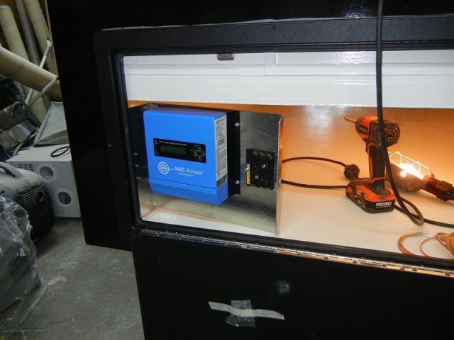

Today I was working on mounting the solar controller and the fuse block. The first pic shows it in the stored position.
This pic shows the controller and fuse block swung out into a workable position. Wasn't even going to make that setup stationary in that small area.

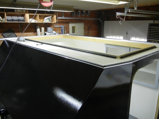

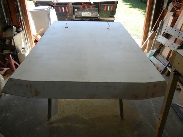

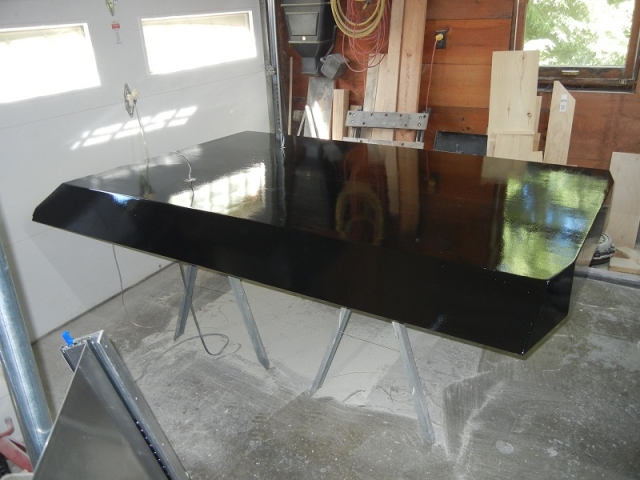

Sorry about not updating sooner. Here are a couple of pic's with the top primer sanded ready for paint.
This next pic shows the top in paint.

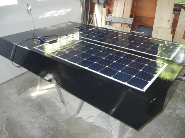

This pic shows the solar panels installed.

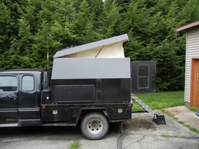

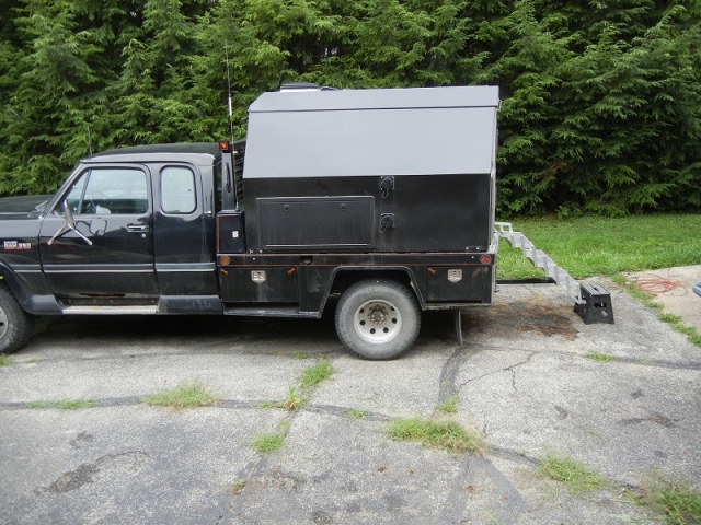

Here are the pic's as promised yesterday. The first one is to top down.
This one it the top up.

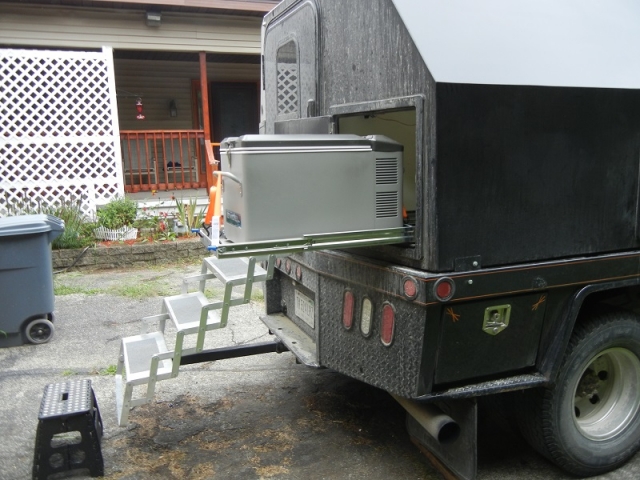

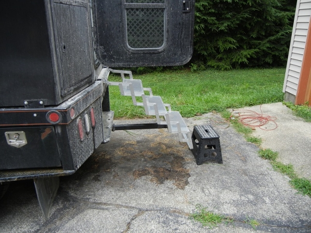

This pic shows the set I am using. The long tube coming out of the class 3 receiver has a cross bar that bolts to it to hold the third step properly. The is no wiggle or give in the steps when walking on them. The support can be taken apart and stored in about a minute. I store it beside the slide out 12 volt cooler. The steps I lay inside the camper in the standing area. The camper is to tall. Need steps just to get in. So storing them in there isn't a problem.

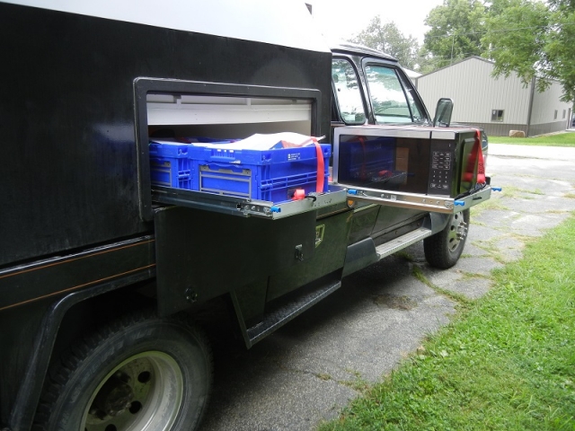

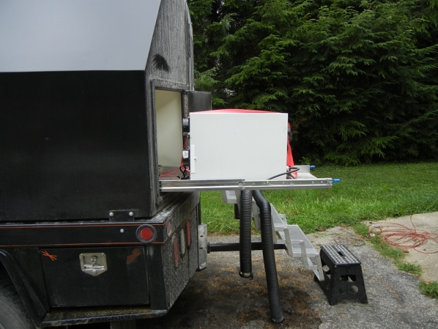

This is the kitchen area. That micro wave was a last minute addition. I will need to redo the slide out pans and make that one wider and narrow the other on. I want the colman stove to be behind the microwave. That will be a winter project.
This is the 12 volt cooler/ freezer we use. Its a Engle MT35. So far it has work good, once we figured out the temp to set to keep milk unfrozen. LOL

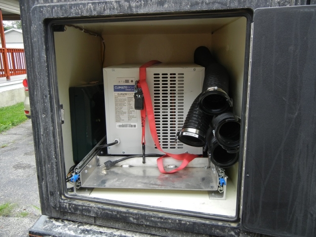

This is the Climate right A/C we have. The bay will store the hoses. Currently have the colman stove tucked away in there after the micro wave was added. After I added the hose adapters to the climate right I lost the space I had planed for the generator. That's why that bay has extra room. We did all camp grounds this trip so no generator wasn't a issue. I'll just figure out some way to get the generator onboard.

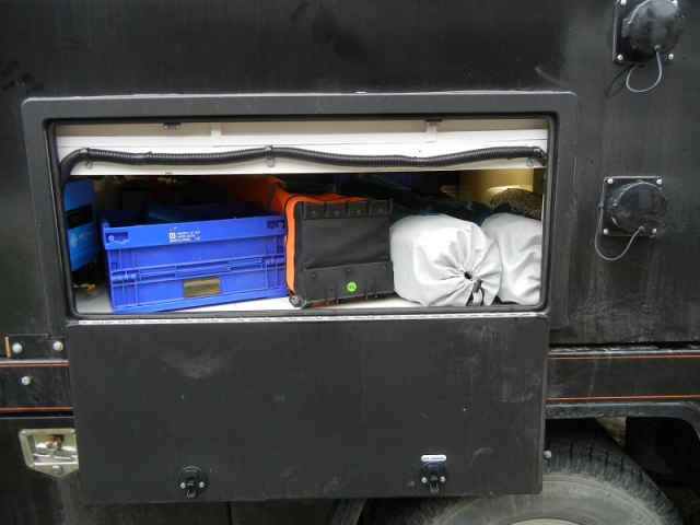

Driver side storage bay. The blue tote is for canopy tie downs, extension cord, propane bottles. There is also a small folding table behind the two chairs.
