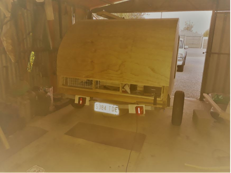

Postby MickinOz » Sat May 09, 2020 5:53 am
The days saw advances.
Like many another, I am sure, the hatch was a real "elephant in the room."
Sorta dreading the day it had to be acknowledged.
Yesterday I assembled the hatch frame.
It wasn't too bad.
I pretty much followed the advice in the Generic Benroy plans - get two frames that exactly fit the hatch opening at each side, cut the top back 1/4 inch, and the bottom 1/8 inch.
Glue and screw to the top and bottom frame rails.
Then insert some more frames inside this.
I was concerned to get it all straight, so I took the assembled frame and while all the glue was still wet, I clamped it into position with spacers.
So the glue set with the frame straight and true in situ,
Today, I cut a piece of ply sightly over length.
I laid it on a table, covered it with a beach towel and poured on lots of hot water.
I left this to absorb water and soften while setting up the staple gun, cleaning all the surfaces to be glued etc.
It went on quite easily. Very easy to get the thing built straight if you clamp it in the place it has to go.
The whole materials choice thing has been a challenge. With pluses and minuses.
The structural ply is nowhere near as nice as marine ply, but 7mm sure does bend around a curve nicely.
That Tech Grip polyurethane is simply the right glue for this job.
I have a small piece to install tomorrow, and then I will be able to hit it with the Mix.
I'm expecting to have the hurricane hinge on it next weekend.
I'm single skinning, at this stage. The lights will not be on the hatch lid, and I only used four ribs in total.
There are no trimmers/noggins between those 4 frames. The 7mm structural ply is its own crossbracing.
I'm very keen to see where I end up weight wise.

Nominal size being 1524mm/60 inches for a queen mattress in Oz, I figured there would have to be a few that were slightly undersized.
I discovered that Fantastic Furniture sells a 6 inch foam mattress that it says is 1510 wide. Woohoo!
In this get-what-you-pay-for world it is rather cheap at $149, but it has plenty of good reviews, so I'm going to get one when I take the wife for a checkup on Friday.
