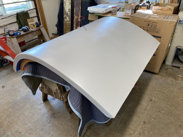

Rolled on two coats of Magnapoxy primer today.

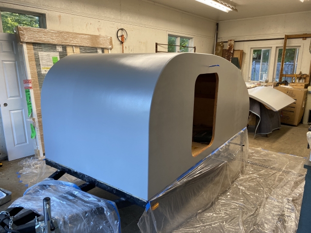

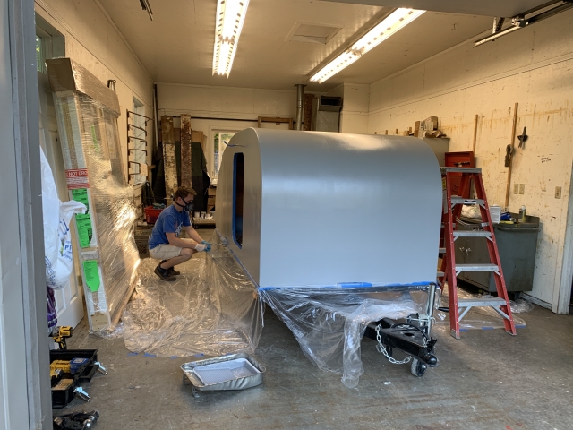

Postby GarthB » Mon Jul 26, 2021 9:33 pm

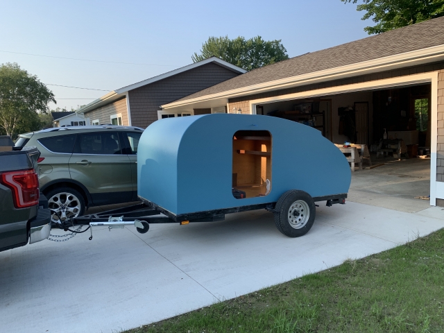

Rolled on two coats of Monstaliner today. We finished the second coat late tonight so we'll show off the color once its rolled out in the natural light. :beer:
Everyone that has mentioned this stuff smelling awful was right. We had neighbors asking us what the horrible smell was.

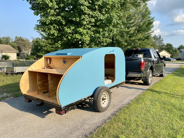

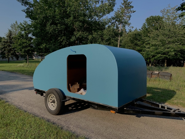

Postby GarthB » Tue Jul 27, 2021 8:30 pm
Nebluya.
I think my wife and I are in a bit of shell shock after seeing it as wood for so long. It's a whole different camper!

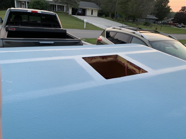

The last several days have been around 90F. We found this interesting as we were working on buttoning up some wiring in the driveway as things were cooling off fast. Condensation directly above all of the insulated areas of the roof:
It'll be interesting to see if it continues to happen throughout the life of the camper once we have the doors and fan installed to seal everything up.

Postby tony.latham » Tue Jul 27, 2021 9:49 pm
Nebluya.
I like her! :thumbsup: :thumbsup:

Postby GarthB » Wed Jul 28, 2021 8:57 pm
Thank you both! Learning how much elbow grease goes into a decent paint job was definitely humbling.
