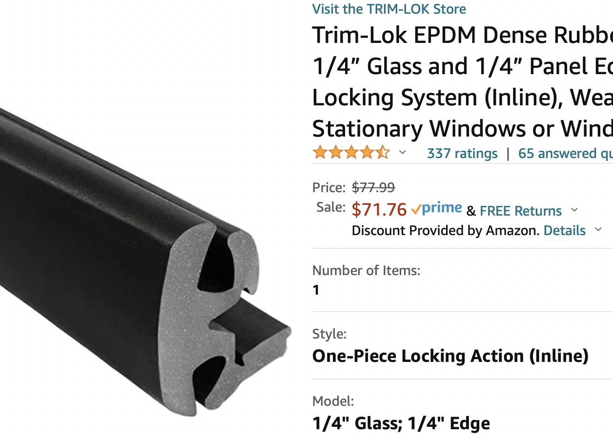

Bama5150 wrote:Very interested in seeing how you tackle the big window.
Bama5150, building the large window is the one part of my build I'm approaching with a bit of trepidation. I "think" I have a plan and how I'm going to go about it. I've been thinking and planning about it for quite a while so I better have it right by this point. I'll be using 1/4 inch polycarbonate (Tuffak AR is the PC which has an abrasion resistant coating and UV protection). I would have rather used glass but that's not going to happen it being such a defined shape which is not something readily found on the shelf. I found a local powder coating vendor who has a large oven. I'll heat up the PC and drape it over a form I'll build which matches the outside radius of the trailer. I'll create a lip using the outer roof sheathing with the aluminum skin on top and use a locking gasket to hold the window in place. I've attached an image of the locking gasket. At least this is my "plan of action".... I'll keep you posted as I get to doing it.

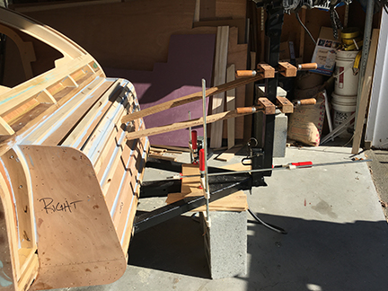

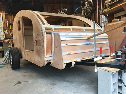

Attached are couple of images of the front end bump out I've been working on. When I installed the inner ceiling panel there was a bit of bow so as I laid in the spars I wanted to kind of push that bow in while the adhesive set, thus the help of the bike rack for something to angle some pushing supports.

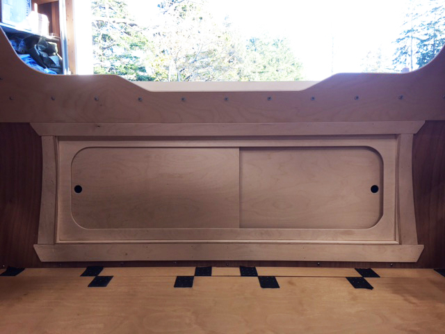

Well today got the interior moldings and sliding doors in place for the front bump out storage area (image attached). I do realize the bed will cover up a lot of the lower moldings but I figure when the bed transforms to the couch position, it will be visible. Tomorrow think I'll tackle the exterior bump out insulation and try wrestling the exterior ply in place for the bump out.
