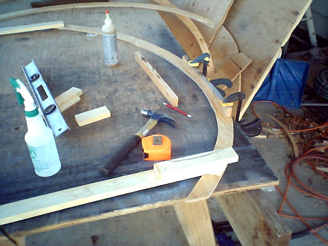

today i worked on the spars again, it seams this build is about spars. i finished gluing and stapling the side spars, when dry i can trim and finish (another day). eight more spars to go (four for the front, and four for the back). but once i get these hooked together (with a third dimension) i think it is safe to skin the sides. the spar that must support the door hinges turned into a challenge.
goals of this spar are
1. must be solid for hinges to attach to.
2. have place to attach wall at bottom.
3. when all done cut top off and yet retain strength.
del

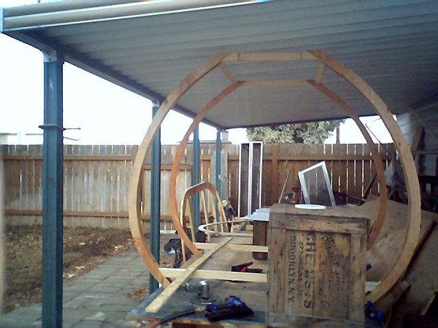

Postby del » Thu Feb 22, 2007 9:40 pm

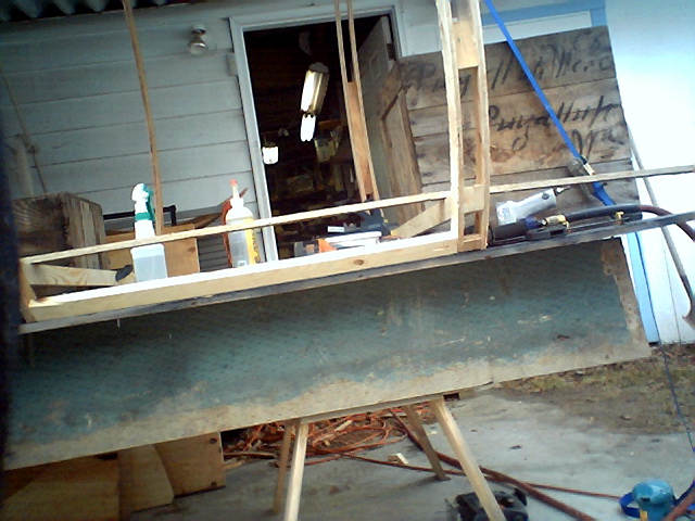

after trimming and sanding the spars, it is time to put two of them together, wow.
i have a three dimensional object on my bench now.
first comes the bottom where the skin will be attached. the bottom supports are glued in, but the top ones will just be put in temp like. pocket screws are great.
this section is where the doors go. next i believe i will skin the door section. if you look at andrews drawings this skin should be 43" long, i will make it 48" (5 of the 11" i will stretch the side). the other mod i am doing here is the door, 30" instead of 28". also i am considering moving the bottom of door down to an inch off the floor. i figure the rounded opening and trying to sit in the door would cause issues.
now for the engineer types my plan is to
1 skin this section
2 doors
3 attach next section support
4 skin
5 add floor (only now will i know how long this will be)
6 frame position (axle), wheel wells
7 supports for the front and skin
8 back hatch and lower section
9 finish work
