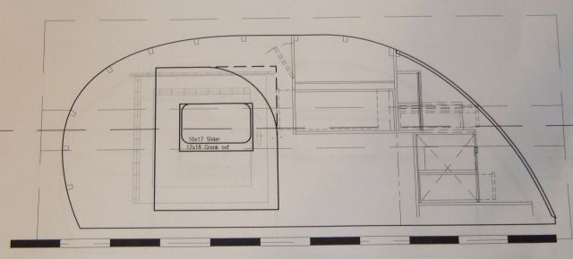

Almost time to start templates.
I have the profile drawn (parts swiped from Angib) and printed in both fun size and full size. Masonite is at the ready.
I think I'm gonna do the rounded door. I swiped that idea from the Generic Benroy. Thanks Mike.

Postby mikeschn » Sun Jun 01, 2008 4:11 am
The profile looks good.

Postby Miriam C. » Sun Jun 01, 2008 8:32 am
Sparksalot wrote:Almost time to start templates.
The profile looks good except for the hump on the rear top. You need to be sure water will run off the top or you will have to deal with "the lake" after you trim it. :oops:

Postby Sparksalot » Sun Jun 01, 2008 10:30 am
Miriam C. wrote:The profile looks good except for the hump on the rear top. You need to be sure water will run off the top or you will have to deal with "the lake" after you trim it. :oops:
I think the camera angle exagerates that. I took a picture, from an angle, of a letter size plot. There is really just a flat area slightly wider than a vent fan when viewed dead on.

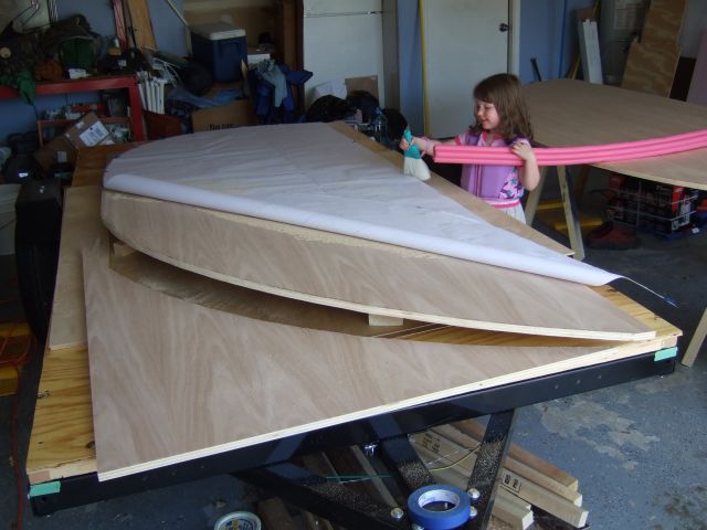

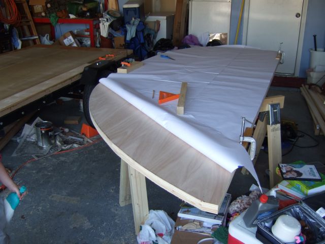

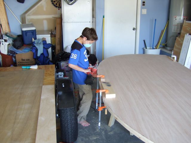

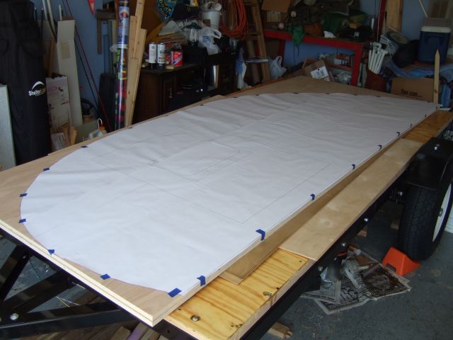

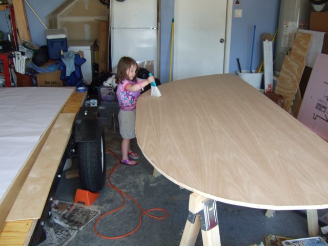

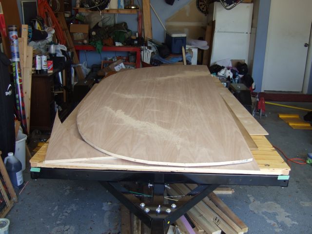

Postby Sparksalot » Sun Jun 15, 2008 5:00 pm
We have visible progress this weekend after a trip to a woodworker spot for some 4x10 red oak plywood.
The full size pattern is unfurled.
The first cuts are finished. Oh Lord, at $130 a sheet, please be good.
The Princess Helper banishes sawdust!
The Working Stiff revs up the belt sander to match the sides. I'm glad I didn't try to cut the sides together, the durn jigsaw blade sure enjoys wandering.
Cross check again the pattern. It's almost time to cut the relief notches for the hatch.

Postby 2bits » Sun Jun 15, 2008 6:44 pm
Nice work! I almost got the Red Oak too. I know I was VERY nervous and procrastinated a little to cut the walls, but once I started cutting, I realized I still was just cutting wood and it was no big deal. I like the profile too, I'll have to come by sometime and trade ideas! Keith in Garland has a similar profile to yours and his is finished up to the face frame stage.
What's the final plan for the exterior? Woody, aluminum or both? I am doing stained wood on the sides and black aluminum on the top.
As far as getting it legal, I think that's a personal preference on how closely you want to follow the letter of the law. Personally, I will be getting trailer tags and just running them.
Oh, I like the name too, creative and logical!
Thomas

Postby 2bits » Wed Jun 18, 2008 11:11 pm
I mulled over this for a while when I was doing it... :?
Then I remembered you need a 1/4" gap between the door and the side wall anyway so you don't have to be perfectly exact along just one line. I used a plunge cut with the jigsaw to cut the door out first on the outer dimension, then the second cut was to trim the door to the inner dimension and belt sanded it where I wanted it. Hope this helps.
