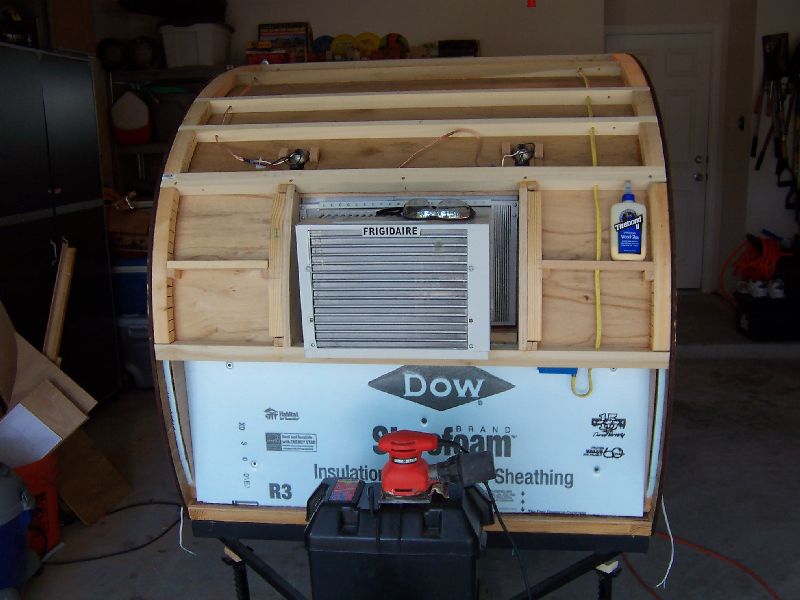

Postby chorizon » Tue Sep 22, 2009 5:24 pm
Time for an update...
I've made some good progress since my last update, and I have the pics to prove it! :lol:

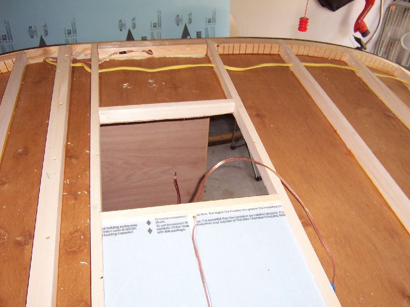

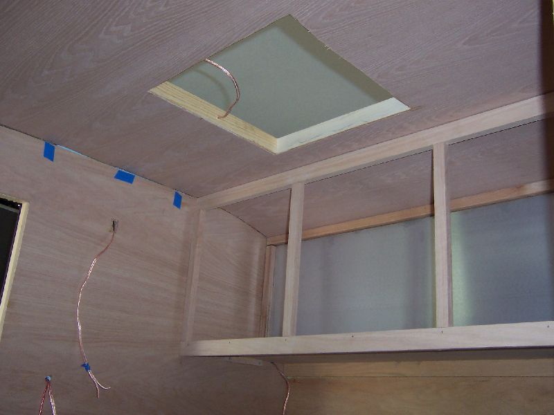

I got my ceiling in, it is 1/8" Oak like the walls.

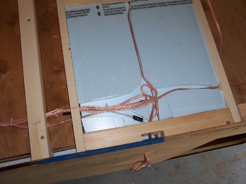

Have finished my wiring runs...

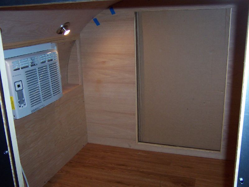

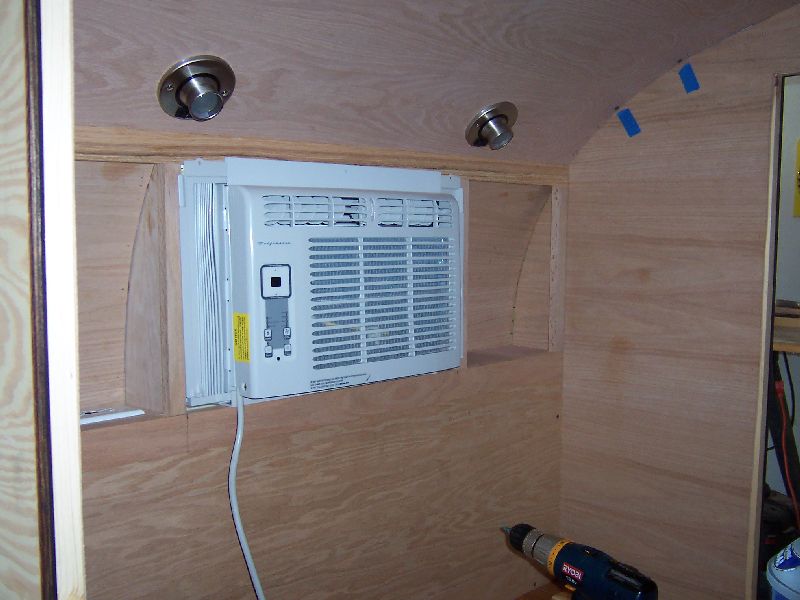

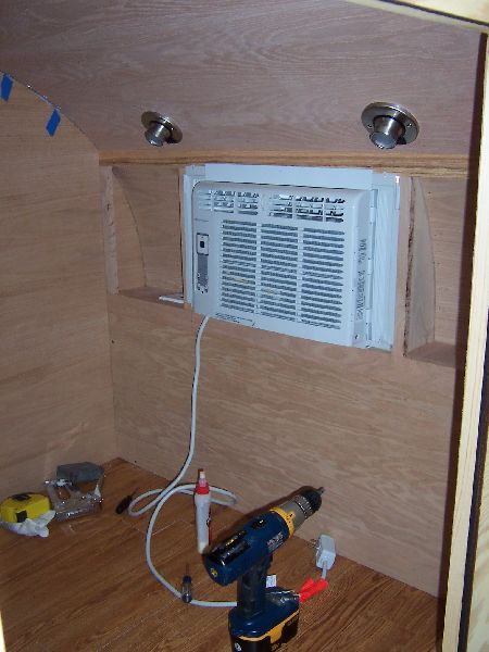

I installed the "life-support system" aka the A/C, and the front bulkhead.

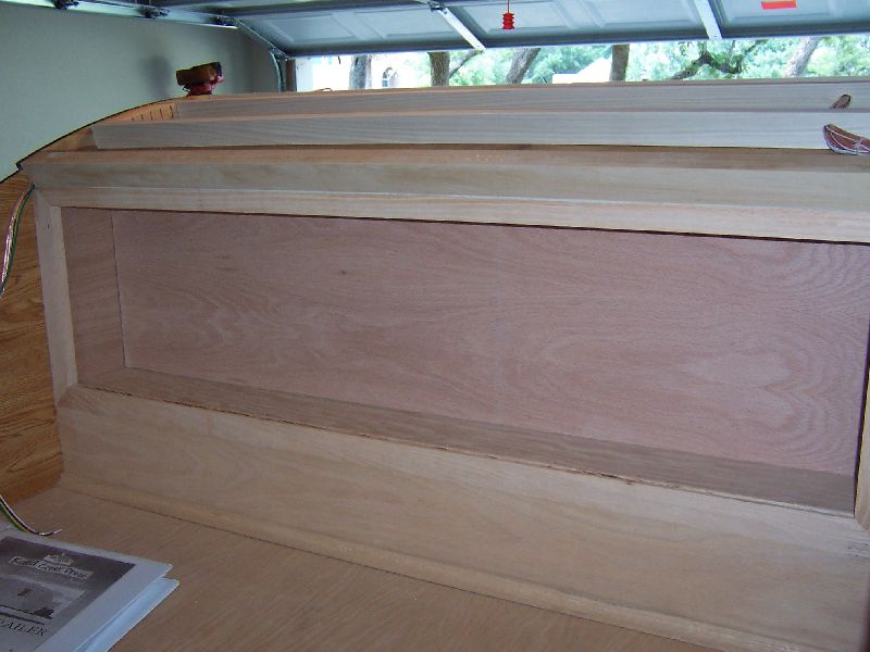

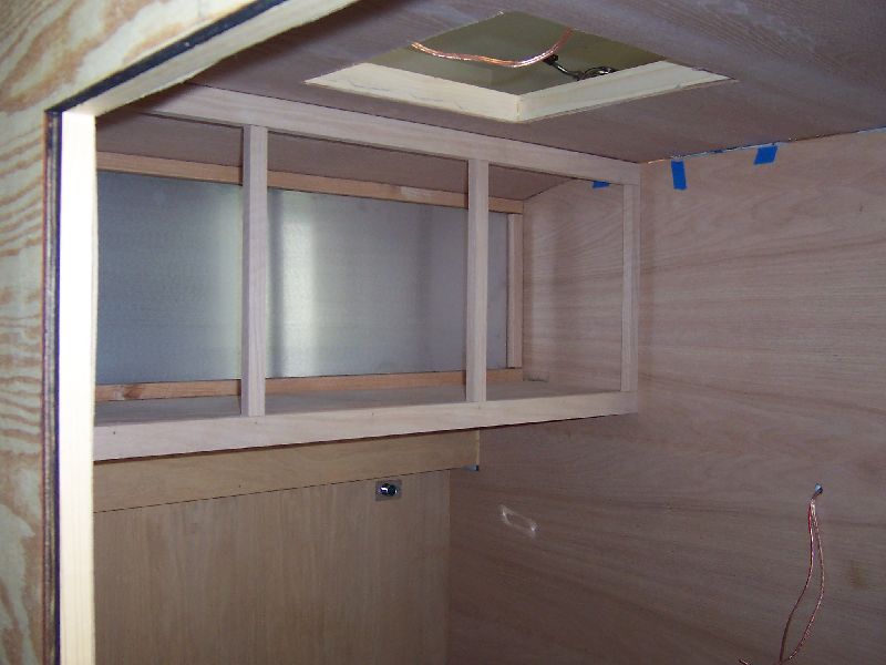

I installed the rear cabinet and finished the galley pantry in one fell swoop! Yes, that's the Kuffel Creek Comet plans there in the last pic, although there have been quite a few revisions and deviations!

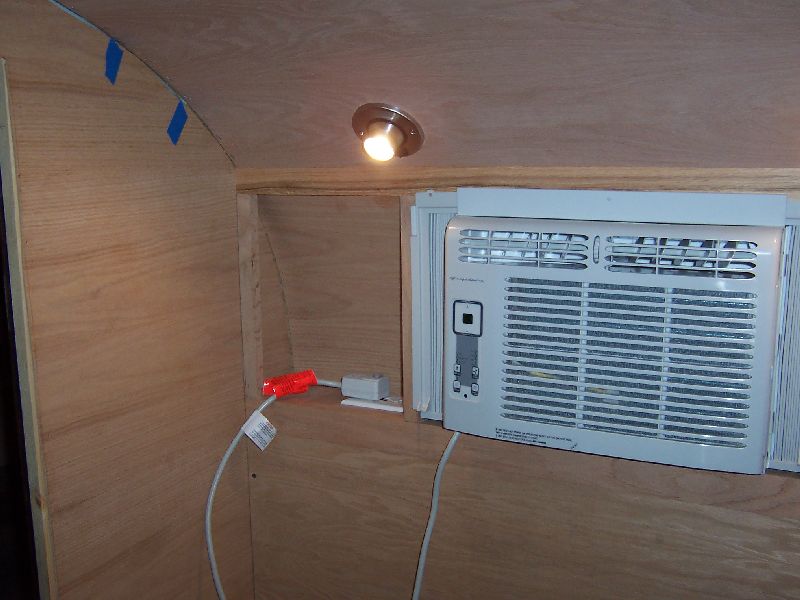

The A/C is on and its blowing COLD! This is starting to feel like a real trailer! I covered up the doors with cardboard and climbed in. This is starting to pay off!

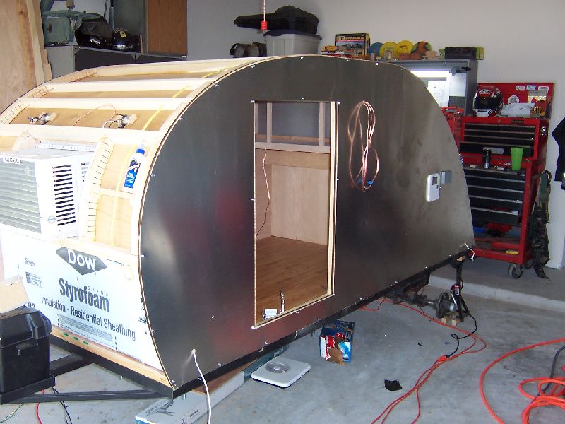

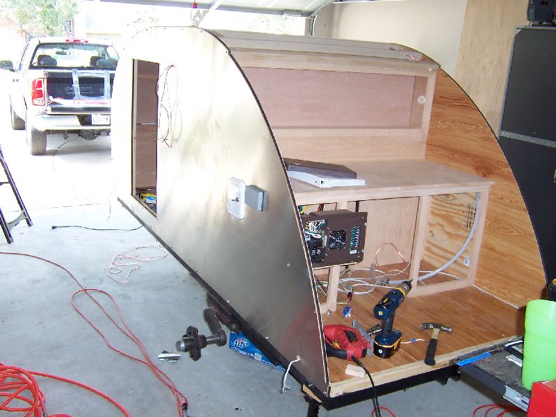

I installed the aluminum on one side. Its being held in place by screws temporarily until I get the trim on. The cutout for the water inlet was not fun. More later!

Postby 2bits » Tue Sep 22, 2009 7:54 pm
Oh yeah you made some good progress alright! I think the height of your AC is in a good place and I like those lights! ! What are you gonna use to cover the AC Box on the outside when on the road?

Postby Dean_A » Tue Sep 22, 2009 8:19 pm
Looks like it's really coming along! You might want to double check the location of the screw holes for your roof vent/fan. I know on some models (i.e. Fantastic Fans) the single roof spar isn't wide enough to screw into. I had to add some blocking around my fan opening.

Postby chorizon » Tue Sep 22, 2009 8:25 pm
2bits wrote:Oh yeah you made some good progress alright! I think the height of your AC is in a good place and I like those lights! ! What are you gonna use to cover the AC Box on the outside when on the road?
Thanks, Thomas! My building spirit was really boosted when we went to the Guadalupe Adventure last month.
The AC found its spot on its own. That was the only place it seemed to fit, and we had to have it (it is, after all, life-support during the summer-time!).
As far as covering the AC up, that is a good question! I've read the horror stories before about mounting the AC to the front, but I'm probably the first (not!) person to think they have figured out a way to do it with no leaks.
I plan on building a box out of Al sheet-metal around the AC and sealing the opening the best that I know how (flanged with weatherstripping). If that doesn't work...we'll deal with it "as the need arises".

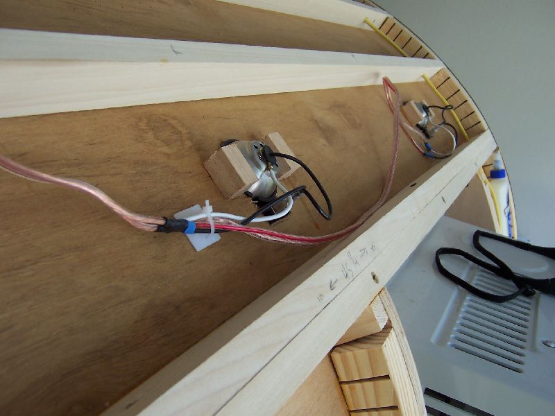

I really like the lights. They were less than $10 apiece from a local RV parts supplier (I finally found one!), and I can replace the bulbs when I get the $$$ for some LEDs.
Another word about the lights...they were the first thing I installed in my trailer that was wired-up permanently. They worked! That was really cool!
I dig your trailer alot and am glad you had a great weekend at Joe Pool, The TV is sweet, I've always wanted a cool Chevy pickup with a V-8!

Postby chorizon » Tue Sep 22, 2009 8:32 pm
Dean_A wrote:Looks like it's really coming along! You might want to double check the location of the screw holes for your roof vent/fan. I know on some models (i.e. Fantastic Fans) the single roof spar isn't wide enough to screw into. I had to add some blocking around my fan opening.
Thanks, Dean, I'll watch for that. It seems like I've had OCD throughout every step on this build, but I think I've been pretty lucky when I actually end the planning stage (90%) and enter the building stage (5%) and "just do it" and everything just seems to work out...and work out pretty well.

Postby 2bits » Tue Sep 22, 2009 9:16 pm
Hey Joshua,
I second Dean's note about the roof vent, I had to double up my framing for it too, but it was no biggie, just test fit it and see where the screw holes land.
Thanks for the compliment on the truck, I have always owned some kind of cool vehicle, but I am smart too... I treat the truck with the same attitude I did the teardrop, I want to USE it! I have so many friends with these cool hot rods they can't afford to drive! Well, I wanted to travel in style but not break the bank and since I've never really been a hot rodder and I always tend to do things a little off the beaten path (hence the teardrop too!) I actually pulled the V-8 out and installed an inline 6 cylinder. It is a higher horsepower Mercruiser boat engine actually, but they use the same block as a regular Chevy 250 so it bolted in fine. Just trying to think for myself! ;)
