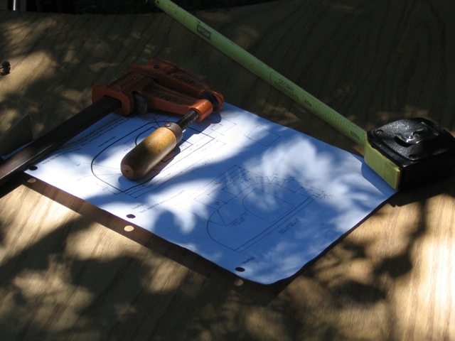

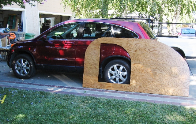

As promised, last weekend we cut out the template for the side profile out of masonite; recessed the bolts on the floor and got it bolted down.
Then we ordered and picked up a couple pieces of A1 one piece face red oak for the sides.
Leo started practicing with his new router...but was just a smidge hesitant to tear into the sides without a little practice (it wasn't pretty!). But this afternoon we got busy...
First he rough cut each side profile to about 1/4" from the edge with the jigsaw...

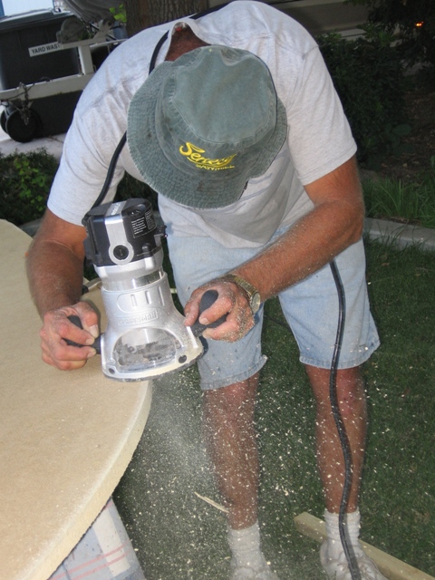

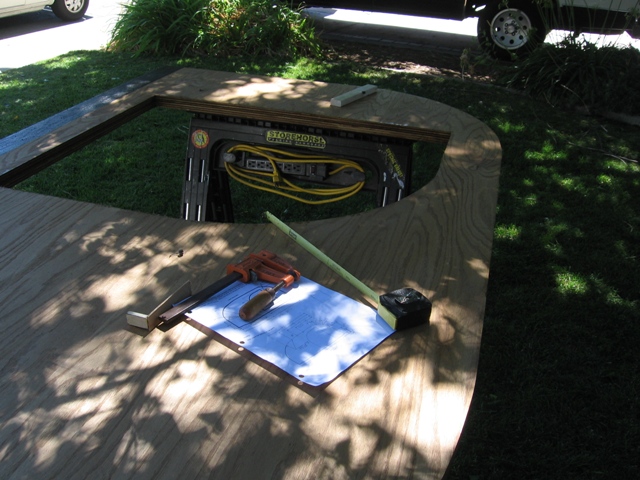

Then he got busy makin' some sawdust!! Clamped the template on the top and used the router with a top bearing flush trim bit (aargh aargh aargh!) He was quite pleased with the result!

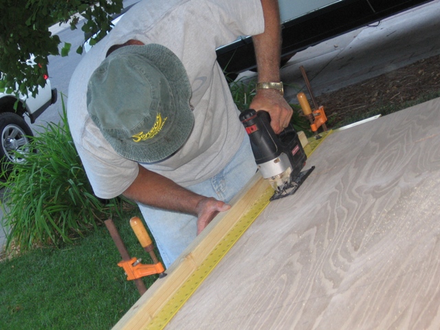

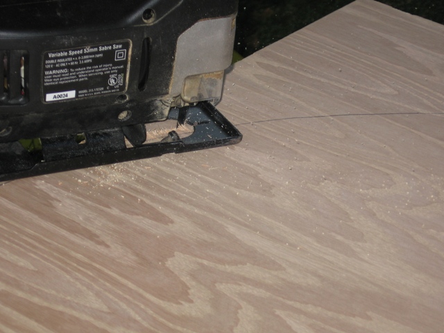

Finally, he cut the doors out using the jigsaw with a guide clamped on for the straight edges...hate those plunge cuts though! For future reference anybody got any advice on those?
So now we have sides!! Question? We're following the Gen Ben plans but plan a woody with a tin top. Should we adjust the depth of the notch we cut in the profile for the hatch or not?

:thumbsup: :applause: Great progress Cathy. You will need to read the can for the cure of the epoxy. Some are different. On the hatch gap---see if it fits first. I hesitate to cut too much. With a router you can always come back and trim it to fit.
I never plunge cut anything. I drill inside (or outside if keeping the inside) Or on the line, with a small drill bit. A few small holes will ease the jig saw in.
Postby planovet » Tue Aug 26, 2008 10:05 am
I cut my doors out with a circular saw using a plunge cut. Worked great, all you need is a steady hand. Much smoother than using a jigsaw, IMHO.

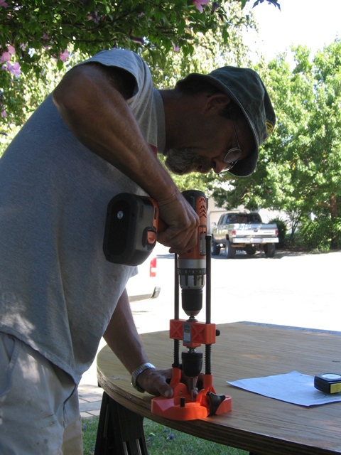

So we set up on the lawn, in the shade, where despite the gusty winds it was rather pleasant...and marked out our spar locations for predrilling. We used a little wooden guide to trace the spar locations and then used same for drilling guide holes on the spars. I think we stole the idea from tinksdad...
GEN BEN PLans ROCK!!
Drilling both sides at once

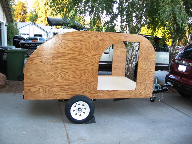

Postby cdfnchico » Mon Sep 08, 2008 12:05 am

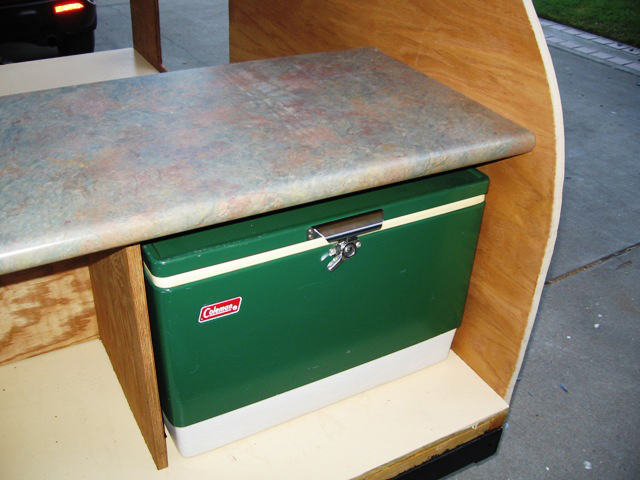

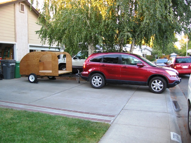

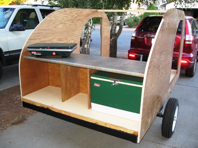

Spent yesterday cutting out and assembling the pieces for the galley and cabinet. We decided to modify the GenBen plans a smidge so we could store our cooler.

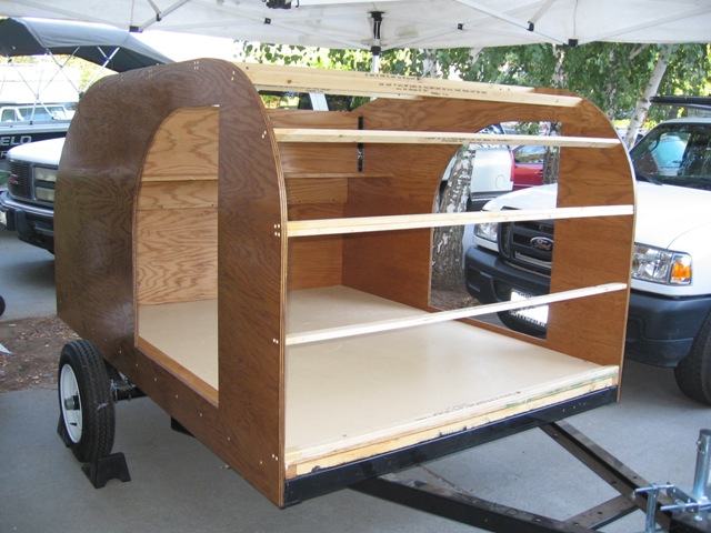

Today we got the sides on for the first time...woohoo!!
Likin' the wood sides!!
Framed up the galley and dry fit...was able to make use of a countertop that we salvaged from the school I worked at and all our kids attended. They closed it a few years ago and this counter was in the trash. We hauled it out and have had it in the garage since. It added a little weight, but looks good and makes us feel good when we see it!
The top part of the cabinet will set in. We are going to pull it out and Deft all of it this week and try to get it reassembled next weekend. Got a SST camping trip with the Jr High Youth the following weekend so....gotta keep movin'!
It's starting to look like a tear!
Cathy

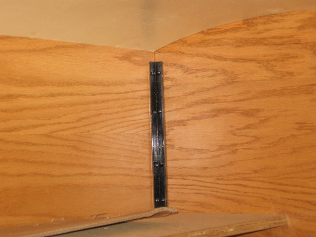

It's been a couple weeks and it's time for an update. We finished installing the galley and bulkhead a few weekends back. Decided to use angle to anchor it and make it "removable" or perhaps "editable" down the road.

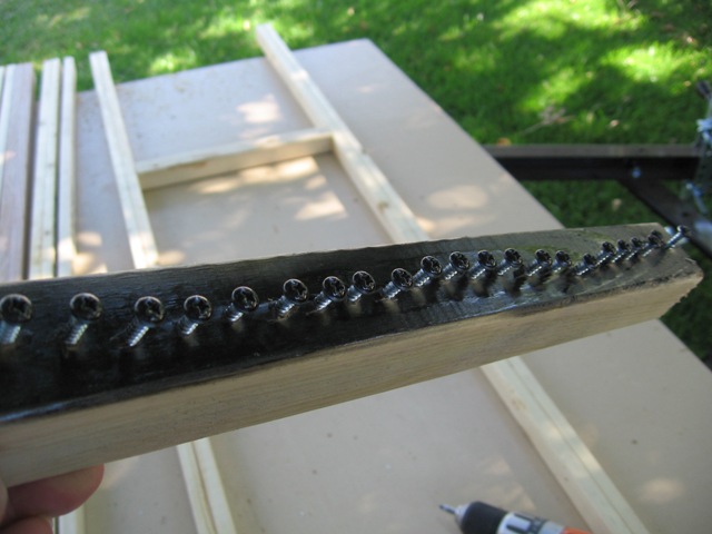

Leo got clever when it came to painting the screw heads....
Got a little help from "Wooly"...
We used a template and predrilled the spars. We then dipped each end in CPES.
Some of the spars had twisted a smidge, but we were able to muscle them into place. We did a double spar up front, anticipating placing diamond plate.

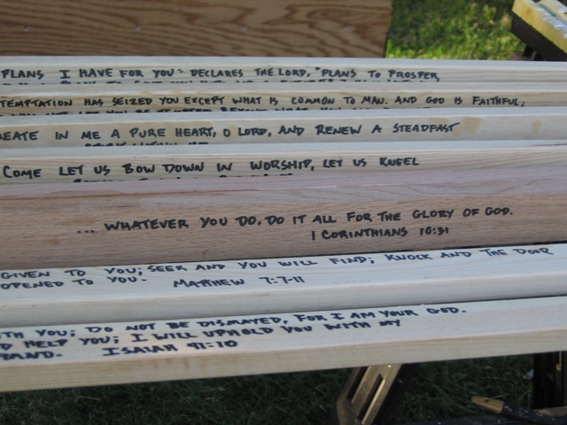

A Side Note
Postby cdfnchico » Mon Oct 06, 2008 1:25 am
Aaron Rodgers, Green Bay QB, is a hometown boy. He's building a house here in Chico for his folks and Leo had a chance to cruise through it. They had placed bible verses on headers throughout the house; they'll be hidden when finished but will be surrounding them nonetheless. We thought that was sort of cool...and decided to add some to our spars...
