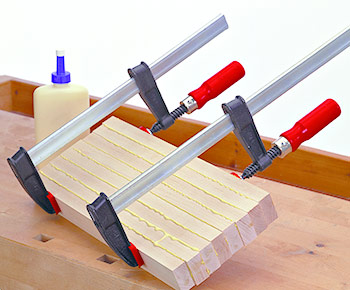

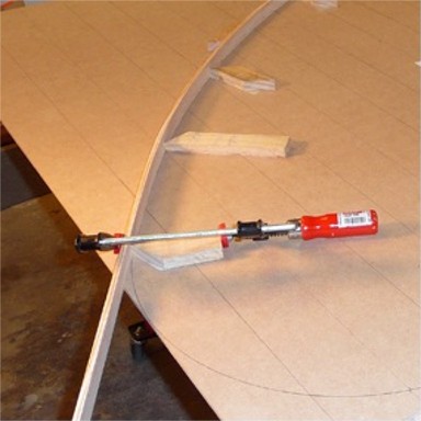

Juneaudave wrote:Fergittin all the grief we've given you...what's this clamp thingy (my ignorance) I haven't seen one and it sure looks useful... :oops: :oops:
It's just a regular ole Bessey bar clamp. There's a better picture of a couple of them below. To layout the curve of the teardrop profile, I stuck wood blocking to plywood with double-stick carpet tape. Then I curved the batten around to the blocking and held it to the blocking with the clamp. Once I was happy with the curve, I traced a line along the batten.

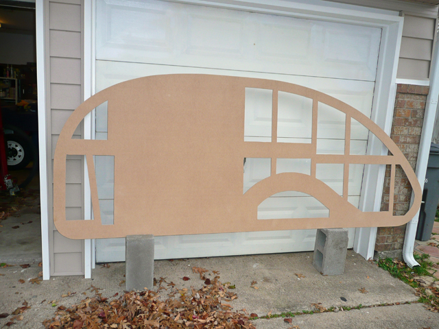

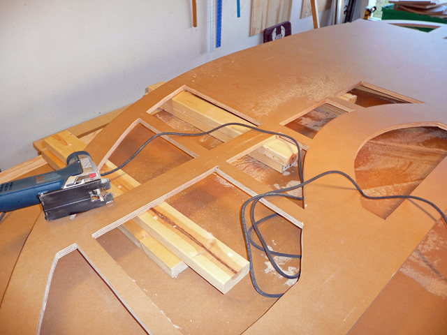

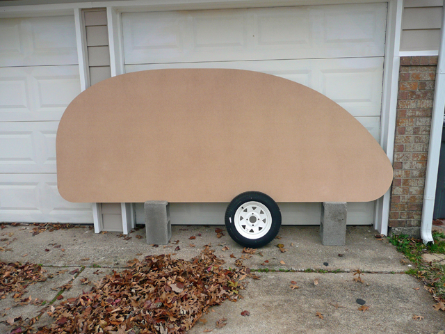

:D Finally got around to making sawdust. Here's the template for the profile:
And here it is with some holes in it:
:worship: Aargh! Now time to cut the door opening. I hope my jury-rigged router/compass creation works:
So far so good.

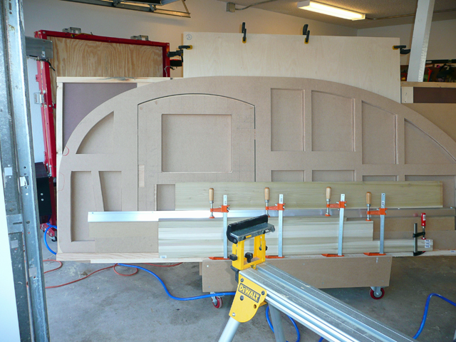

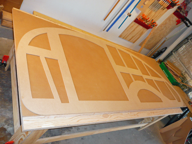

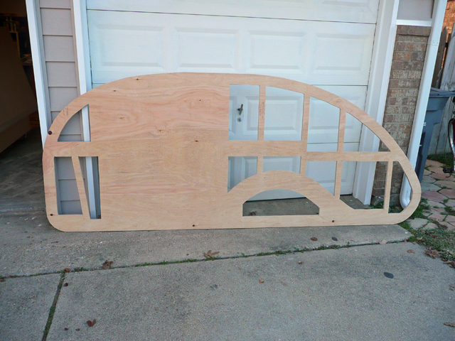

:applause: Had some garage time today. For the most part, I am using Grant's plywood wall construction method. The only difference is that I am using a 1/4" mdf template for layout and final fitting. Here is a piece of plywood (actually it is 3/4" mdo) with the template on top. Next step is to trace the profile and "lightening holes."
The outside profile is cut and now onto making plywood swiss cheese.
One down, one more to go.

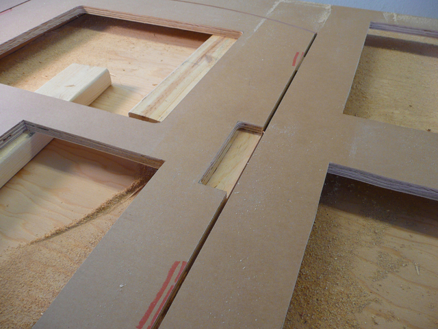

Door openings were routed in the plywood wall framing and "mortises" routed for mortise locksets. (The mortise will be formed by the interior wall skin.)

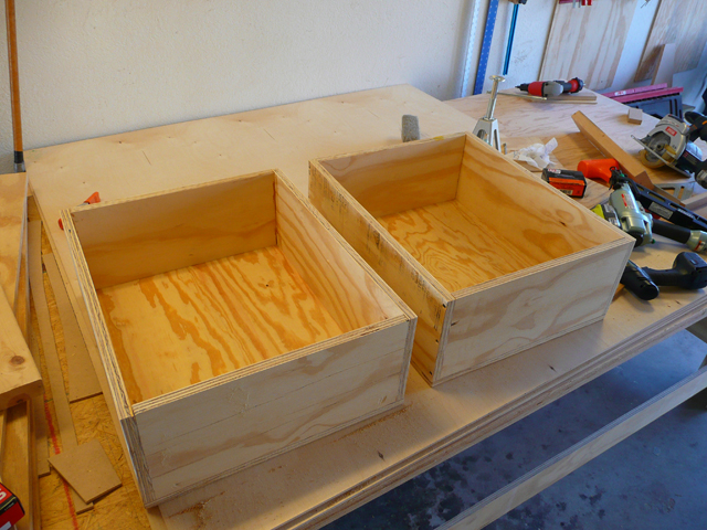

I then constructed some boxes for in-floor storage. (And now know why many say don't bother - a whole lot of work for not much storage.)

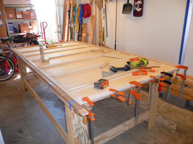

Next on the list was to cut the framing for the insulated floor. I didn't get the floor built as I had planned, but everything is sitting on the plywood cart ready for assembly hopefully next weekend.

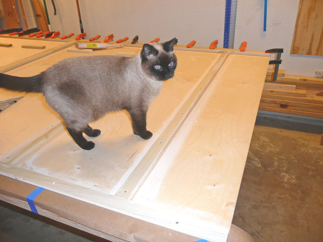

It seems like I only get in the garage every other weekend. After wasting time building floor storage boxes, I nixed that idea and started on the floor.
The intial framing passes inspection.
Framing finished.
Insulating the voids.
:thumbsup: Gig'em, Tom
