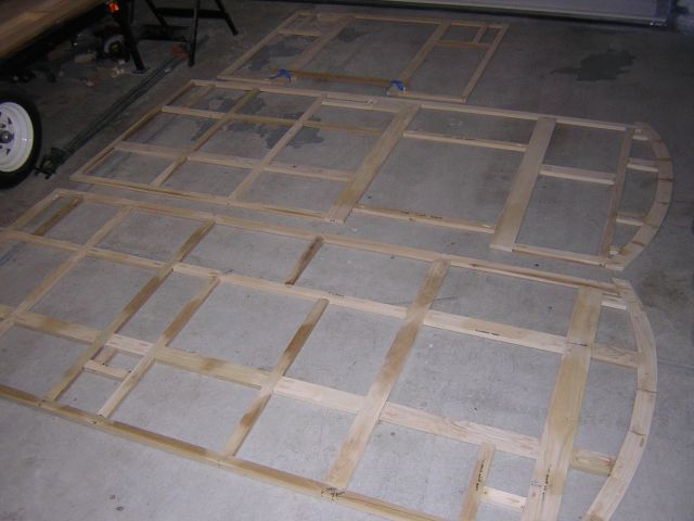

I have managed to make some progress. The sides and back are framed and the stationary roof frame just needs a few more screws. The two long sides have been glued and sanded and are ready for plywood skins.
I can use my trailer frame to play hopscotch and I don’t even need chalk!
I got a little carried away and used more wood than I needed. I think I’m going to be over my estimate by about 20 pounds and will try to find ways to trim that out of the final total. It’s kind of like trying to keep one’s own weight down. I find myself saying, “Oh, that little bit won’t hurt!” Ha!

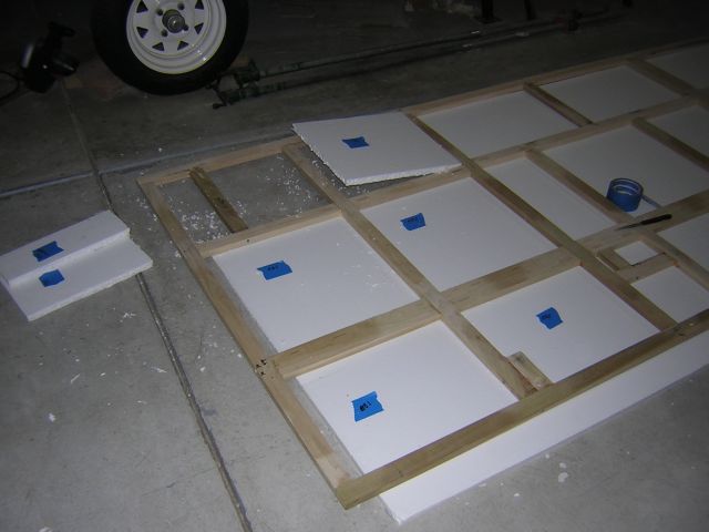

The Styrofoam for one long side is cut and labeled, ready to be applied. I don’t know if anyone has tried this method before. I cut the Styrofoam pieces, using the frame as my pattern, and labeling placement for each piece with removable tape.

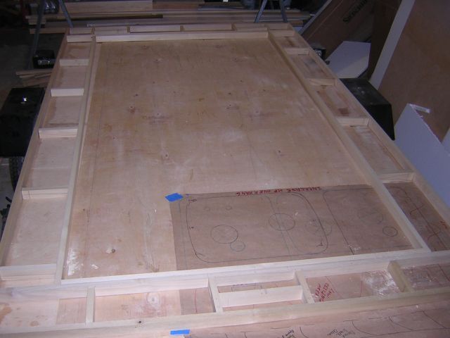

The tolerances on this trailer are tight; so, I'm being very careful and methodical about the framing, etc. Even though I draw full-sized patterns for guidance, I get out the actual window, light, stove, water/electrical inlet boxes and check them as I frame. It should all pay off in the end; but, there will probably be something I'll miss....
