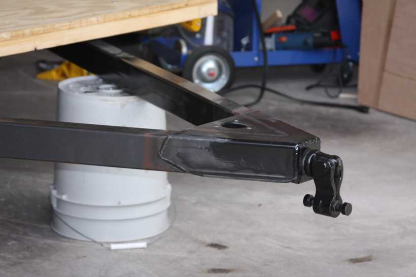

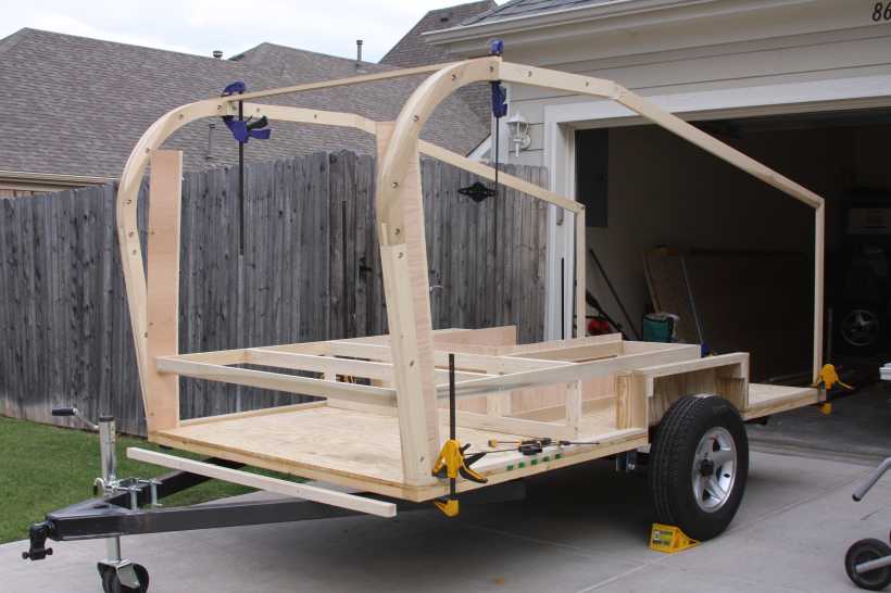

I finally got around to welding on my LockNRoll hitch this weekend. This should have been a quick job but I ran out of welding wire and had to make a run to Lowes to buy more.

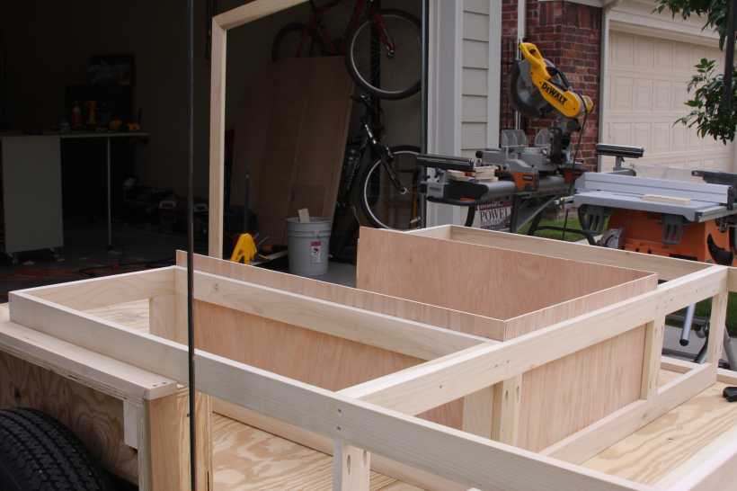

I also got the bed/dinette framing mostly complete. I had to do a fit so my wife snaped a few pictures. There is a little more work to do but its coming along nicely.

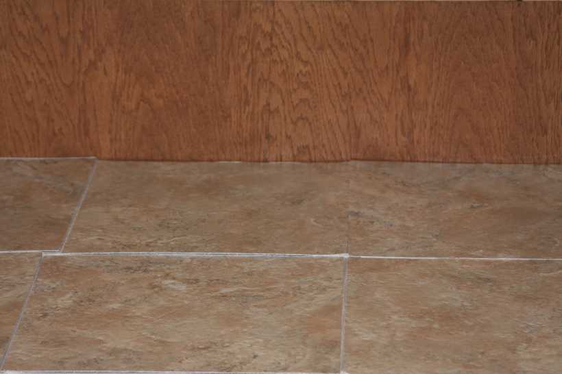

My wife picked out some stain and flooring. This will probably look better than the spray paint and duct tape interior I would end up with......

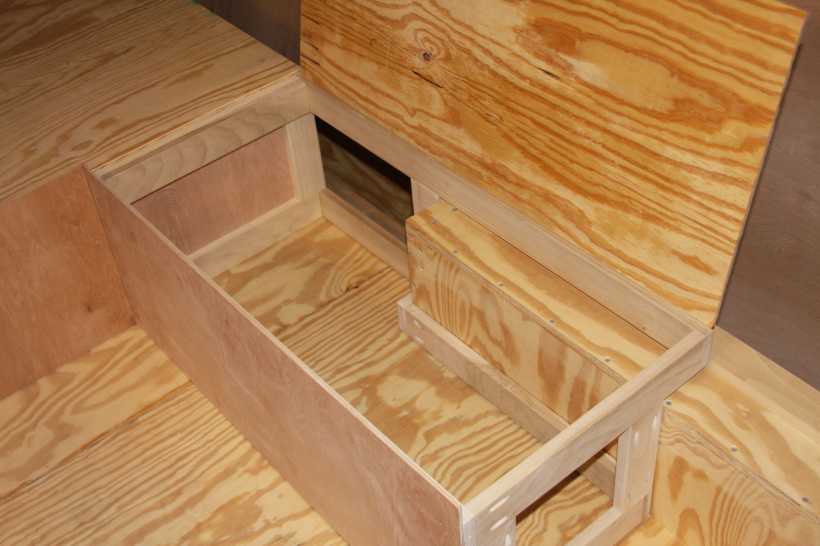

Postby wlivesey » Mon May 25, 2009 9:46 pm
Here are a couple more pictures of the completed bed/dinette assembly. Even though its a small dinette, it's surprisingly comfortable.

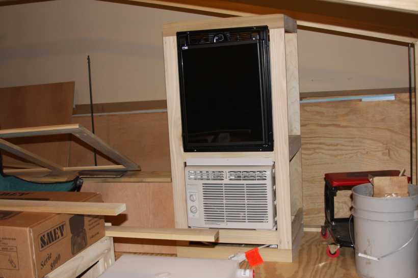

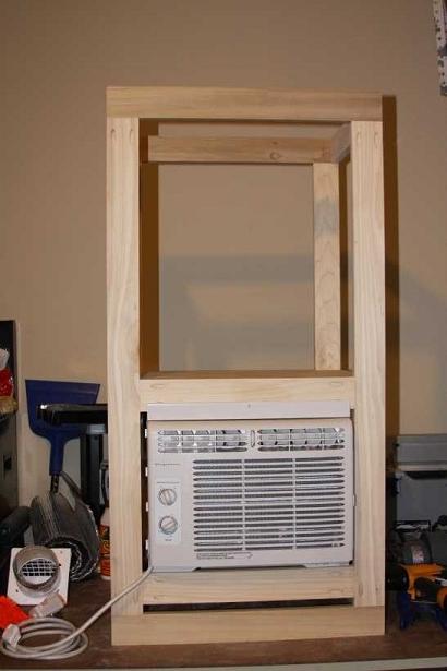

Things have been going slowly since my last post. I've managed to frame up my closet/ac box. I'm thinking about installing a small microwave at the top with a drawer underneath.

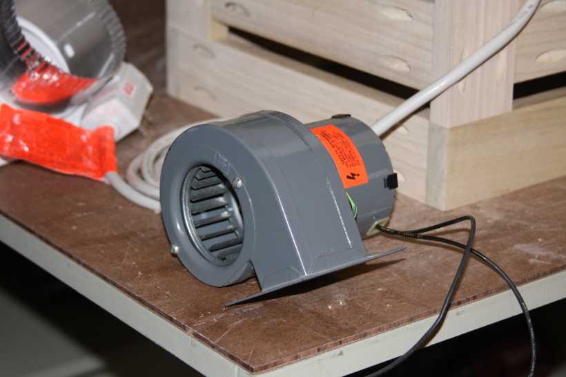

My dad gave me this nice little blower that should do a great job as an exhaust fan for the AC.

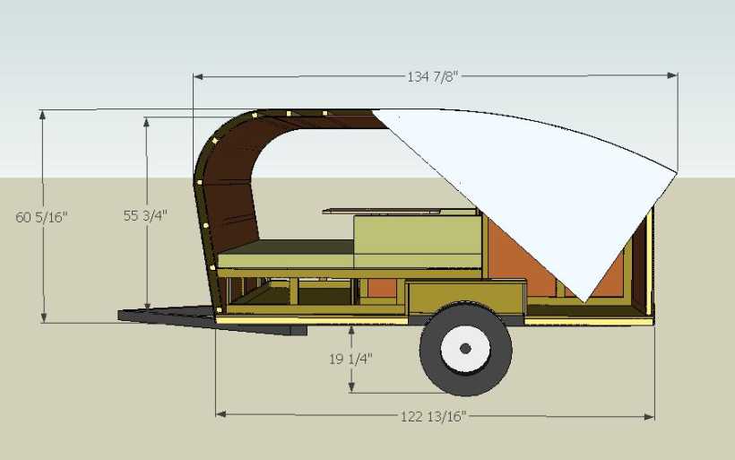

Hey Bill, you're coming along nicely - any specs on height, width, etc?

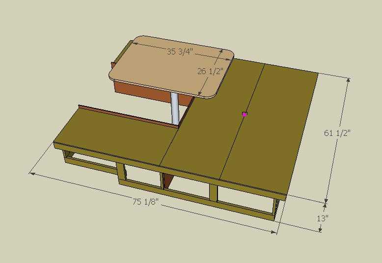

Postby wlivesey » Tue Jun 02, 2009 7:17 am
starleen2 wrote:Hey Bill, you're coming along nicely - any specs on height, width, etc?
You're always welcome for a trip to Mt. Pleasant for a peak and conversation about the build and maybe a fiberglass lesson or two ;)
Be careful - I just might take you up on that invitation... :)
Here are the specs according to my plans. The actual build is coming out very close to what you see here.
The bed/dinette area is big enough for an RV Queen mattress. That was a key design consideration for me.

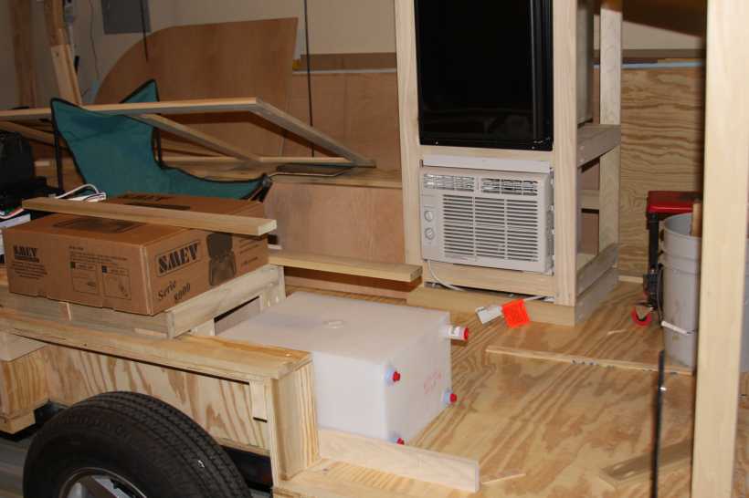

Refrigerator & water tank
Postby wlivesey » Thu Jun 04, 2009 9:31 pm
I decided to go with a Norcold 12Volt refrigerator. It's very compact and doesn't use much power. It's also easier to install since there are no ventilation concerns as with LP refrigerators.
Originally, I planned to mount the refrigerator beneath the galley, but I like this arrangement better. It move all the weight closer to the axel.
I also picked up a 10 gallon water tank that will be place just behind the axel and across from the refrigerator and AC.

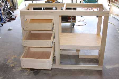

We got to work on the kitchen this weekend. We got it all framed out and built drawers too. It was tons of work!
We used heavy duty drawer slides. This thing should last a life time...
Even though it was a lot of work, building the drawers was easier than I thought it would be.

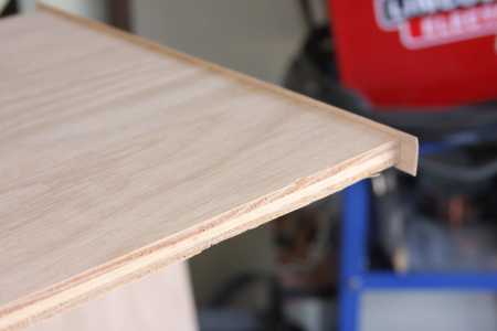

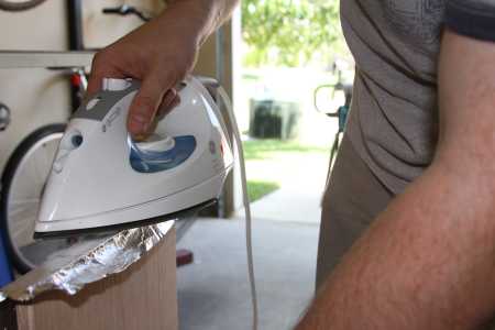

It seems like the kitchen will never end! We've only been working on it for 8 days but it seems like an eternity compared to the progress we've made elsewhere. Though it's taking some time, we really like how it's turning out...
The drawer faces and cabinet doors are made out of 1/2 in Oak plywood. We used Bandit iron on Oak veneer to hide the ugly plywood edge. It was really easy to iron on and looks perfect after it's trimmed and sanded. I couldn't be happier with the results.
We used a little foil to keep our iron clean.
I trimmed the end off with scissors and filed it smooth. I used the Bandit trim tool to trim the length of the veneer.
We decided to go with a modern look. I like it!
