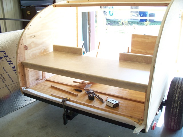

I started on the galley last weekend. I picked up a section of counter top at Lowe's and cut the width to size. It is 24" deep, but I won't be using all this surface for counter top. I'll need room for other appliances and cabinets.
The cut-out in the center will house the Fridge, which will be set back a bit.

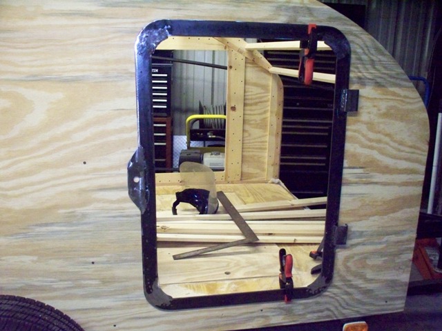

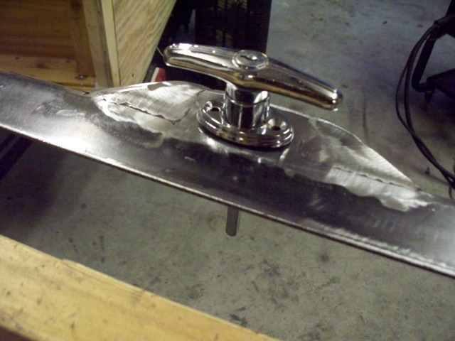

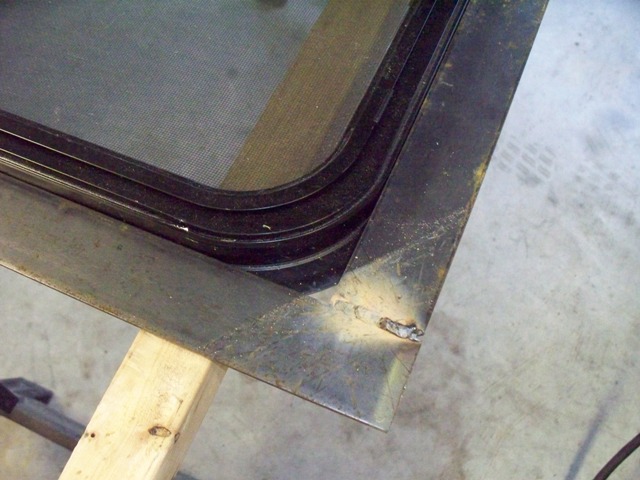

I also started on the door framing. I used 1/8" X 2" flat bar, welded and contoured the corners.
Below is a test fit. Door latch and hinge mounts welded on.
Still not sure if I'm going to go with this door latch or the flush mount as in the bottom photo.
I sent an inquiry to Eberhard to find out where I could buy these latches. The nice lady shipped me a pair; free of charge. I was surprised as the sell for well over $50 each. Thanks Lea.
If I end up using these, I'll have to widen the latch side of the door frame.

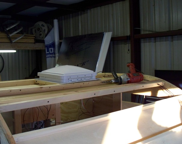

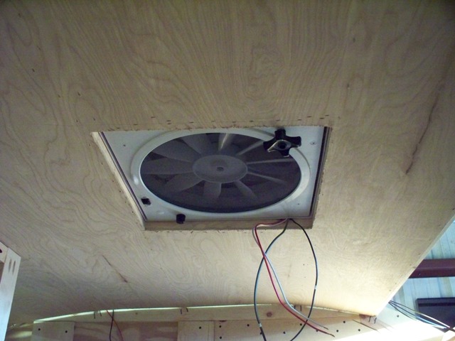

Installed a section of ceiling and rough fitted the Fantastic Fan. Also started running some of the wiring.
I scraped the original door idea and went with something different. I got a good deal on two door from ebay. The doors are a bit larger than the original opining, so I'll have to make a slight modification. No big deal at this point, 'cause I haven't yet installed the insulation board and inner walls.
