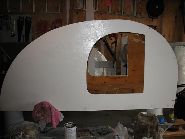

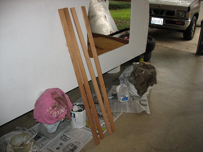

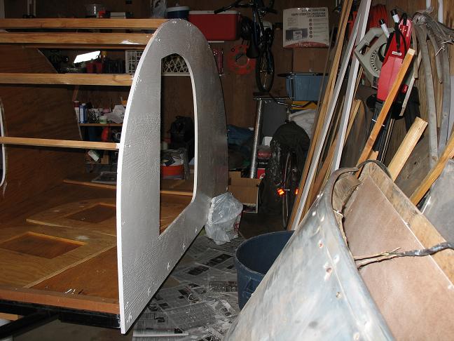

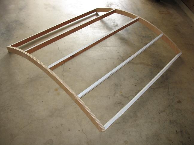

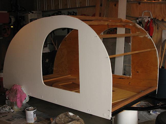

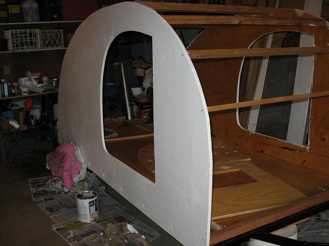

I did a little more work the past few days and painted up the sides with oil based paint to thoroughly seal the wood. A friend gave me some mahogany wood that I will be using for the spars. I will need to replace the pine spars I had already installed though. No problem as my measurement was a little off for the top and front. Needed to be exactly at 48" to use the old aluminum so I was needing to cut my spars down anyway. Glad I wasn't fully complete with the interior roof and exterior roof yet. :lol:
Here are the pics:
Spars
Side 4
Side 3
Side 2
Side 1

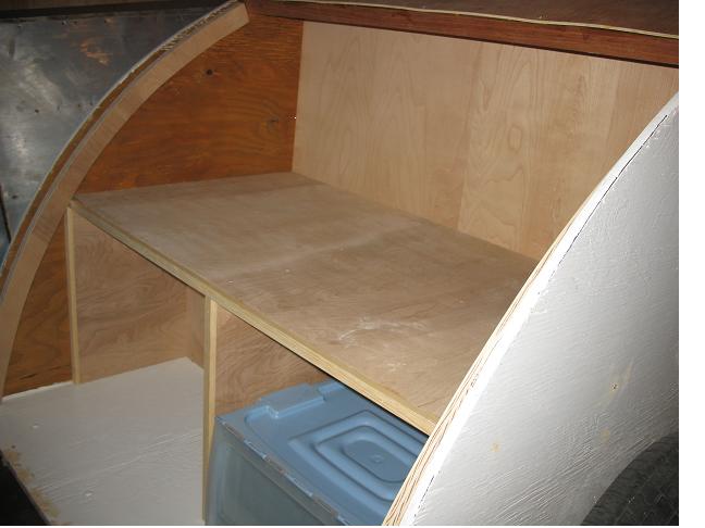

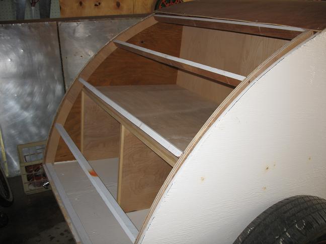

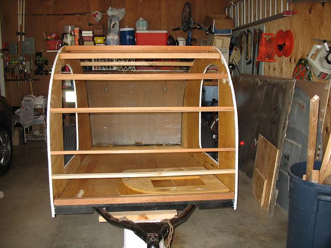

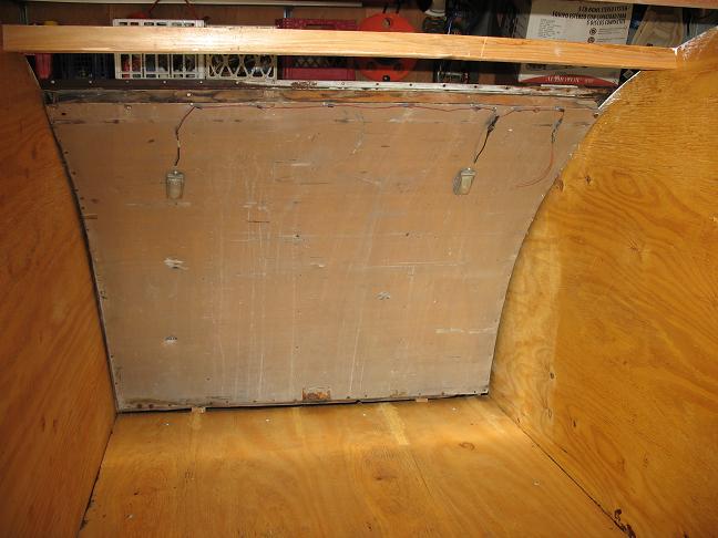

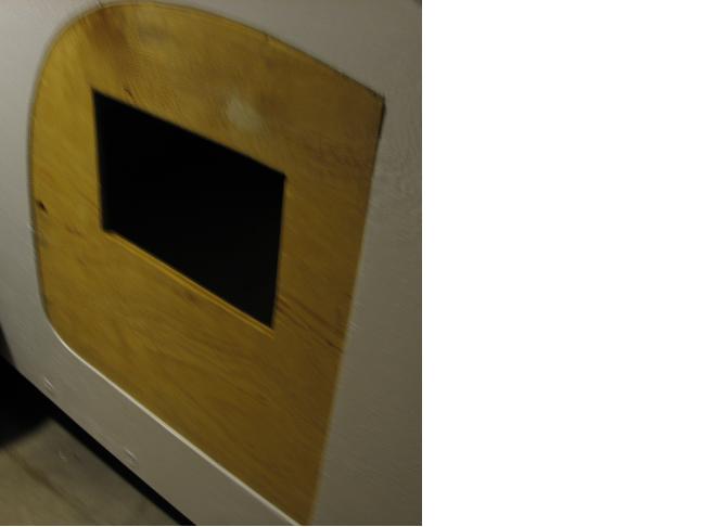

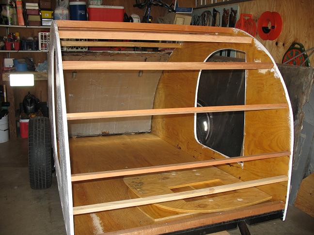

Did a little more work this week with a slow work week! Got a few things done. See pics:

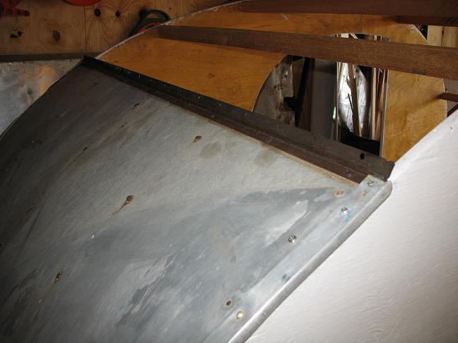

Dry Fit Hatch-This was the old hatch that I will be re-using the old aluminum after a clean up and buff!
Dry Fit Hatch 2
Dry Fit Hatch 3
Spars Complete-Mahogany Spars all the way now!
Spars Complete 2
Dry Fit Inside

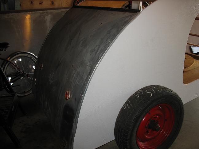

Postby prohandyman » Fri Nov 27, 2009 4:58 pm
Good looking progress! Are your 215 tires going to fit underneath the fiberglass fenders? Also, if you are going to use the camper after finishing it, you might consider turning the 1st and 2nd spars 90 deg. so that the long side touches the roof. It allows a bit more room for your head. Them spars are hard on the noggin when bumped in the night. IMHO
Dan

Thanks for the input!

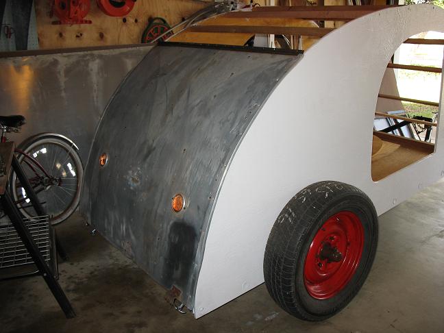

Postby SATEAR » Fri Nov 27, 2009 5:44 pm

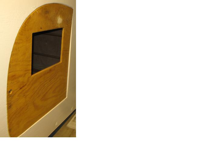

I have some steel fenders in mind that are 9" wide by 32" across. Should fit over the wheel okay. Wheel itself measures 8 1/2" from the wall and 28" across. How does that sound?
Which spars are you referring? The bottom of the bulkhead when I lay down of the top ones when I stand (crouch) in the TD? Just let me know and I can turn those longway!
Thanks,
Gabe

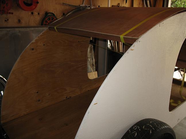

Postby SATEAR » Sun Nov 29, 2009 10:00 pm

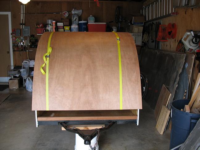

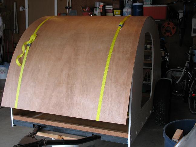

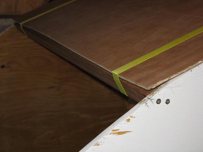

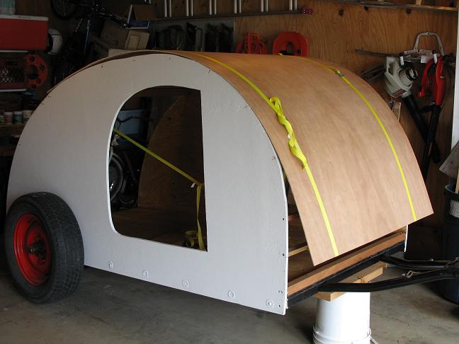

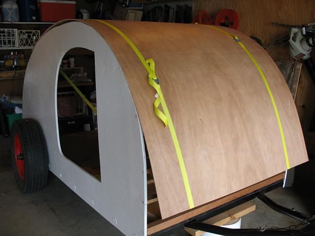

My son and I did a little more work this weekend! Measured the hatch spar about 20 times with the dry fit and the cut my spar about 3 times just to make sure :lol: I am still not sure if it is the right distance from the floor to give me 1/4" on the bottom and 1/4" between the hatch spar on the TD and the spar on the hatch. Only time will tell when I go to install the hatch. Anyway, here are the pics from this weekend!
I am using 1/8" birch plywood for the top and holding it down with lashings. It is bending into shape over the last 2 days without any breaks or cracks so far.
Does anyone know if I attach the roof directly on the hatch spar or leave a little space to attach my hurricane hinge????????
The original TD had a roof but it was dry rotted and I was not able to tell where it was attached when I demo'd it, it just fell apart :(
Chime in if you see a problem anywhere, please..............

Postby prohandyman » Mon Nov 30, 2009 8:23 am
Gabe
The 2 spars down near the front. Those are the ones I was referring to.
I run my roofs as you have yours now, all the way to the back edge of the hatch spar, along with the aluminum. The hinge will sit nicely on top of both, but requires a gap of about 1/4" between the hatch and the spar. I will see if I can find the post where someone had drawn this view.
Also, where did you find 1/8" birch long enough to go all the way from the tongue to the hatch?
Dan

Postby bobhenry » Mon Nov 30, 2009 8:46 am
prohandyman wrote:Gabe
The one pic of the front looks as if it will fall 6 to 8 inches short !
When I butted my hatch skin to my roof I put ice dam tape under the skins sticky side up to adhere to the underside of the roof and hatch skin.
I bloused it a bit to give some extra material for the flex. This is my second line of defense ! After hinges were installed I covered with rubber shelf liner and an aluminum trim strip.
Never a drop inside ! :thumbsup:
Sounds like a plan!
Postby SATEAR » Wed Dec 02, 2009 8:09 pm
I was thinking of doing something similar with the rubber covering the hinge area. I was not sure what to buy but you cleared that up for me. Thanks for the input.
Prohandyman:
My Birch Ply is only 4' x 8' and won't cover the entire roof area. Luckily I have another 4' x 8' piece that I got from a friend who is a building contractor. Actually I got all my wood from him! Free is great!
I plan to cut the second piece at about 9 inches and make the cutouts for the tongue. It will fasten to one of the spars in the front and the floor frame.
I have had the birch held in place with straps and it is nice and tight around the roof area and taking the shape of the TD now. I let is loose a little and it is staying put right on the roof.
When the weather clears up here, (we should be getting some snow in San Antonio on Friday and Saturday), I will be back at work painting the interior walls and attaching the roof ply. 8)

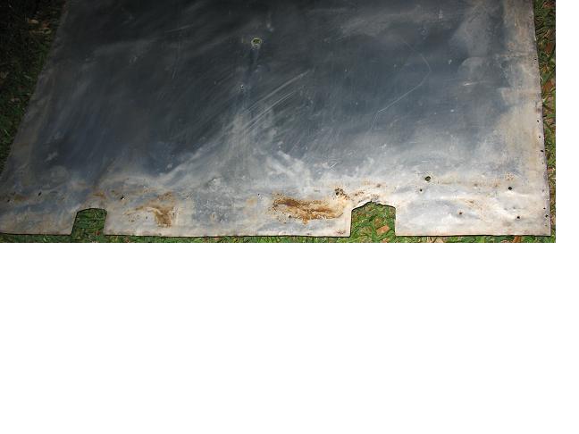

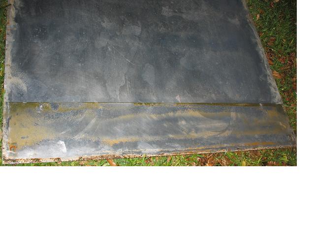

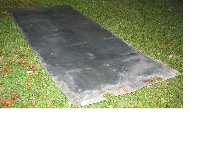

This sheet of aluminum was the original for the top of the TD. That's 63 years old. (Older than I am!) Think it can be salvaged? Any recommendations for further cleaning?
I used a scotchbrite pad and some Bon Ami and some elbow grease to get about 90% of the grime off. It looks worse than it is in the pic. The finish on it is almost like a mirror in 95% of the sheet.

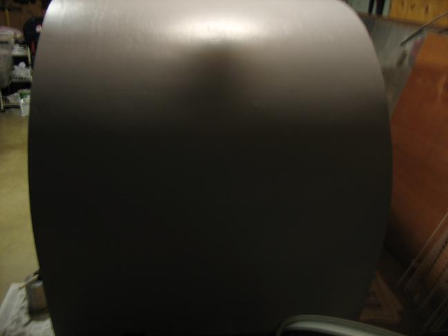

Well, here we are over 1 year (My tear was brought home one year ago on Labor Day of 2009). I have done a little more with her and she is almost "campable". Not quite but getting there. Hope to get her ready by October for our boyscout Galveston Goose Island campout on my birthday.
Door 1
Door 2
Primer 1
Primer 2
Hatch 1
Hatch 2
