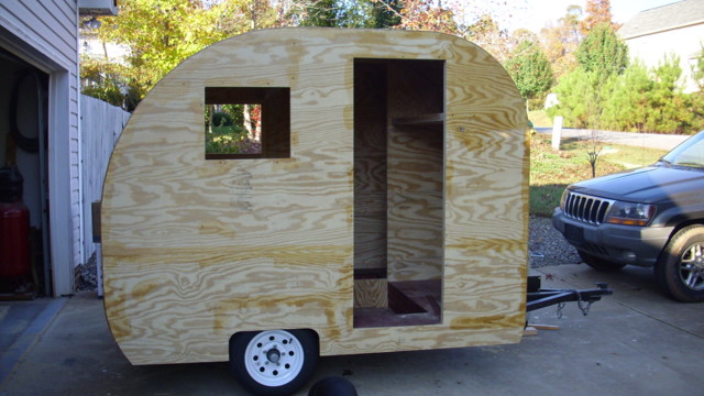

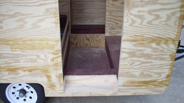

Pretty Good day of sawdust flying!

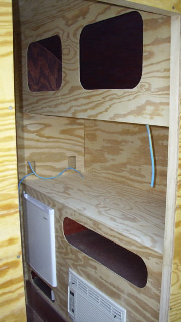

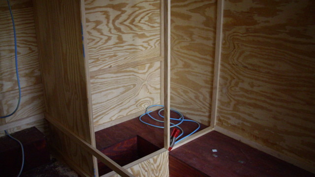

Skinned the rest of the roof, framed the bed, framed the porta-potty closet and ran the electrical rough in.
When I built the drop floor, I ran it from frame rail to frame rail. The last 12" on the drivers side becomes a little foot well for the closet. The potty then sits in the front corner. Closet measures aprox. 22 x 43 inside. Door will be just a curtain. The rear wall is a single 1/4" ply panel. The side wall is framed with 1 by and becomes the electric wall. The front of the trailer will have a mini-frig, A/C, storage and a counter. Everything from the drop floor to the rear is bed and storage under.

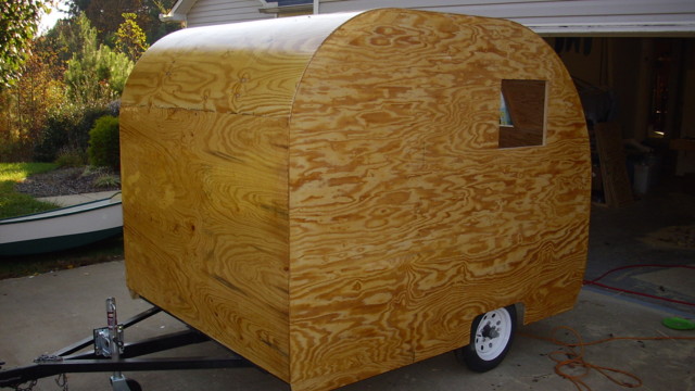

Day 5: Trimmed a rounded the roof edges. Thickened Epoxy and Sealed all the Seams and Screws. Framed and Walled more inside.
Startin' to look like a Puffin! :)
