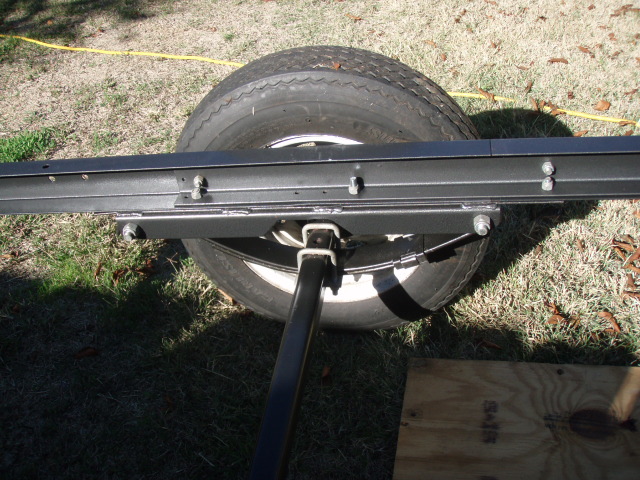

So here is what I have done recently- I needed to remove a portion of the rail that was near the folding portion, see page/picture one. So I cut one foot from each of the rails- from the middle. Used an old bed rail for the angle filler- drilled new holes and bolted it all together. Now I need to disassemble clean paint and reassemble. I rebuilt the springs as per Rob’s tutorial, so those are ready to go. :thumbsup:

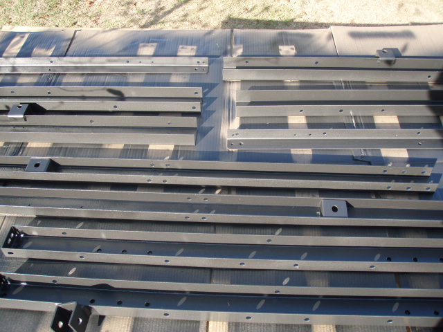

Disassembled the frame, cleaned it up and painted it. Santa brought me a compressor and brad nailer. :) I thought I would go to HF and buy a spray gun. Seemed to work fine. Now I can buy paint in quarts and save a few bucks over the spray cans. At least that is my belief. When it comes time to paint the body of this thing the gun should be a BIG help. The frame looks better now. :D I might bolt it together today if I get the urge.

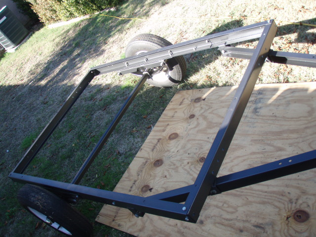

Frame now rebuilt! :thumbsup: A wonder to behold isn’t it. :R

Postby georgedombeck » Wed Jan 06, 2010 6:41 pm
Looks really nice. g

Postby bve » Wed Jan 06, 2010 9:44 pm
OK frame is done, on to the sawdust already, chop, chop. :)
Just kidding of course, I'm itching to build right now but it's too cold up here to do anything but watch others.
This frame looks good, being a bolt together though I'd probably want at least one cross member in there - but that's just me.
Burke
