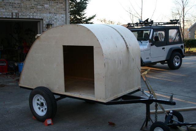

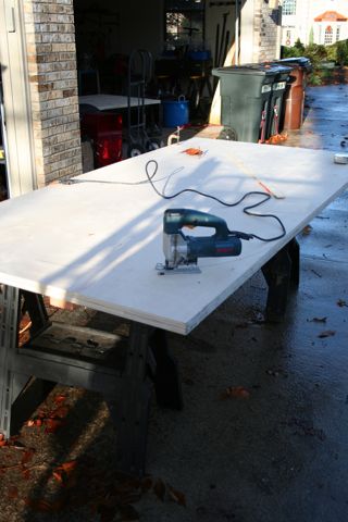

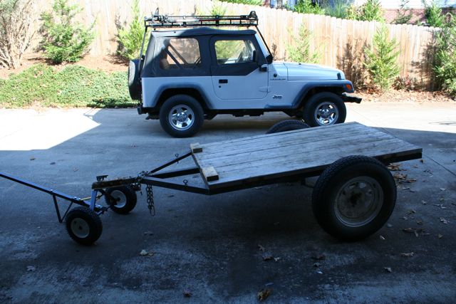

Thank you. Above is the extended trailer getting decked in my messy shop.

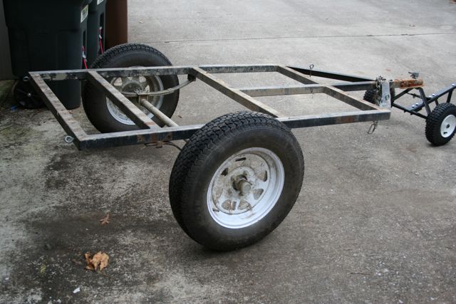

Below is the ATV trailer I started the project with:
If this works I will post a bunch more later.

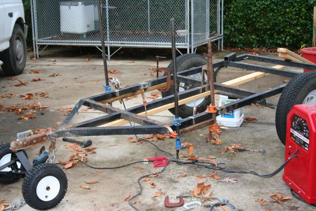

Postby Lawnjockey » Tue Dec 08, 2009 6:16 pm
Here are some more pics:

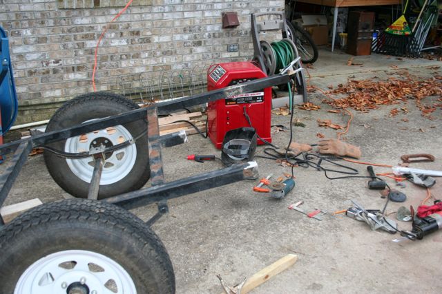

Atv trailer sans deck:

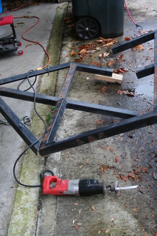

The bad weld:
Bad weld giving way during cutting:
Starting to put it back together:
Alligning the forward extension:
Profile template and checking the layout:
STINKY (don't ask) the cat checks the layout:

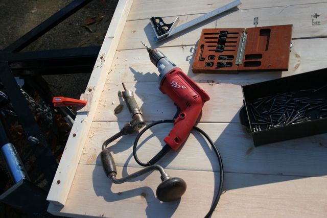

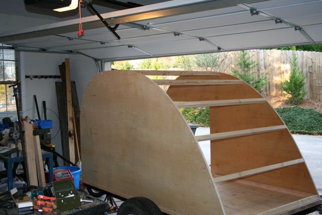

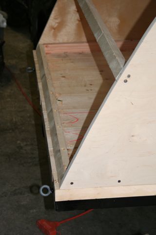

Postby Lawnjockey » Wed Dec 09, 2009 5:58 pm
I got some more work done today:
Cutting sides:
Cleaning up the edge with belt sander:
Cutting the door:
Installing side cleats:
Sides and spars installed:

Postby S. Heisley » Thu Dec 10, 2009 1:16 am
You're moving right along! :thumbsup:
What are the dimensions of your teardrop? Will you have any kind of chuck box or galley or will you make meals on the picnic table in the campground?

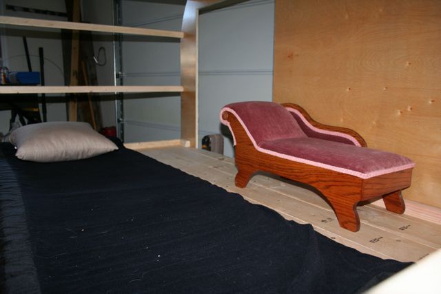

Postby Lawnjockey » Thu Dec 10, 2009 10:03 am
It is small but I just wanted something for the dog and I to sleep in:
As you can see, Casper has higher standards than I do. I still have to figure out secure storage for the doggy bon bons.
The trailer is 4' x 7' 8". I wanted something that is no wider than the Jeep that I can navigate narrow arroyos with.
I didn't do the traditional galley because if it is nice enough to cook outside then I'll cook outside. If it isn't then I want all the space possible in a small package. I am still thinking about a mini wood stove but I will also have a portable stove for my morning coffee.
I only have about 4 weeks until my next road trip so I gotta get it done.

Postby S. Heisley » Thu Dec 10, 2009 10:13 am
Love the dog bed! :lol: :thumbsup: :applause:

Postby Lawnjockey » Thu Dec 10, 2009 10:24 am
Casper is very particular and can be outright demanding at times. What he sees in me I don't know. Gotta go, he is looking at me and I am sure he knows I'm talking about him.

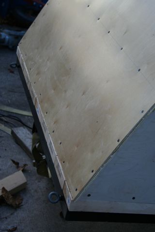

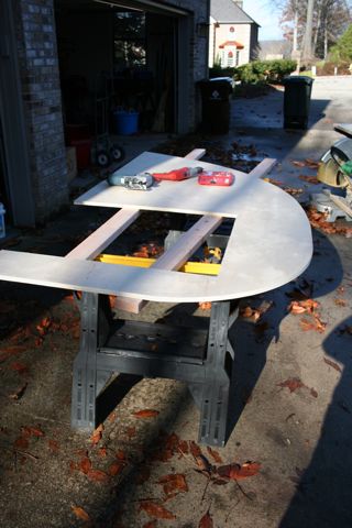

Postby Lawnjockey » Thu Dec 10, 2009 5:51 pm

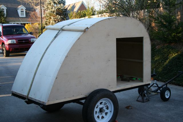

I only had a couple of hours to work on the TD today so I installed the first layer of 1/4 ply for the top:
So I am starting to get an idea how this thing is going to look.
Weight wise it is still easy to lift off the jack stand and put on the dolly so I think I am doing fine there.
Did anyone else think it was cold today? I may have to put a heat lamp inside the TD to get the adhesive to set for laminating the second layer on the top.

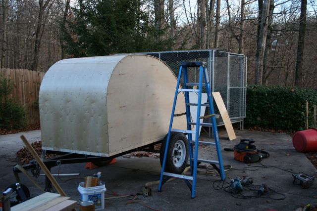

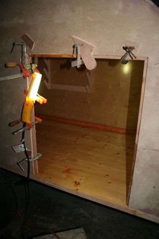

Postby Lawnjockey » Fri Dec 11, 2009 6:24 pm
It was so cold I found excuses to do just about anything but work on the TD. I finally got of my behind and installed the second 1/4" roof layer. I was climbing around on to setting screws, the TD is stronger than the proverbial brick restroom.
Second layer installed, joint staggered so as to avoid a kink:
I was glad to get to the end:

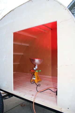

I set a heat lamp inside and covered the door with a tarp so that the adhesive would kick, it is really really cold:
This week end I'll trim, bondo, and seal.

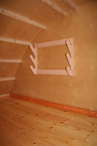

Postby Lawnjockey » Sun Dec 13, 2009 7:02 pm
I put in a few hours today, the weather is still wet and cold so I worked inside. I built and installed an oak gun rack (this is a hunting rig and man cave), I cut plugs and plugged the screws in the cleat, and I got one of the uprights in for the door jamb. Actually it is a 1 x 4 oak door stop. It goes floor to ceiling so the layout was tricky due to the curve and a spar. Not much but a step in the right direction.

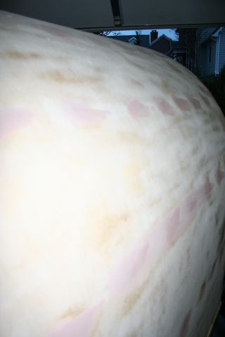

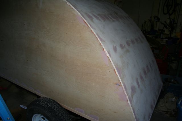

I trimmed the roof edge using the minigrinder with a #80 sanding disk. Very fast and neat. I then sanded the entire exterior using a DA sander. Then, my favorite part, first coat of Bondo:

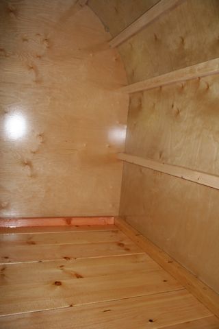

Then I sanded the floor and gave it a coat of varnish. I wanted to get a few coats on it so I am not grinding fecal material into it as I work.
I will be varnishing the rest of the interior trim later, for now it is about protecting the floor.
