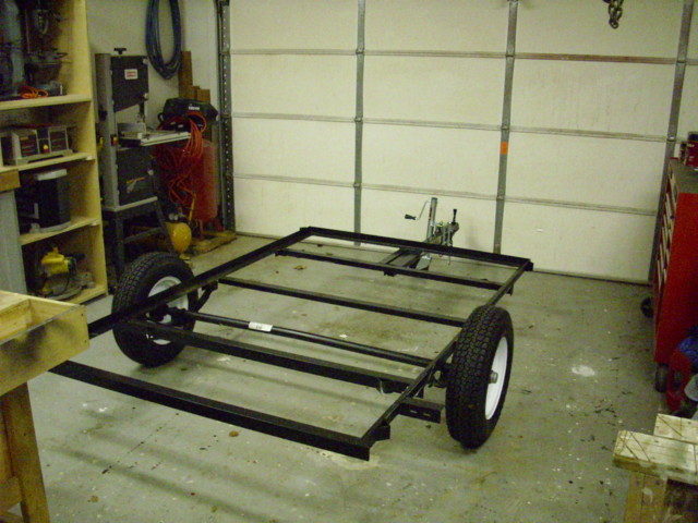

Hi John. It is a Carry-On 5 x 8 trailer from Northern Tool. Basically it was a frame made from angle iron and did originally have fenders. I decided to remove the fenders for fear that gunk (dirt, mud, whatever) would get between them and the fender boxes, absorb moisture, and cause rot.
This isn't my picture, but here is what it looked like as purchased after the fenders were removed: Image
This is about the oldest picture I have. It was taken prior to me cutting the fenders off: Image

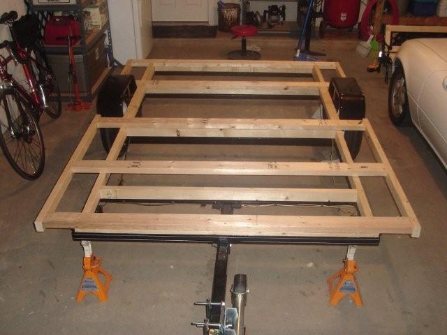

During constuction I did reinforce the second crossmember with a second piece of angle iron bolted on with grade-8 bolts. It is imperitive that the second crossmember be bolted to the frame or floor you lay on top of it; otherwise it will bend downwards. Additional reinforcements could be welded to the frame before you start construction--something to consider.

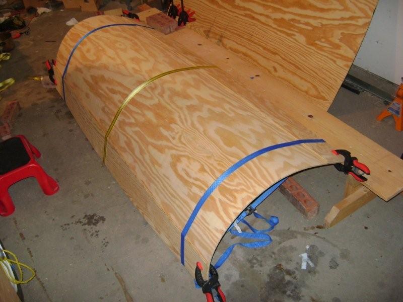

Postby Donutboy » Tue Dec 08, 2009 12:06 am
Jeeper92 wrote:Where are ya on this build?
Bending plywood for the rear of the trailer (as shown in the avatar).

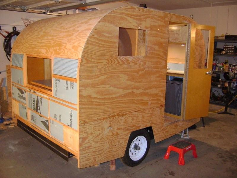

Postby Donutboy » Tue Dec 15, 2009 12:03 am
Got the rear roof section on and trimmed. One more panel to go!
Jerry

Postby Donutboy » Mon Dec 21, 2009 7:48 pm
Got the final skin on the outside. Need to build a hatch for the air conditioner next.
