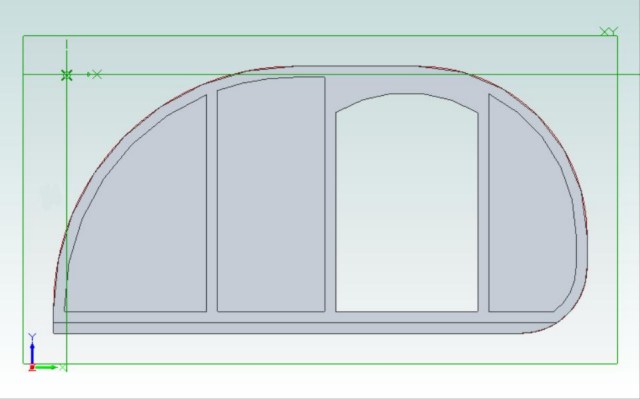

@Chris, I was intending to 'dumb' frame the wall with the layout shown in the picture below.
The materials will be (from the inside out):
0.8mm Aluminium
9.0mm WBP Ply, Outer skin
24.0mm Dumb framing of a material as yet to be decided upon
6.0mm WBP Ply, Inner Skin
Rain proofing is *essential* here, in fact I might as well fit buoyancy tanks and a snorkel ;)
I would imagine that the noise of rain on doped fabric would drive me mad.
I have contemplated some ultra lightweight notions, including simply 0.8mm Aluminium sheet directly onto 24mm high density urethane foam sheet with an inner wall of 6mm ply. I rejected this due to the lack of a good fixing to the base and around the roof, and also damage to the body from road debris.
Kind Regards, BigAl.

Postby jackdaw » Thu Jan 14, 2010 7:10 pm
BigAl wrote:@Chris, I was intending to 'dumb' frame the wall with the layout shown in the picture below.
0.8mm Aluminium
If your going for a sandwitch wall construction, why not go for 6mm inside and out ? It will save you some weight, and still be plenty strong enough. :thumbsup: :thumbsup:

Postby BigAl » Fri Jan 15, 2010 3:11 am
Hiya Dave, Would glue and screws make an adequate fixing through the 6mm external sheet to the floor? Or, should I fix the wall to the floor by also glueing and screwing down through the frame to the floor in addition to the fixing through the external sheet?

@Dave, I think you are right 6mm outside should be adequate with a good fixing. Those diagrams are very informative, thanks.

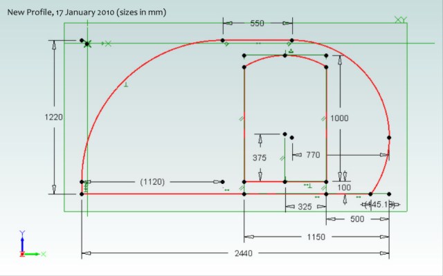

Postby BigAl » Sun Jan 17, 2010 3:23 pm
After reading the Wiki Book on Teardrop Construction, I noticed that the author recommends that the minimum radius that ply will bend around is 20 inches (500mm) and they recommend 30 inches (762mm). I therefore had a rethink about the profile and have changed the bottom right radius of the profile from 300mm to 770mm. You can see the difference by comparing this image to the image of the frame I posted previously.

Postby angib » Sun Jan 17, 2010 6:35 pm
BigAl wrote:I noticed that the author recommends that the minimum radius that ply will bend around is 20 inches (500mm) and they recommend 30 inches (762mm)
However that is for the builder's choice of 5.2mm luan ply - pretty much 1/4". So that will need a fairly big radius to bend around.
I think you're planning to use 1/8" ply, in which case you don't need such large radiuses - though they would do no harm.
