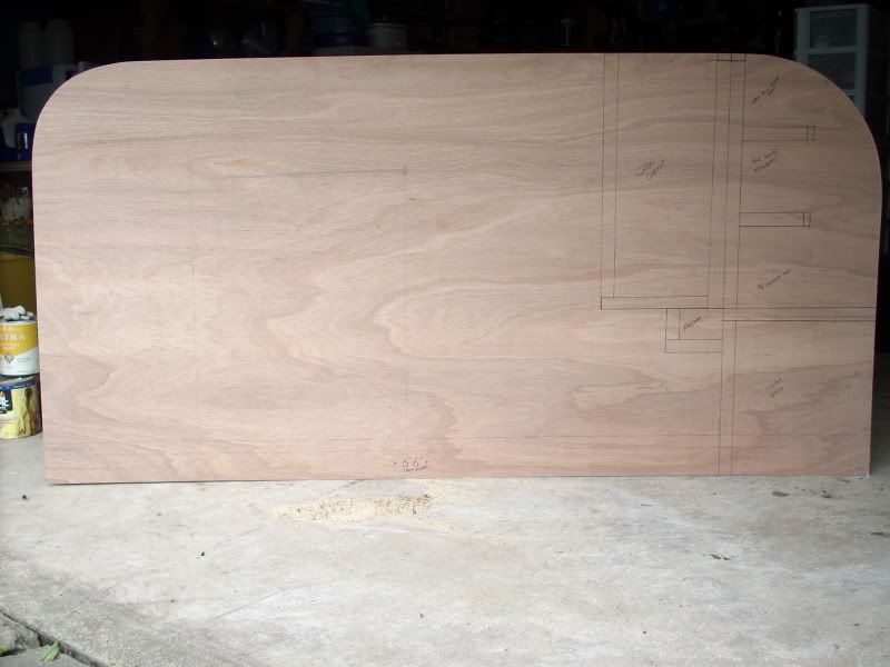

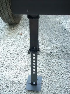

Well, I guess the build is "officially" in progress...my Nikon is arguing with the computer....I got the frame painted with DupliColor truck bed liner and bolted the rear stabilizers in place....
Hoping my 'home-grown-computer whiz' can get this camera/computer thing worked out...sawdust is still a ways off, I did get a simple profile done on 1/4"x4'x8' luan.. 12" front radius and 18" rear radius ....for now.

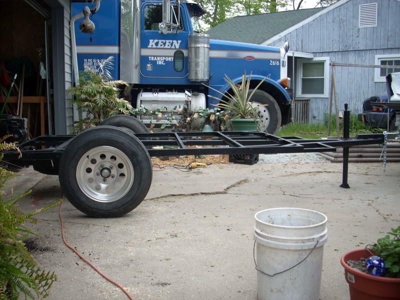

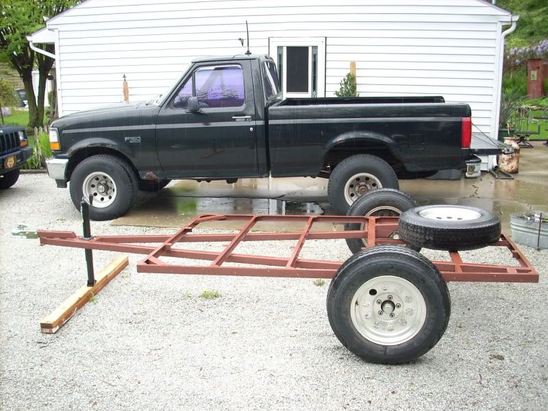

Postby Billy K » Fri Aug 27, 2010 8:55 pm
Finally......
As it awaits work
4x8 profile idea.
I kept saying I had pics but, now 'the guru' has put the tech stuff together; and ....well; don't mind the rusty truck...it's being repaired slowly, too!
Hope the photobucket resizing worked.

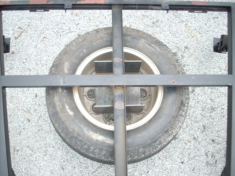

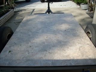

Postby Billy K » Fri May 27, 2011 10:34 pm
Think these are sized well...if not someone yell at me and I'll try to fix 'em!

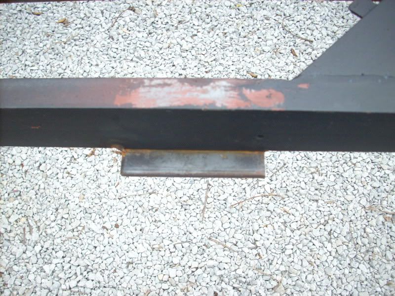

1) tabs to set walls on
2)spare carrier
3) side view in spray on bedliner
More to come with sawdust tomorrow...

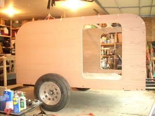

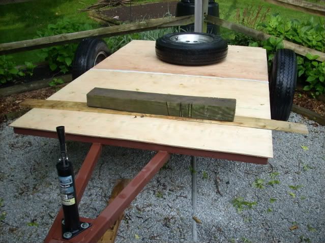

Postby Billy K » Sat May 28, 2011 10:12 pm
As you may have noticed...some thoughts and ideas have changed due to help from so many here that I can't list them; and be sure of not leaving someone out! So, I'll say Thanks; to Bob and Vicki Henry for their help today!!
I splined (used 1/8"router bit and birch) the floor together and put the tiles on last weekend
12x12 linoleum tiles.
pardon the shadow..
as "She" stands tonight...
Will be doing some more tomorrow....

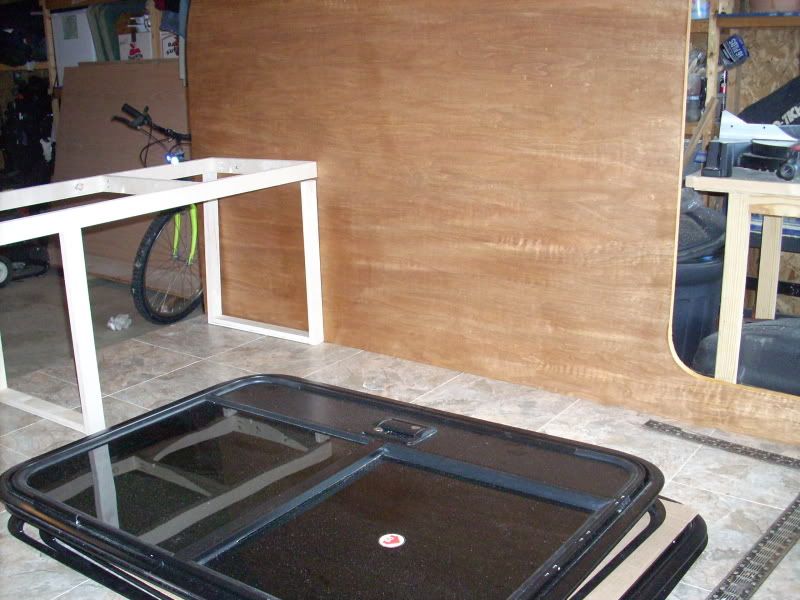

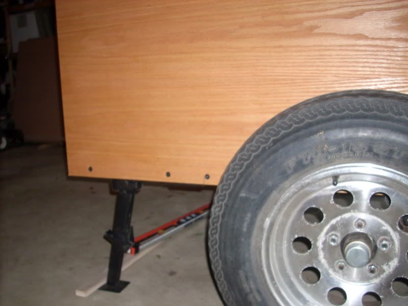

Postby Billy K » Sat Jun 11, 2011 11:06 pm
128 trailers, Bob...
This'n will be unfinished but, attending CRA... now for today's update!

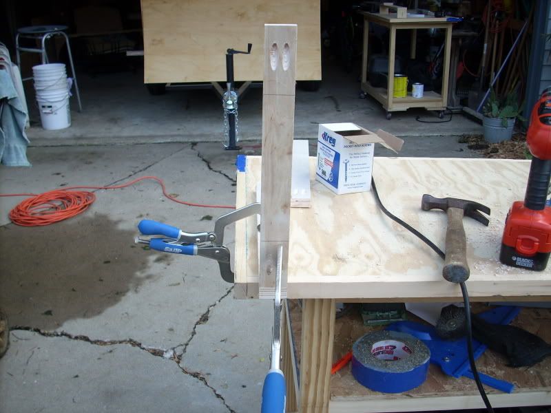

Started with some Kreg Jig'n...and rain drop dodgin...can you believe the weather folks got it wrong..?? :shock:

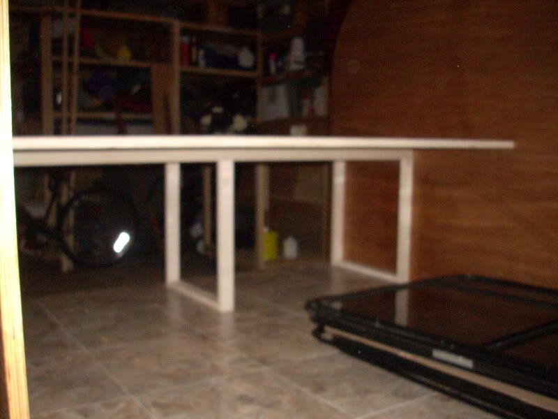

fitted a temporary frame...

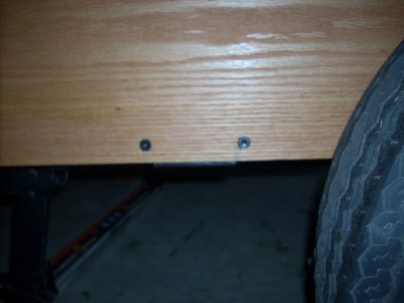

tried on the counter top/bottom of over foot cabinets...
and took a couple pics of the lower, right, rear corner to show some of the intended color and the self tapping deck screws I used with some Liquid Nails Fuze...
Gonna go look at some different stains for the roof in the a.m. The one I had picked is WAY too black...
Will be an all wood surface; 'cept for a hinge here or there,vent and doors:
When all is stained, it will get a coat or three of Cabot Spar varnish (clear), well that was today - see what I can get done Sunday...
