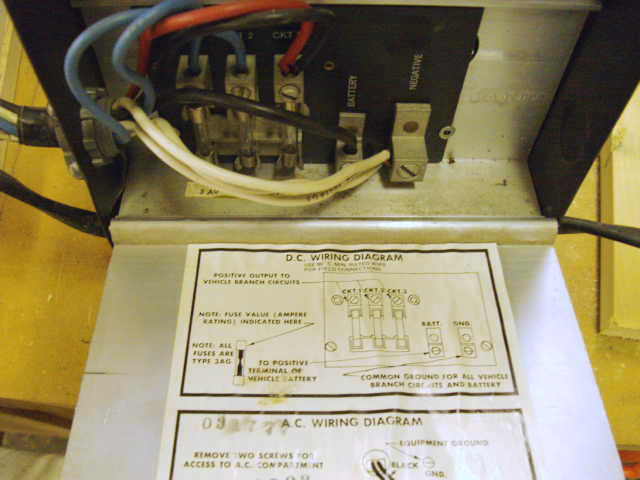

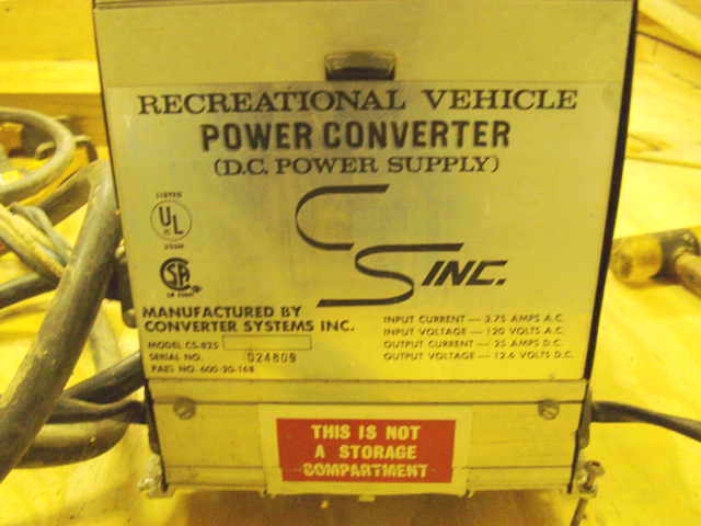

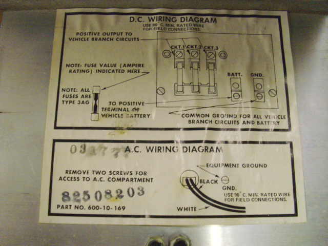

Mines a 30 amp while yours is only a 25 amp, but I'll bet they are wired the same. Does yours have a wiring diagram on the inside of the access door? Besides the wiring diagram, someone took the time to label it pretty thoroughly also. I'm still a ways from the wiring stage, but let me know if I can help...

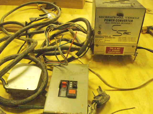

rwelp wrote:I checked the converter and it does have a diagram on the inside of the door. Mine only has 3 circuits though and does not have the filtered one for a stereo like yours does. Does this mean I can only wire 3 outlets/lights to mine? When I took mine out of the rv it was in I tried to leave it intact as much as possible. The shore power cord is still connected to the breaker panel. I also left the wires connected to the converter. There is a black wire from the battery, 3 white wires connected to the ground block and a blue wire on each of the first 2 circuits and a red and black wire connected to the 3rd circuit.
GreatPumpkin wrote:As requested, here's a couple more pics of the labeling. I guess it's not really much more help than the wiring diagram, but I hope it helps...
The black romex in the bottom right is the 110 AC input, the Red and White wires go to the battery. The blues and browns are the 12v power leads, and the whites are all on the common ground bar.
rwelp wrote:Thanks GP, That does help some. Do you happen to know if these converters also charge the battery?
