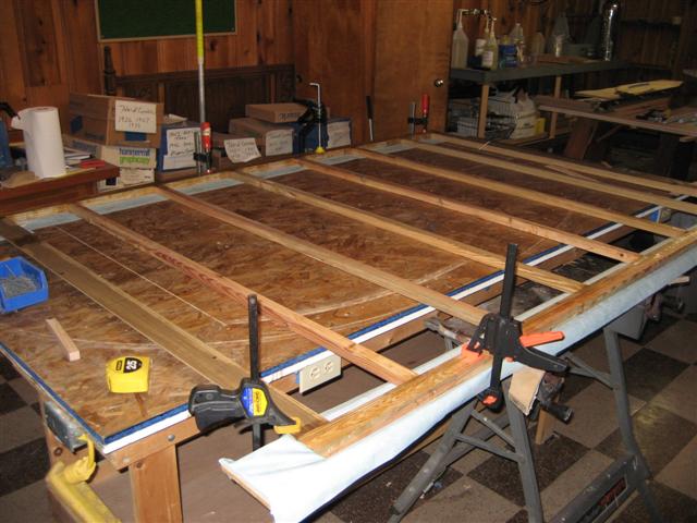

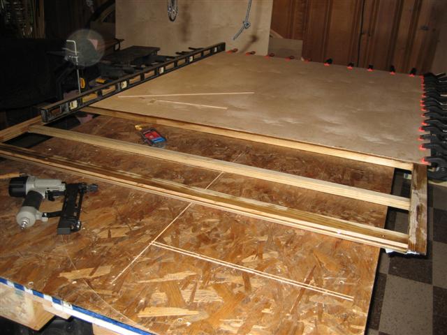

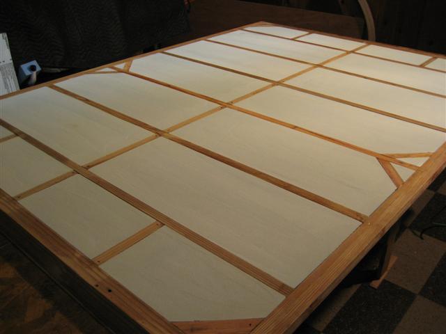

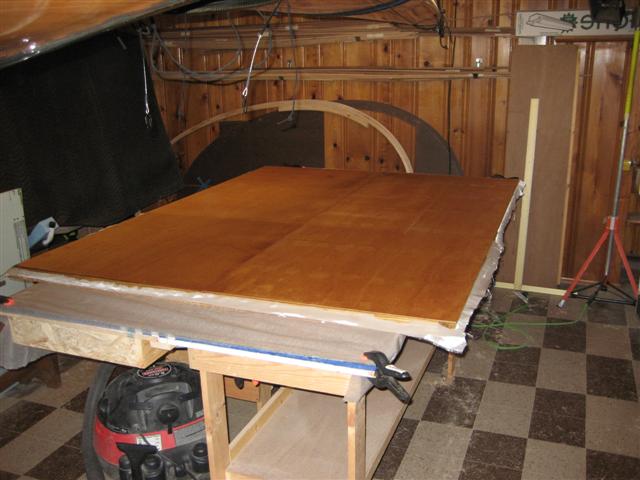

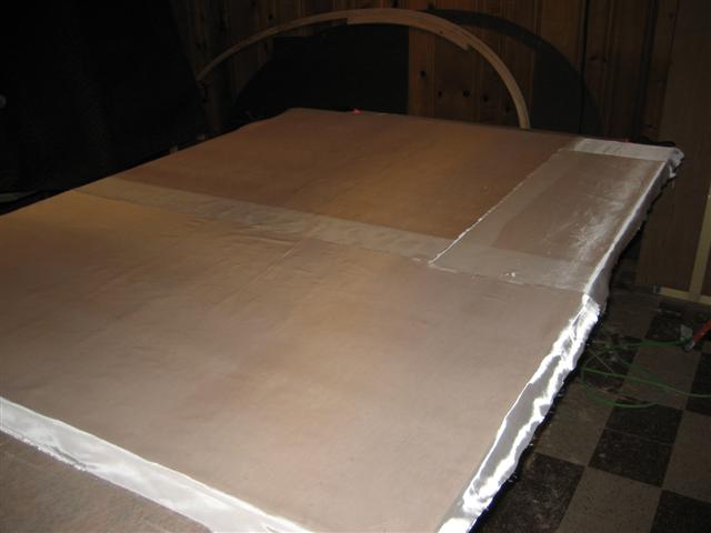

Assembling my recycled pressure treated picnic table wood into my 5X8 floor. Epoxied and screwed.

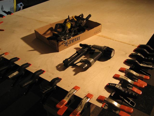

1/8" Russian Birch epoxied coated and attached with thickened epoxy, narrow crown staples and clamps.

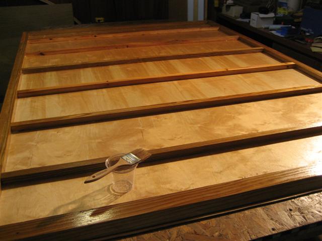

1/8" Skin epoxied on to frame:
All underside surfaces coated with epoxy:

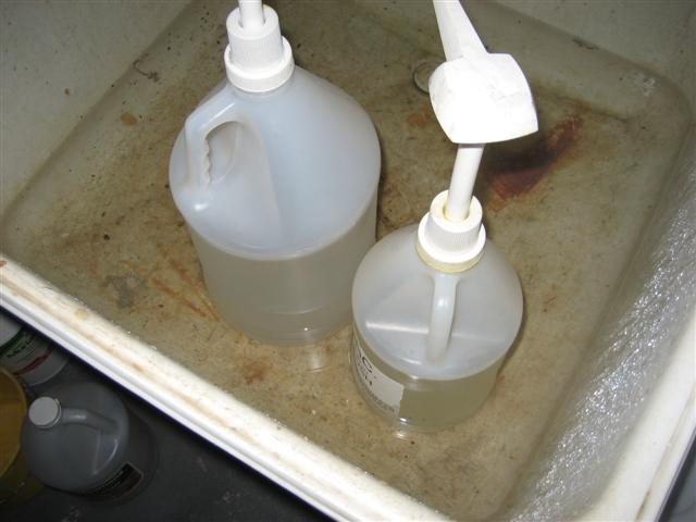

Warming epoxy in a nasty sink:

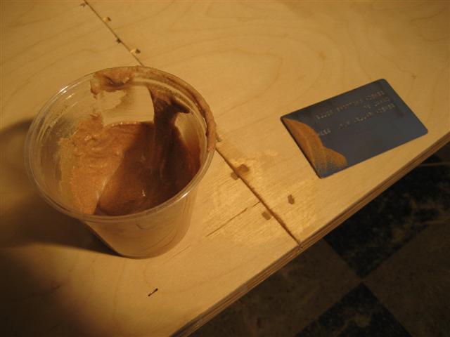

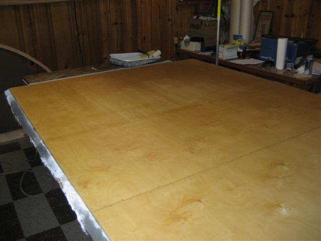

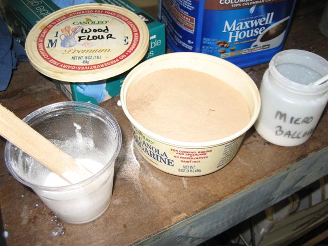

Mixing epoxy with micro ballons and a little wood flour for color, to fill staple holes:
Filling holes with easily sanded epoxy/micro balloons mixture:

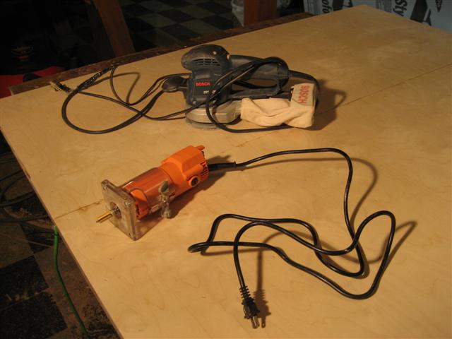

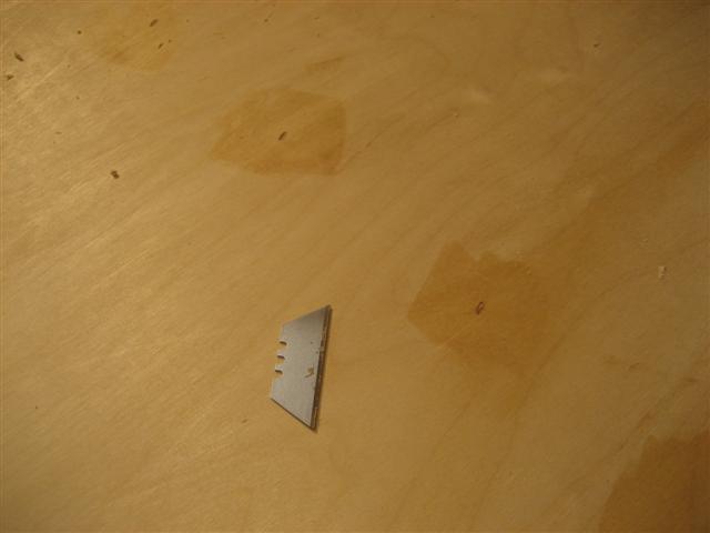

Using a utiliy knife blade as a scraper after initial cure:

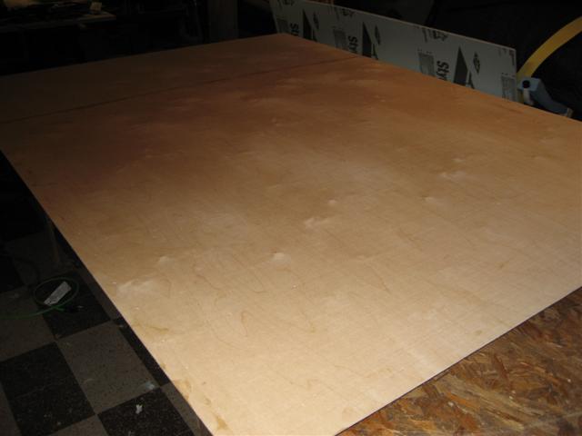

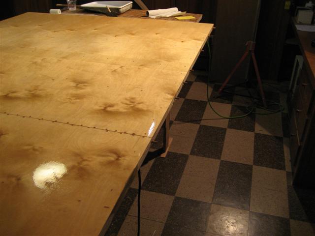

Plywood trimed with router and surface sanded, ready for glass:

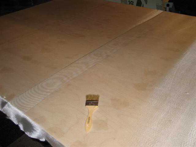

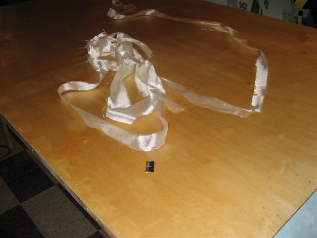

Glass cut and layed out. Dry brush eliminates wrinkles.
Glass wet out coat:
Waste fiberglass trimed with razor blade:
Light sanding after first fill coat (thin glass):
Final fill coat rolled on tipped off with foam brush:

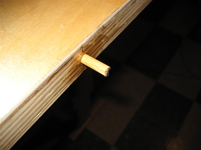

Counter bored screw holes pluged with thickened epoxy and wood dowels:

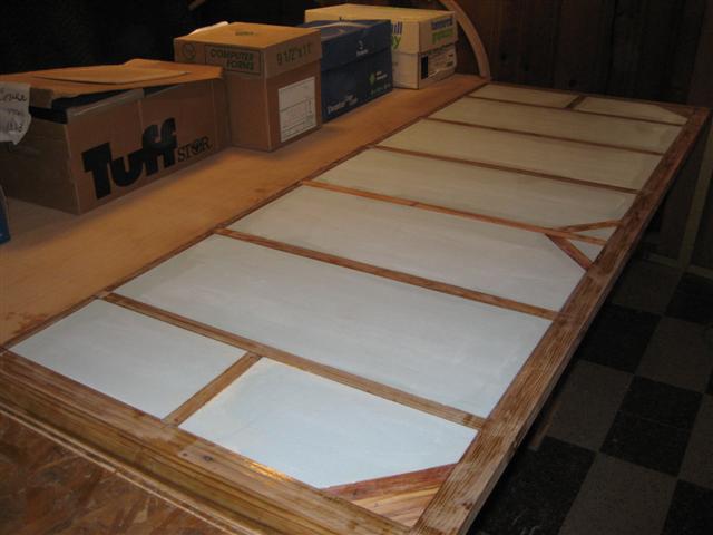

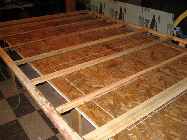

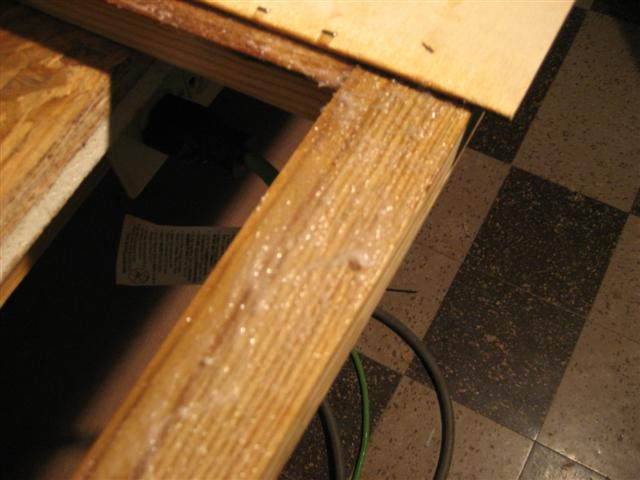

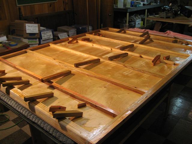

Added more bracing to floor, all epoxy coated.
Foam glued in with thickened epoxy....

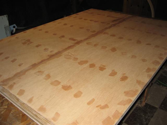

Boxes of books and staples hold down the door skin ply, thickened epoxy for glue.
Staple holes filled...
Using up some small pieces of fiberglass glass cloth.......
Fiberglass wet out with epoxy......
My new stress skin panel consists of 1" X 1-1/8" pressure treated Southern Yellow Pine.
This is from a 20 year old picnic table. The lumber is not like what you find today, it's straight grained, dry, and strong. Epoxy sticks to it very well.
The top and bottom skins are 1/8" plywood with fiberglass on the top and bottom. All internal and external surfaces are epoxy coated, including the foam. Everything is glued with thickened epoxy and internal cracks/voids. are filled with the same.
With the fiberglass on the top and bottom, I can now lift one corner of the 5X8 floor without it bending at all. I need this strong foundation as my frame is just a triangle and the body will be a major part of the strength of my tear.
I will paint the bottom and varnish the top. The completed 5X8 floor weighs 60#

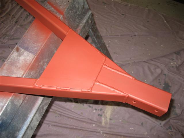

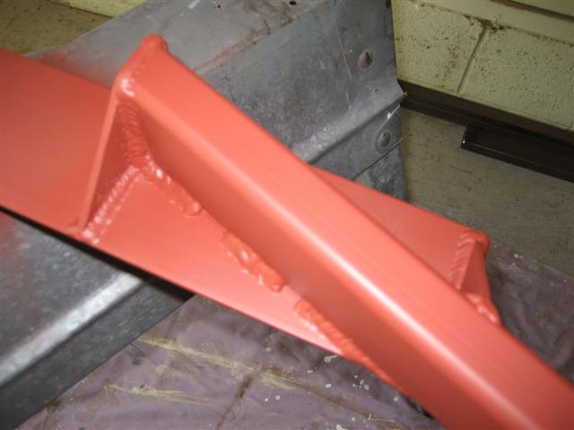

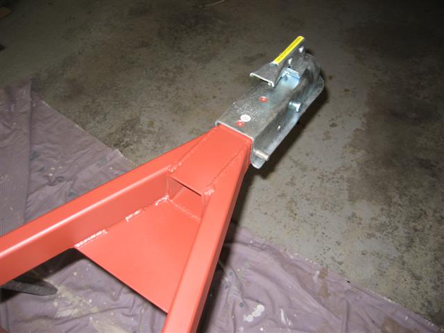

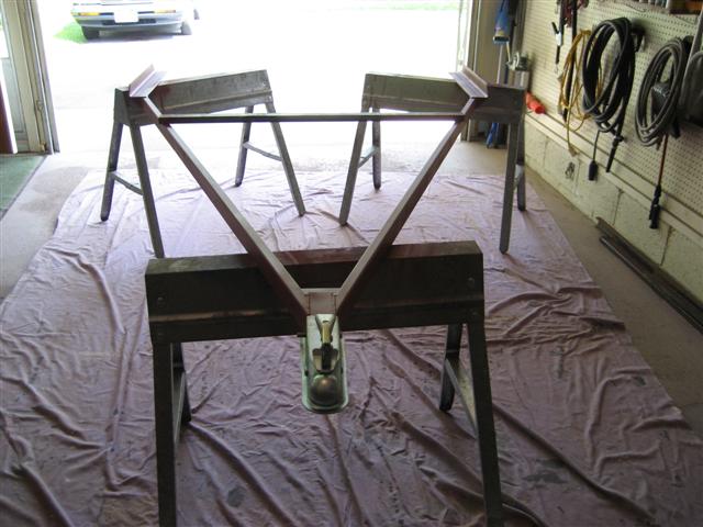

Frame Welded
Postby Larry C » Mon Jul 12, 2010 6:48 pm
Here's my frame:
[img]http://www.tnttt.com/gallery/image.php?image_id=68037[/img[/img]

Postby wlivesey » Wed Jul 14, 2010 7:30 pm
That's a great looking ultralight frame. I'll be watching this build... Did you have the frame build or did you build it yourself?
wlivesey
Posts: 469
Images: 283
Joined: Sun Aug 12, 2007 1:22 pm
Location: DFW, Texas
Postby Larry C » Wed Jul 14, 2010 8:29 pm
wlivesey wrote:That's a great looking ultralight frame. I'll be watching this build... Did you have the frame build or did you build it yourself?
Hi Bill,
Thanks for the kind words!
Andrew graciously redesigned a 5X8 Ultralight frame from his 4x8 Pico frame design for me. However, I was not comfortable with the Flexride stub axles only being available in 550# or 935# capacity. I was looking for something closer to my 500-600# total weight trailer goal.
I really want an axle around 650-750# range. Dexter 8 can do this.
Sooo........ I took Andrew's 5X8 Pico/Ultralight design that he did for me and incorporated into his Ultralight design. His Ultralight design uses angle iron for the tongue. It also was designed for the Dexter 8 Axle.
I already had everything cut using 1" X 2" tubing, so I just modified it somewhat to work with the Dexter 8 axle. The design is a marriage of 2 of Andrew's great designs.
Sorry to be long winded, but credit for the design and a little background of how I got here is worth mentioning.
Anyway, to answer your questions: I did all the planning, procuring, cut all the steel and layed it out ready for welding, however I had a pro welder friend come over and do the welding.
BTW/ the cross piece is not part of the frame, it's just a tempoary brace till I get my axle.
