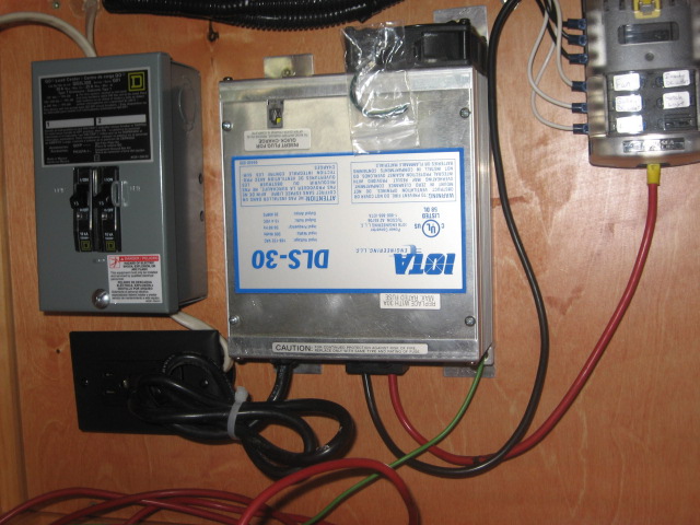

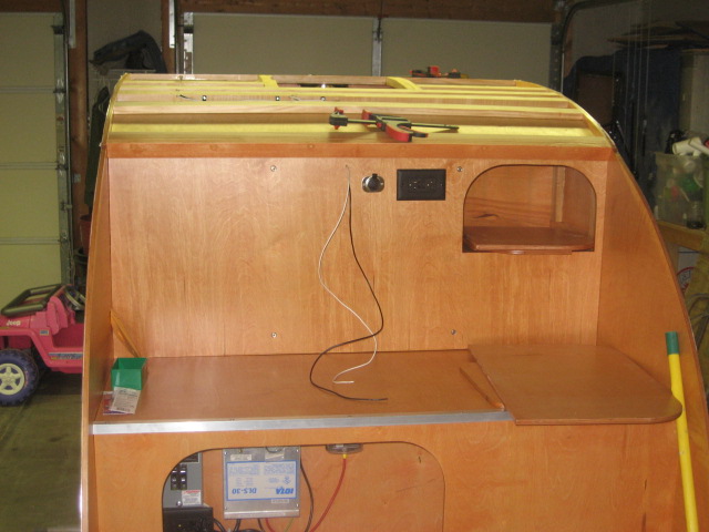

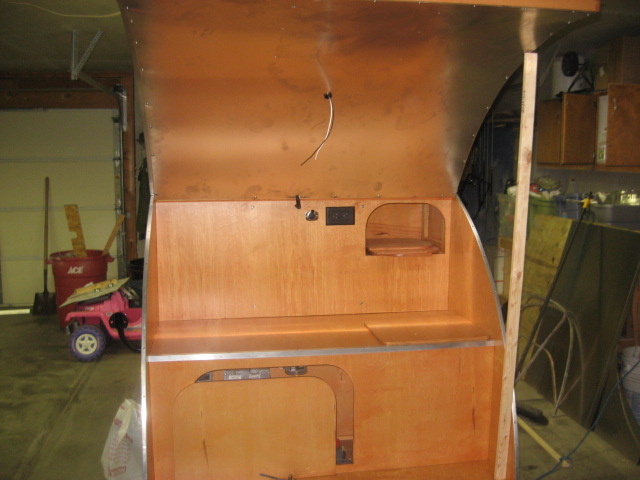

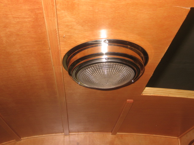

The wife took the kids out of town this weekend so I had 2 entire days to devote to the kit. I got quit a bit done over the course of the last 48hrs. First I finished most of the wiring. 2 reading light, and a dome light inside. Then a set of one 12v outlet and one 110v outlet, both inside and in the galley. No battery as of yet.

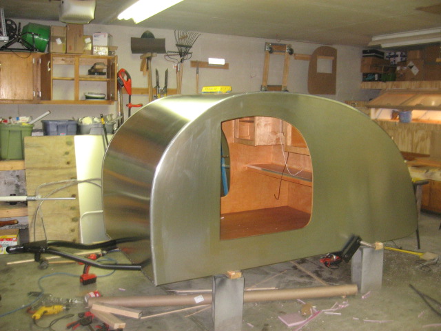

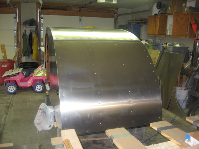

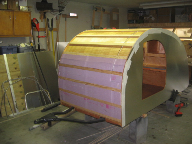

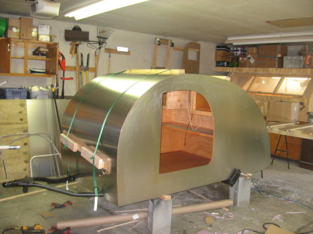

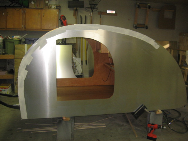

Next I started on the aluminum skin. I first rough cut the sides with a jig saw then contact cemented them to the side walls and trimmed flush with the router. Then I spent what seemed like an hour cleaning up metal shavings from all over the garage. After both sides were covered I insulated the roof with 3/4 pink board and covered directly over that with the aluminum.
The top edge moulding is in place. I used the aluminum drive screws from teardrop fix it shop. They gave it great rivet look and they should hold well. I had a heck of a time removing the originals during the deconstruction. I also reused some of the old trim pieces. It took a lot of elbow grease and some 150 grit and 400 grit sand paper to clean them up, but they looked great when done.
For the heck of it I put one tire on and mocked the fender up to see what it will look like. The fenders will eventually be black.

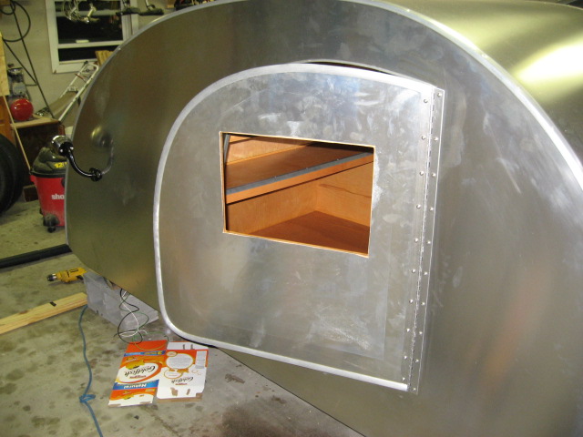

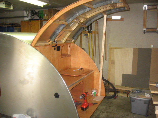

Then on to the hatch. It was built out of four 3/4" treated plywood ribs. The lateral 2 ribs were also covered by 1/2" birch ribs for looks. Aluminum was placed directly over the top and bottom.
The top skin on the hatch is also secured with drive screws. I have yet to rivet the top edge moulding to the lateral edge of the hatch.

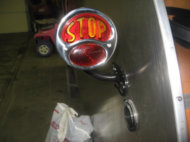

I also found time to mount the tail lights and the shore power outlet.

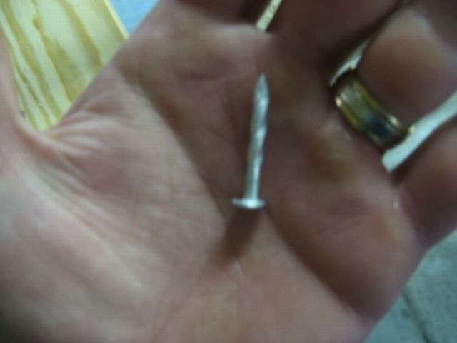

Thought I'd post a pic of the drive screws that I used on the top edge moulding. They installed easily, just predrilled the aluminum and then predrilled the wood with a smaller bit and drove the nails/screws with a hammer and used a bolt that had a concave tip that matched the nail head as a punch, as to limit any hammer impacts on the trim.

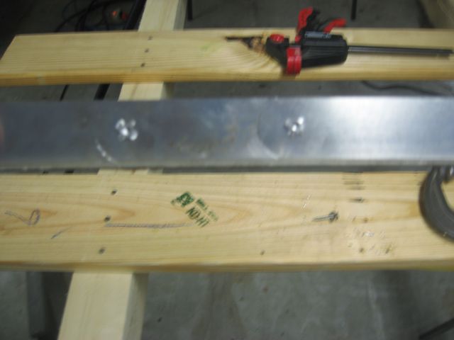

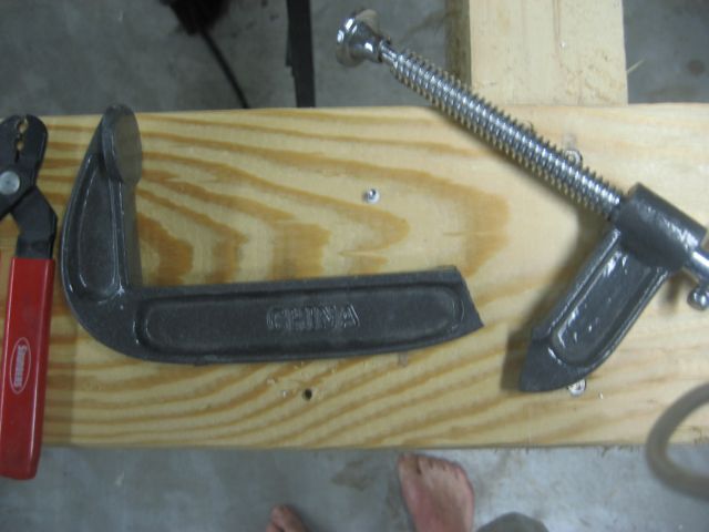

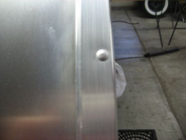

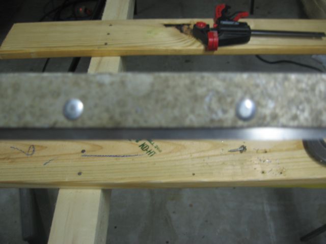

In order to keep the rivet look along the top edge of the kit that the drive screws achieved, I decided to use the hollow shaft rivets from teardrop fix it shop for the top edge moulding that runs the lateral edge of the hatch. I figured that one of body shop persons I know in the area would have a rivet squeezer for installation but no luck, and I didn't want to spend the cash on a tool that I'll use once. So decided to us a pair of C-clamps to provide the squishing power needed to secure the rivets. After some practice I found that if you cut an x into the hollow shaft end you are able to fold the 4 created sections of the cylinder down after inserting in hole, and then apply the clamp and squish tight. You are left with a rivet back that looks like a + sign and the face of the rivet is a little flat, but it works and looks good.
The first c clamp that I used was made in china and failed
I'll attempt the actual install tonight, so far just practiced on the scrap pieces of aluminum.

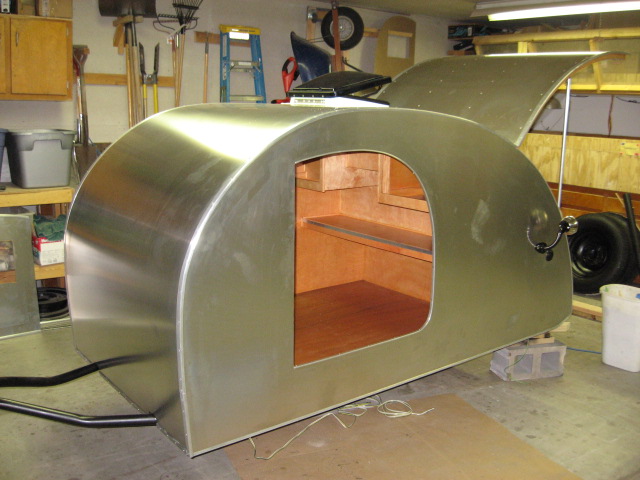

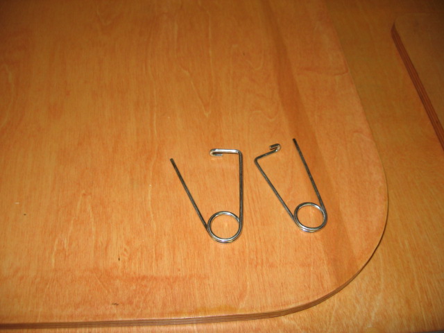

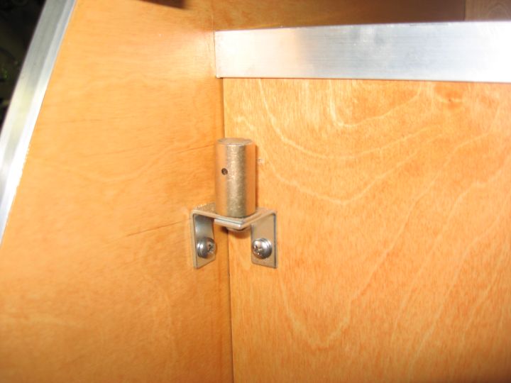

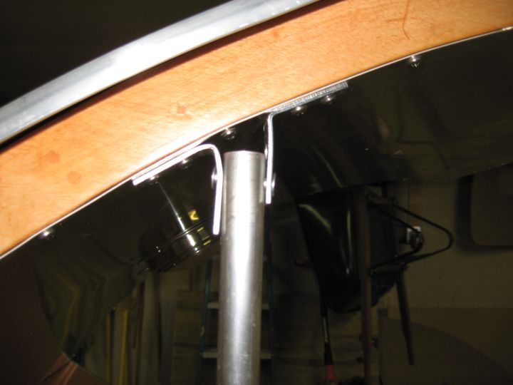

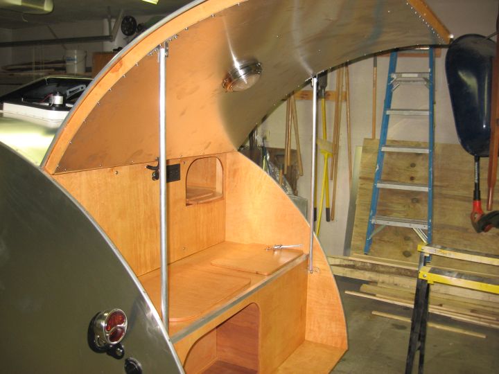

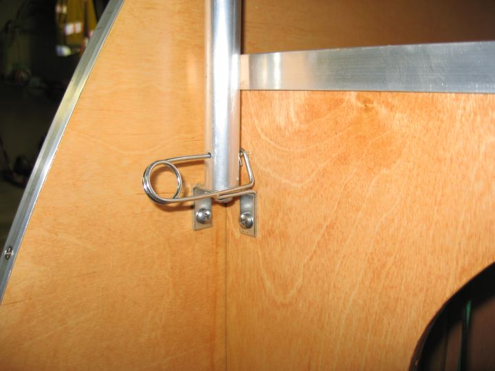

Finished with that hatch supports last night. I didn't use the gas struts, I just kept it simple and attempted to stay close to the original design of the supports that were used on the kit, well, my kit anyways. Not sure if they were the originals or not. All the supplies a got at the local ace hardware store. The supports themself are 3/4 in aluminum tubing. The tops are attached to the hatch with L brackets that are bent and the tubing is fixed between the brackets with aluminum screw posts.
The base for the supports is also made out of small L brackets that are screwed to the sidewall and base cabinet at a 90 degree angle. I then screwed a section of 1/2 dowel ontop of the brackets and hammered a 5/8 brass bushing over the dowel. The aluminum tubing slids on and off nicely. To secure the supports I used some big safety pins
I also got the door edge moulding installed and the top edge moulding installed along the bottom. I also installed a fantastic vent fan. I'm not a huge fan of the look so far. Not sure if it's the white plastic of the fan that I don't like or what. I may look into painting it black. You'll also notice the axle is removed. I thought I would be able to use the original axle but after putting the tires on under weight it was evident I would not be able to. What I thought was a little slop was greatly magnified at the perimeter of the tires causing them to rub. I even threw some washers on the hubs to see if that would keep the tires off the walls, but no good. I've put in a call to a local dexter distributer and they are trying to figure out a new axle.
I'm hoping to be done by the end of June. We are planning on taking the kit on its first trip to yellowstone. This whole axle thing may be cutting it close.

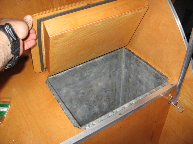

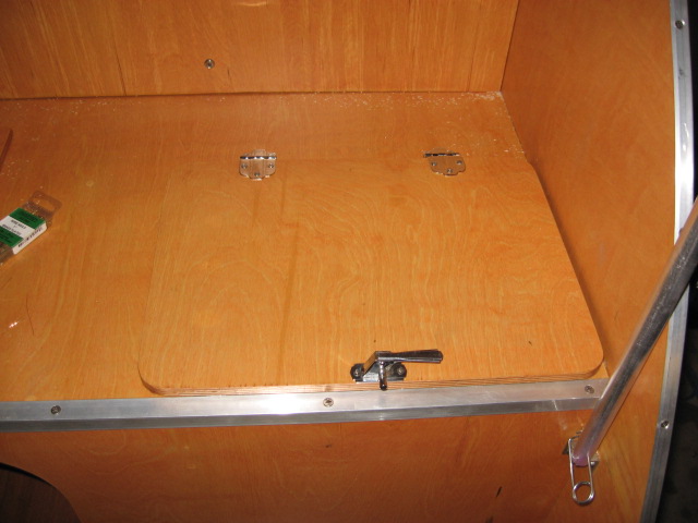

I got the ice box installed after dealing with the whole axle dilema. I used the original that came in it, it cleaned up nicely with a wire brush wheel. I used new retro style hinges but was able to reuse the latch.

I guess these are Repro lights ????
Where did you get them from, and how much were they ?
Greetings from England.
Rian.
grizz
Posts: 1210
Images: 29
Location: Rochester, Kent, UK
Postby maud'Dib » Sat Jun 12, 2010 8:42 am
The tail lights are reproduction lights. I got them off of ebay. I spent around 40 bucks for the pair. I also got the posts for the lights from eday and they were around 20 bucks.

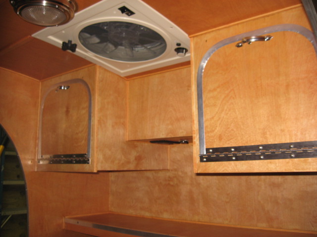

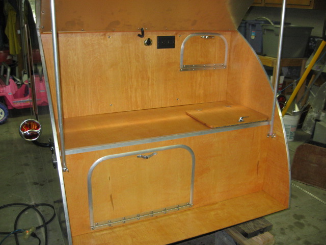

Got the cabinet doors finished and installed. I used aluminum piano hinges, aluminum t moulding, and vintage push button hardware.
I also got one of the doors hung. I still have to figure out how to install the latch properly.

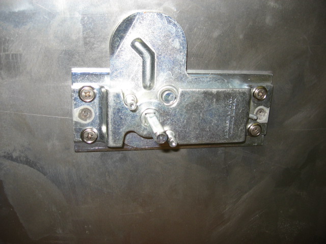

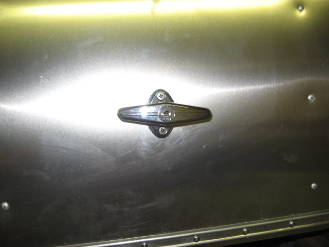

I also got the galley hatch handle installed. The mechanism is for a three point latch system but I only plan on using the two rods, they are not shown in the pic. There is also a homemade rubber gasket between the handle and galley skin.
