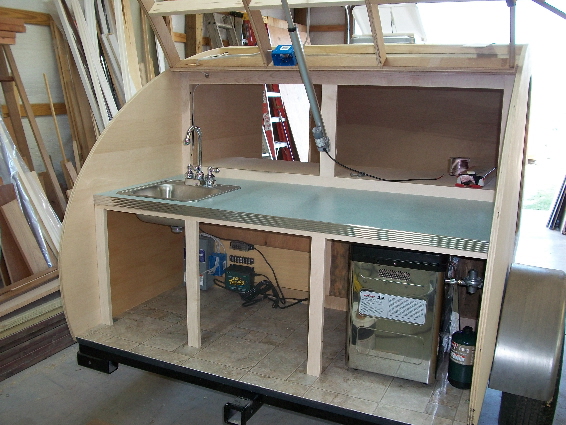

Got some more done Sunday
countertop glued up
ready to stick togather,I use venition blinds to keep the contact adhesive from grabing till parts are positioned
[img][img]http://www.tnttt.com/gallery/image.php?image_id=70937[/img]
completed top and face frame installed

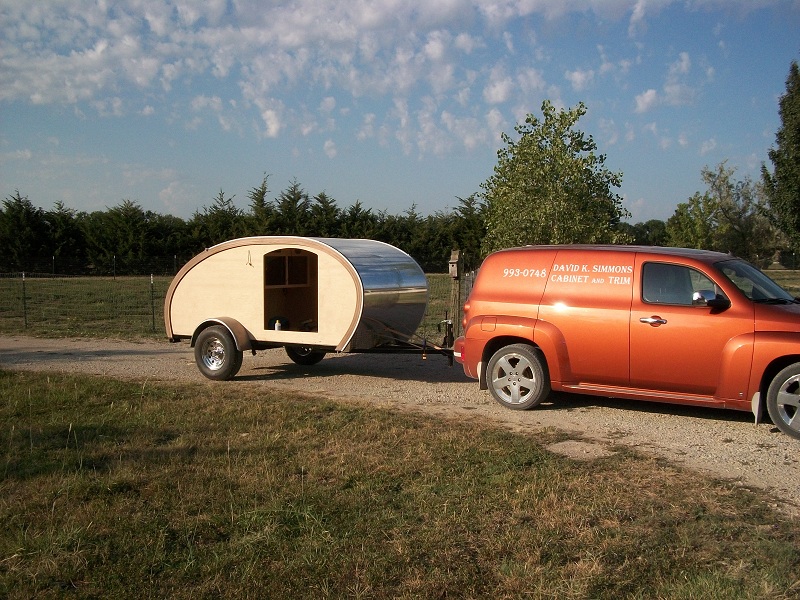

hooked up to the TV and out for some fresh air

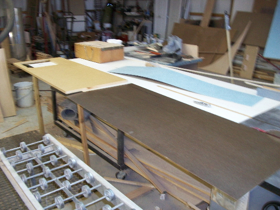

Postby David S » Sat Jun 04, 2011 10:20 pm

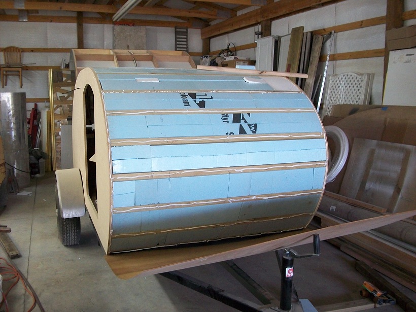

A few new pics- insulation in, skin going on.first pc of walnut trim glued
Image[/img]

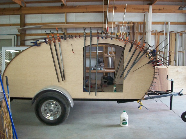

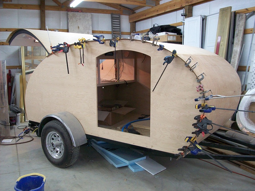

got some more done this week,laminating takes a lot of time and clamps
1st section of walnut glued up on drivers side

Postby David S » Mon Jun 13, 2011 8:46 am
Thanks droid_ca ,I can't wait either.
jkidd6339 I started out with 1 wide board,ripped to 1/4" strips.I let the pylwood of the roof skin hang over the sides an inch,that gave me something to form and glue to.then I glued 1 strip at a time,glue and clamp glue and clamp 12 times,then the belt sander to smooth it out.

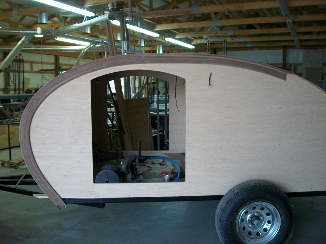

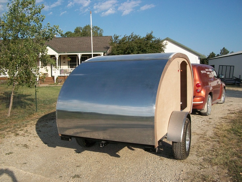

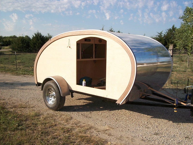

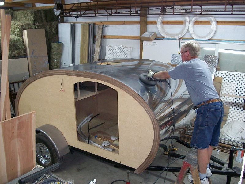

Postby David S » Wed Aug 03, 2011 2:57 pm
Got some more done even though the temps have been over 100 plus the last 39 days.
Got the skin on ( its floating )
Finished laminating the walnut curved trim.
I bought my skin from a surplus store and while it was not dented it did have some scratchs so I had to start with 400 grit paper and work my way to 1200 then hours of buffing.If I had to do over and still wanted the polished look I would buy new with the protective covering on it.
Will the polishing never end?
Out in the sun to check the shine
curved walnut trim is on (the sticks are just holding the deck plate temporarlly)
hooked to the HR
Image[/img]
In the pics the edge trim is white .It was the only thing I could find in town
I'm going to strip it and polish it to.I may regret that decision as well.
