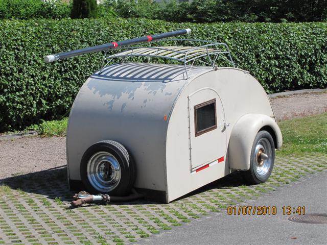

Postby Classic Finn » Sun Oct 10, 2010 5:12 am
Here,s a pic of the Kit as it was upon arrival. Notice the fenders and color on this.
The fenders have been totally redone, all rough areas and broken areas have now been fixed. These fenders were quite rough with chipped and cracked areas from rocks and what not. So here is a pic of before as it looked especially on the fenders, beige in color and shortly I,ll upload the after pics of the fenders all redone.
Inside has a special rock shield & preventive of 3 layers sprayed on. Color base coat & New black gloss paint. And 4 coats of clear. They look as though they came from the factory now. Im really pleased as how they turned out. :)
The frame itself will be here this coming week that has been bead blasted, galvanized and powder coated in color black as well as a modern coupling that is up to date so it can be towed with any vehicle here in Scandinavia or Europe. And safely.
New electrical wiring has also been installed. The wiring is a one piece kit that in Germany is called a Smart Kable with easy connections for those with hardly any electrical experience such as yours truly. :lol:

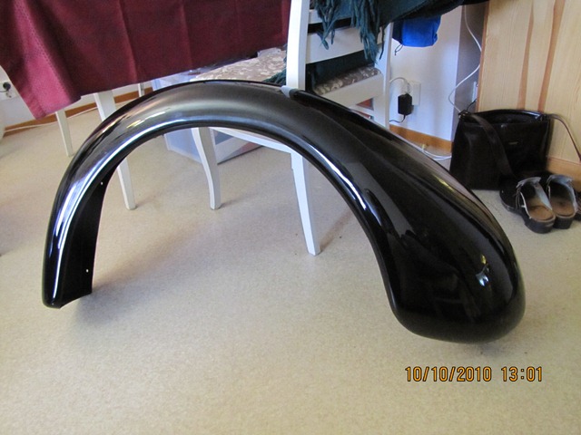

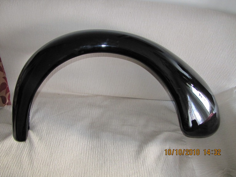

Postby Classic Finn » Sun Oct 10, 2010 6:13 am
Ladies and Gentleman here are the old new fenders from the above pic of the 47 Kit. :) :D Once upon a time they looked rough and wrong color in my opinion.
More pics shortly 8)

Postby toypusher » Sun Oct 10, 2010 6:30 am
Nice! :thumbsup:
toypusher
Posts: 43040
Images: 324
Location: York, PA Area
Postby Classic Finn » Sun Oct 10, 2010 7:48 am
toypusher wrote:Nice! :thumbsup:
Thank You Kerry :)
Classic Finn
Midnight Sun Voyager
Posts: 17488
Images: 146
Location: Country of Finland
Postby toypusher » Sun Oct 10, 2010 8:57 am
Thank You Kerry :)
I have a fiberglass set of those and hope to someday have a paint job that nice! :)
toypusher
Posts: 43040
Images: 324
Postby Classic Finn » Sun Oct 10, 2010 9:29 am
toypusher wrote:
Thank You Kerry :)
Kerry you and the Mrs cmon over with the fenders and we,ll have them done for you. We,d love to have you here. :yes:
