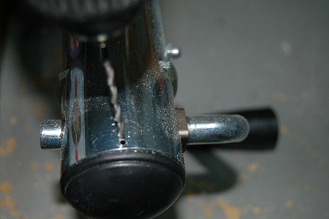

Tinksdad, I took you up on your suggestion to add a small set screw to keep the cap on the jack. I had a heck of a time doing it tho... I drilled and then put a small sheet metal screw and it broke off. So I drilled again and broke off another screw. It was one of those times when you quit while you can. I believe the screws will hold the cap on tho...

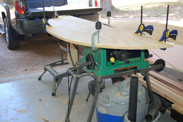

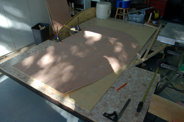

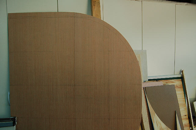

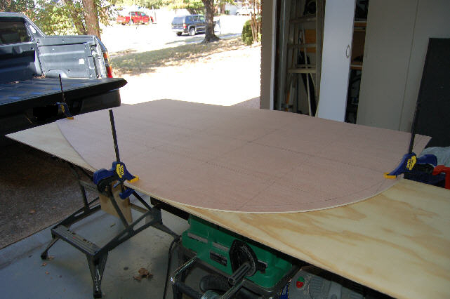

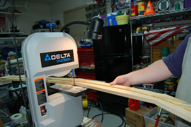

Here is the master template to cut 1/4 ply to make the front former for the trailer.
Two sheets of 4 x 8 - 1/4 ply cut at Home Depot lengthwise. Transfer the shape to 4 -2 foot wide sections and cut out the shape.
Placed all 4 sheets into a sandwich and use a jigsaw to cut the formers out.

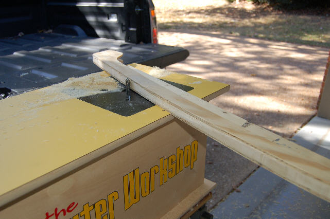

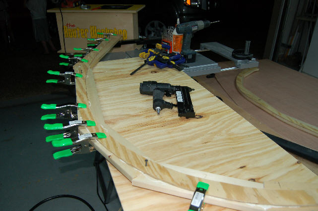

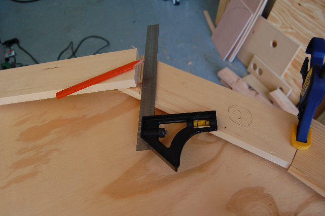

Layout 1x4s to be used as filler for the plywood formers and cut
Sandwich all pieces and glue and clamp and staple. Note the drywall screws are placed into drilled holes to maintain alignment on top and bottom plywood formers.

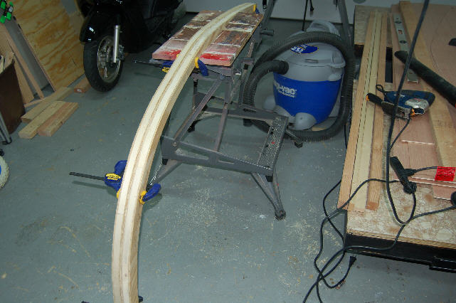

Using bandsaw to trim the extra 1x4 fillers between the formers.
Edge routing the remaining wood on the face of the formers.
Finally clamping the two formers and a little sanding to even up the two profiles.
These formers will be used for the front of the trailer and are amazingly strong!
Thanks for viewing!
CP

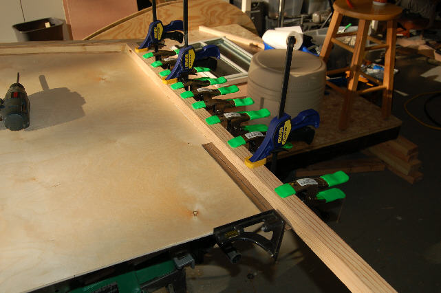

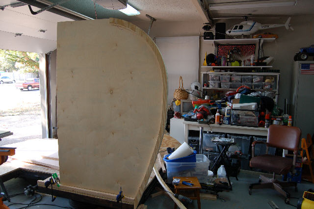

Now moving into wall construction... Cut a new panel from 1/8 Luan using the master sheet and glue the former to the panel.
once squared glue the base stud to the panel
Test fitting the panel and prepare to measure and square the window location and
place a stud horizonal for the support for the back of the seat of the dinette as well as two horizonal studs to frame the window location.

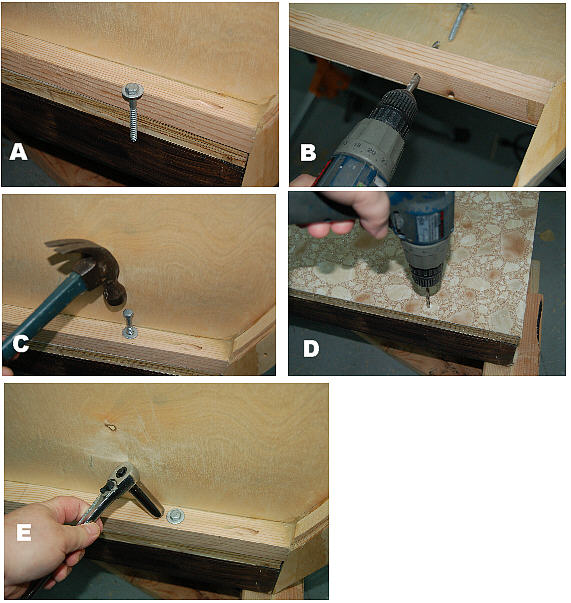

Here is an update to the wall attachment process.
I broke it down to show what I did, hope it's a good solution
A: shows a 5/16 x 3 inch Lag bolt. Looks like it will pass through the ply deck and into the 1x4 side.
B: Wall removed and 5/16 hole drilled from bottom up to get a straight hole that fits the lag bolt shank.
C:Place the wall back into place and use a hammer to tap marks into the flooring to prepare for drilling pilot holes.
D: Remove wall find marks and drill a 9/16 pilot hole as deep as the lag bolt length EDIT: Correction: use a smaller 3/16 bit
E: Wall back in place and a socket wrench used to screw the lag bolt tightly into place. I am placing one about every 20 inches.
Thanks for viewing!
CP

Cyclicpitcher wrote:D: Remove wall find marks and drill a 9/16 pilot hole as deep as the lag bolt length
CP
I hope you mean 3/16" pilot holes.
GuyllFyre
Posts: 209
Location: Scotia, NY
Correction
Postby Cyclicpitcher » Wed Oct 20, 2010 3:22 pm
3/16 is correct !! :o

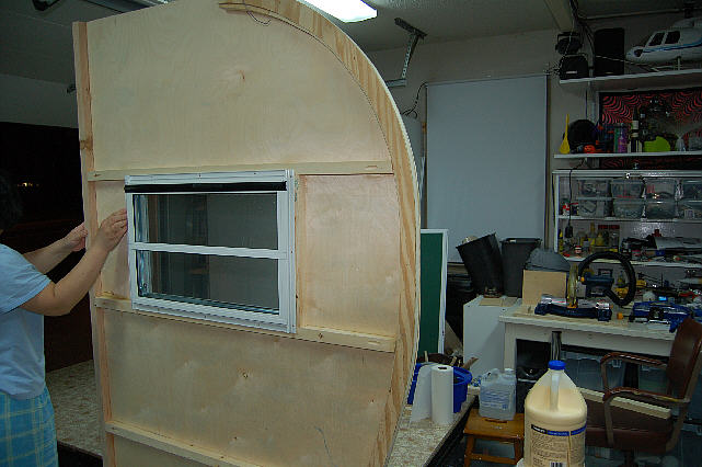

Things slowed down a bit as I needed to clean up my garage but here is a picture of a test fit of a window on the front wall panel section. I still have to build the right side matching panel and that will take a few days.
More pictures to follow!

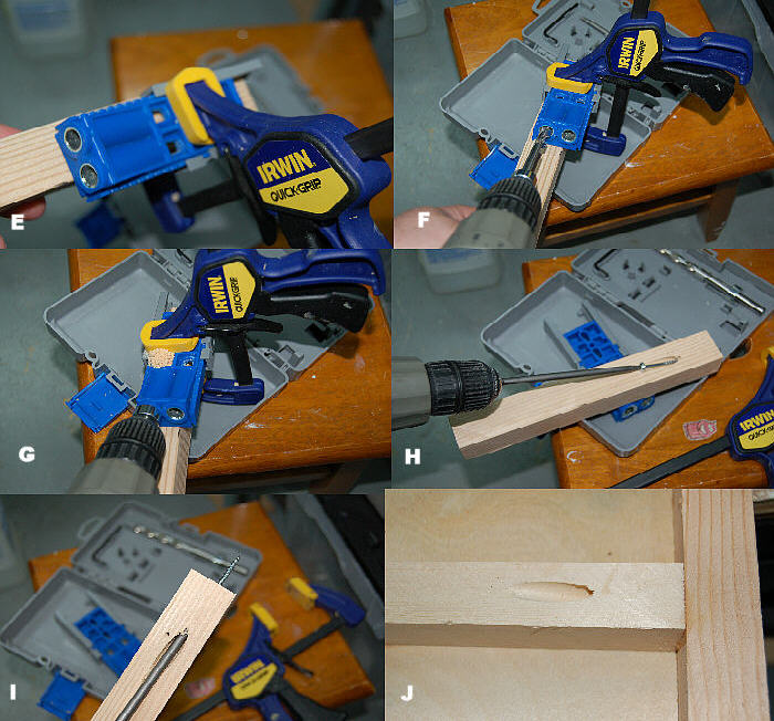

Postby Cyclicpitcher » Sun Oct 24, 2010 10:40 pm

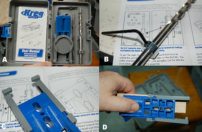

One tool that I am really impressed with and expect to use alot is the Kreg Jig Jr. It sells at lowes for about 40 dollars
A - shows the kit with the instructions
B - The instructions show that you set the collar on the drill bit to your depth recommended by the size of the wood stock you are joining.
C - The blue plastic guide also has a depth guide you have to set for the wood stock you intend to join.
D - The guide has two slots for using two screws on wider stock but for 1 1/4 inch wood studs I only use one slot.
E - I am using a common wood clamp however Kreg does sell a better all metal clamp for this part of the job plus the grey round thing is designed to work with the Kreg clamp.
F - Once clamped your ready to drill by setting the drill bit into the jig's drill slot
G - work the drill in and out to clear the sawdust and make a clean cut
H - Here I show how the recommended screw is set into place. The instruction manual recommends 2" Kreg screws
I - The kit comes with a long square head driver made for the Kreg screws
Notice how long the screw run into the joined wood would be
J - The final results is a perfectly bonded joint. Very light, very strong! Just like a pro cabinet maker! :twisted:

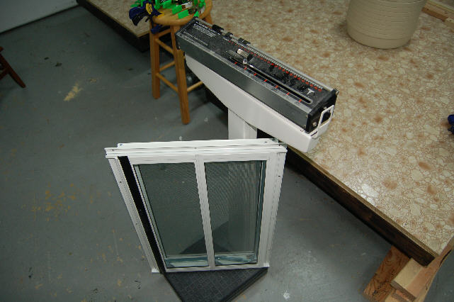

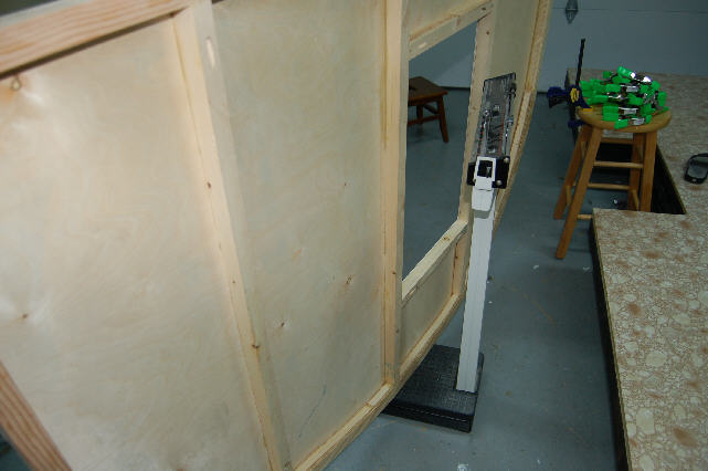

Quick note about the weight. Placed the front wall panel and a window on the scales and found out that the window weighs 6 pounds.
The main front wall panel weighs 22 pounds.
22 pounds plus the 6 pounds and say 2 pounds for foam insulation and 30 pounds per side is not too bad. Hard to project total weight but interesting to know... :thinking:

I like others here on this site use the Kreg Jig I have the K3 master and have used it for a couple of projects, a bunk bed set and a portable router table. while "they" say glue isn't needed I use titebond III on all the joints I started doing this after reading about it from a fellow Kreg user on the Kreg web site.
