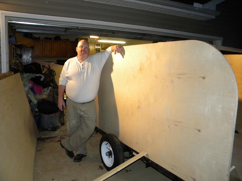

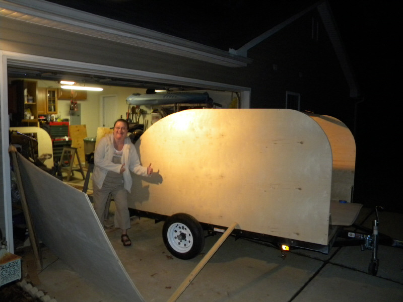

Well even though my beautiful wife was away for last several days, nothing got done til she got back! Work was crazy and then we had alot of rain so until this afternoon I really couldn't do much except clean up the garage some. Then after church I got home and got busy, and screwed a side wall up!! The cutout for the door was bugging me so I decided to straighten it out, yeppers cut it way to much and when I started figuring where the fender and the 14" wheel was going to be it was obvious I had screwed it up :oops: :cry: . Luckily I had an extra sheet of the ply I had been going to use for the cabinets so I repurposed it into a new sidewall! I clamped both sides together and sanded them down on the edges and cut the other side wall and did same. I then got them mounted on the trailer temporarily:
Side view
and my lovely helper
You may have noticed a couple of things: One no door cut out! Well after my screw up I decided I was just going to use the premade doors off the other tear but I don't want to take off til after the GA gathering by savannah in 2 weeks. Since it has radius's, I want the door to use to template before I cut.
Second not sure why but the back left corner in the first pic is off and not square, not sure why but was running out of time to try to fix tonight as it started sprinkling again and I needed to get it back in the garage and my tools pu back in my van before I headed to bed. Hopefully tomorrow I will start cutting cabinet pieces to get them ready to install this next weekend.

:o About your left, rear side being not square---you will want to deal with that first. :oops: You might get some jack stands under the frame and make sure they are level, not just the same height! Level diagonally! As in put a two by across and drop a level on it. ;)

Thanks all!! Aunti M the trailer is level as much as possible, what I figured out this afternoon is the left wall is pushd out a lil by the left wheel so I put a screw thru and ta-dah its good.
