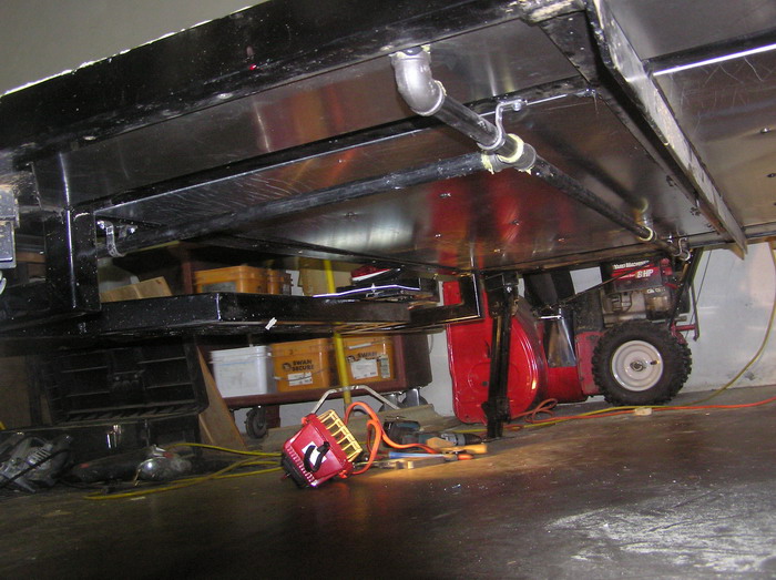

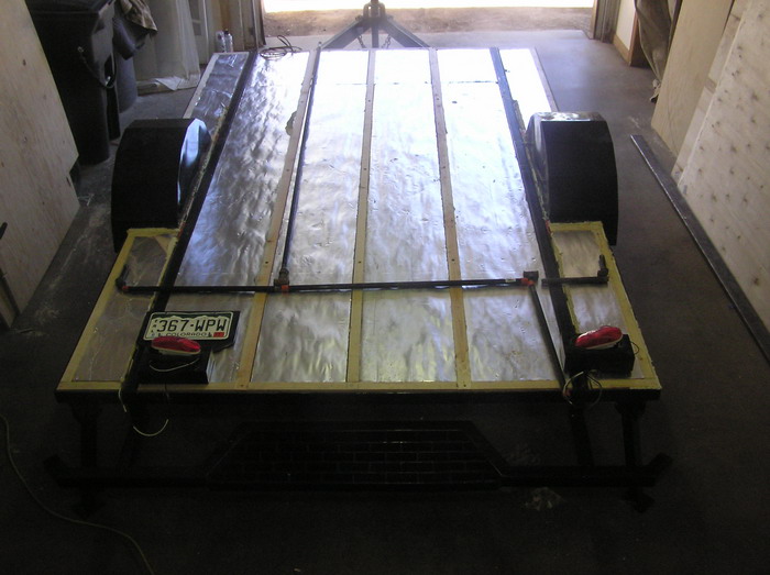

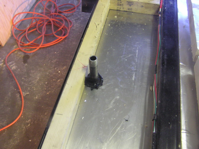

Moving on: Next up is installing the tail light wiring and the gas lines. You can see the tail light wiring following the main frame members and now I'm laying out the gas lines. My propane bottle will set on the trailer tongue, I want a catalytic heater on the drivers side rear, a cook top on the passenger side rear and an outlet out the back of the trailer so I can move the cook top out doors. So here's the layout:
And here it is installed:
And from underneath:
And from the rear:
CONSISTENCY!!!!!! It's only a good thing if you're not a screw up.

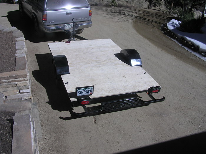

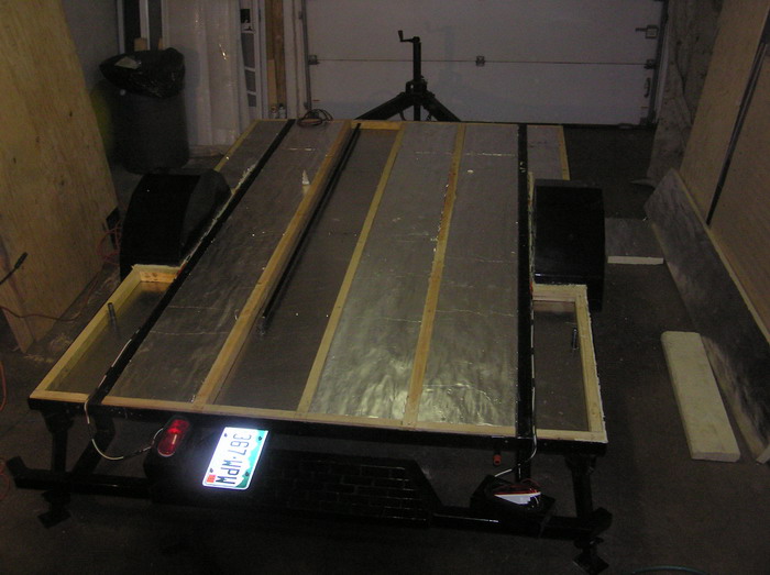

Postby tsmiley23 » Thu Mar 03, 2011 7:46 am

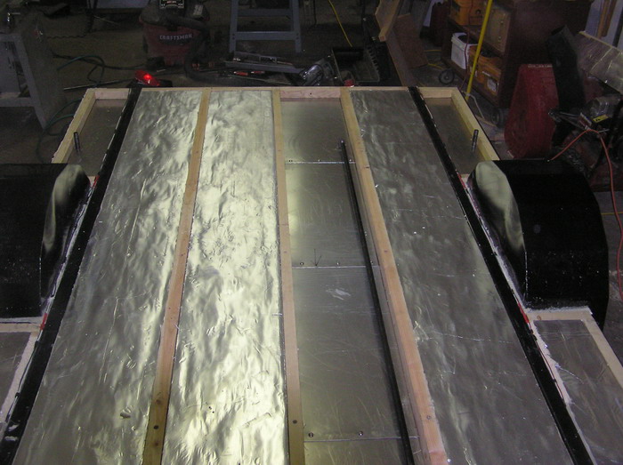

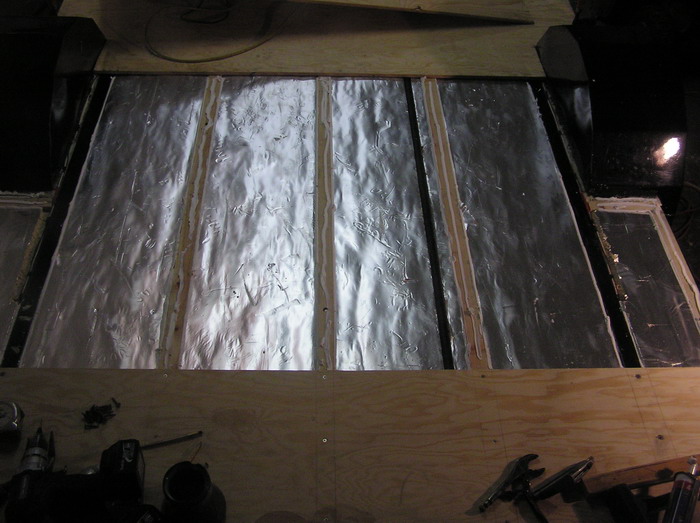

Next up: The 1/2" plywood floor, and attaching the walls to the top of the fender wells:
Floors all done:

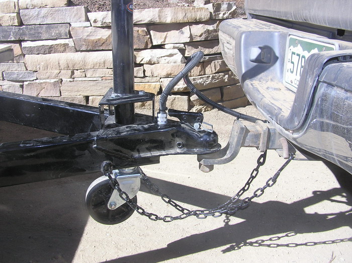

A gratuitous shot of the hitch with wiring:

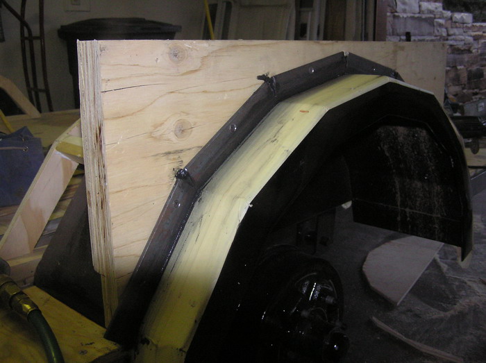

And now to attach framing/siding to the wheel wells. I decided to attach a 1 1/2" x 1 1/2" x 3/16" angle iron to the top of the wheel wells using 1/4-20 tapped machine screws. This will give me a great place to attach my siding and framing for the over build. This joint is sealed with "Dow 795":
And the plywood/framing is attached through the angle using wood screws:
Here's the framing:
Now the detailing is done, let's build some walls :D

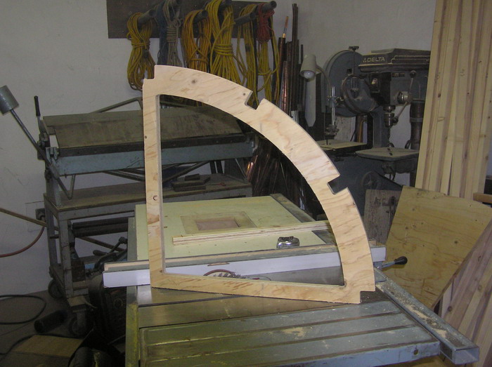

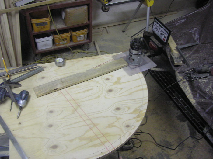

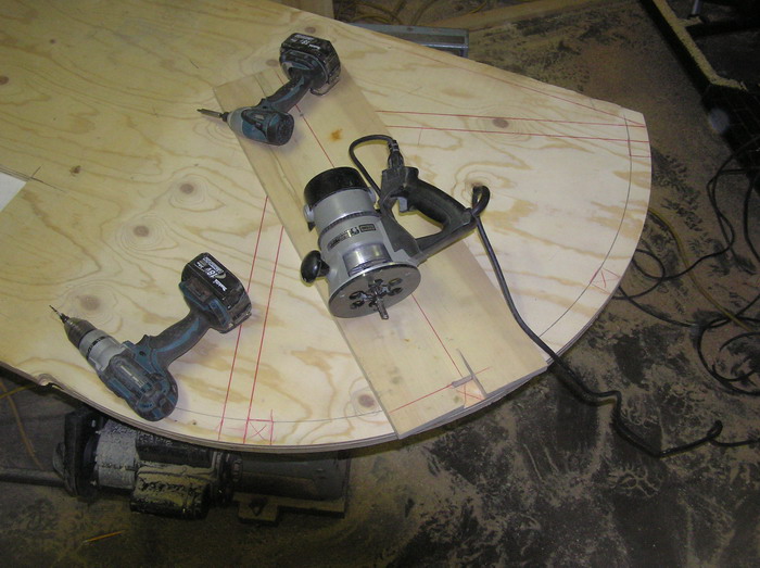

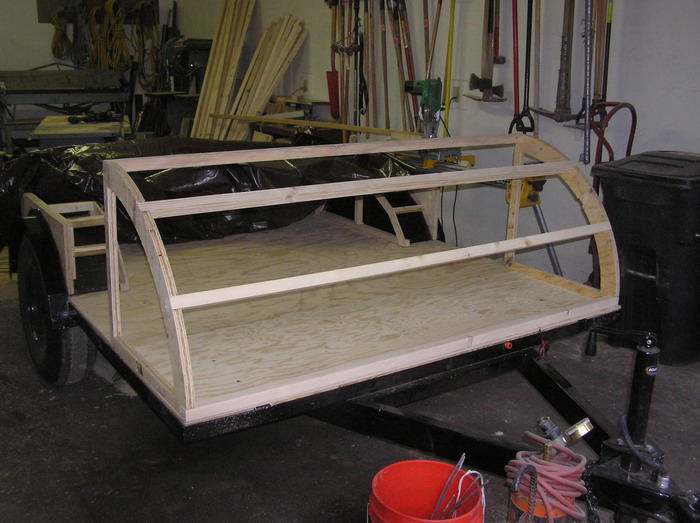

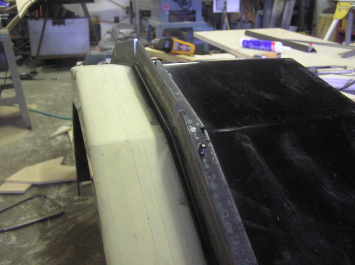

Thought I'd start with my only curved section, that way I can build to it. This may be a bit detailed, but I hope some of you enjoy???? :o
This is the radiused top front of the trailer. I began by laying out the desired radius with a compass and cut it out using a trammel attached to a router;

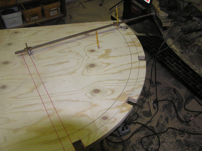

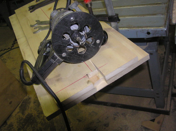

I then laid out my spar locations so I could route out notches for them in my pattern:

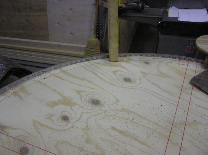

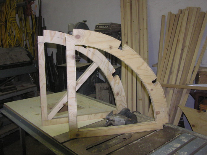

Here I'm making a new pattern that I'll use to cut out the spar notches
Here it is attached and ready to use:
The result:

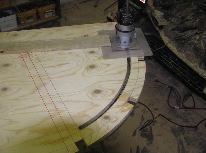

And now to set up and cut out the inside:
The finished pattern:
The one in front is roughed out using a jig saw, the next step is to screw the pattern to it and make a matching set;
And the final result;
I'm real happy with today's effort, next I'll add some more bracing, nailing blocks in the middle and soon I'll be ready to build walls under it 8)
