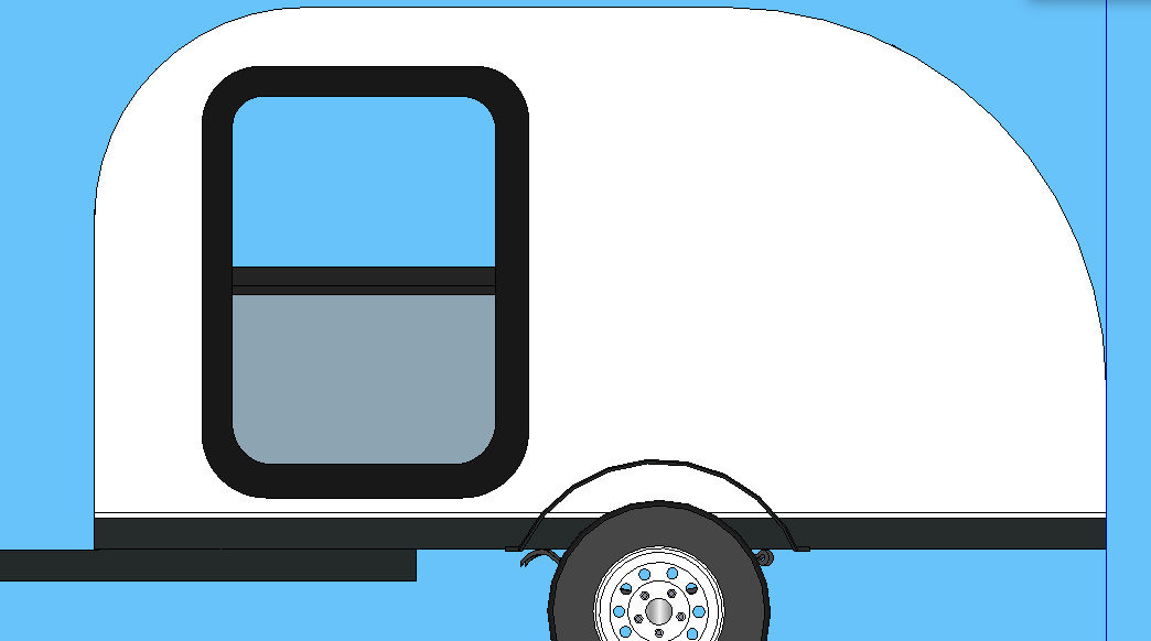

I cut my sidewalls with 20" radius in the front and 36" radius in the back. They were easy to layout with string. I used Sketchup to compare various Benroy sidewall radii and checked other designers profiles. I even looked at 1/4 ellipses of various sizes but was worried about ease of accurate layout.

Modified Benroy profile
