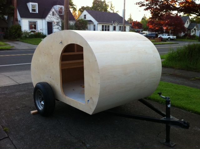

Postby jdaan » Fri Jun 03, 2011 5:25 pm

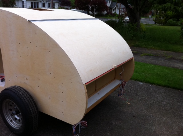

Haven't had the chance to do a lot lately, but did get the outer plywood skin on. Now time for the dreaded hatch and doors...

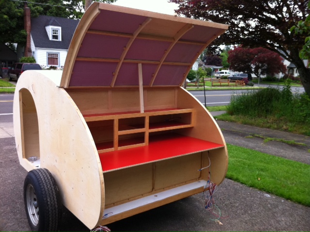

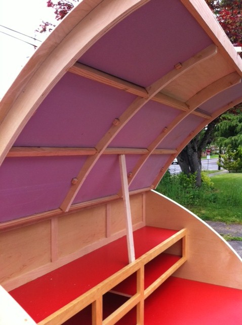

Worked on the hatch this weekend. It's nearly finished, just need to install the latch hardware and inner skin. Here's a few pics:
I still need to cut away a little from the sides for the gasket. I also need to build a second hatch for the bottom. I'm still having a tough time envisioning how the two will come together at the counter. It needs to be waterproof, look good with just the top hatch open, and good with both closed. I think if I just keep building, the answer will become clear. We'll see.

Postby DMcCam » Wed Jun 08, 2011 10:27 am
Hi Justin, I just love the curves of your teardrop! When I saw how perfectly your hatch fits it brought a big smile to my face. Thank you for sharing. :applause:

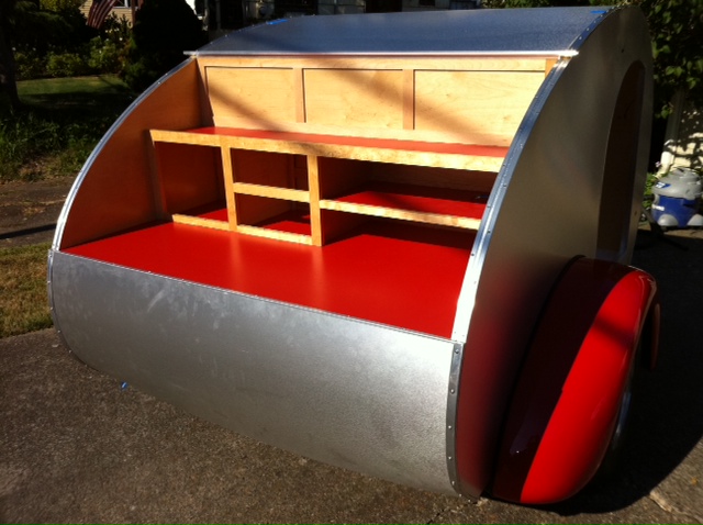

Postby jdaan » Sun Aug 21, 2011 9:07 pm

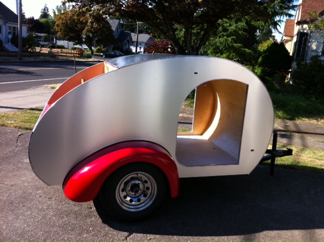

Finally got some work done this weekend. Decided it was time to tackle aluminum. I was pretty nervous, and with good reason. This was the most nerve-racking part so far. A lot of little mistakes were made, but it's on and it looks ok. Put a fender on temporarily to see what it would look like.

Postby CliffinGA » Sun Aug 21, 2011 9:13 pm
Wow looking very nice Justin, just love the look with those fenders on.

Postby 2bits » Sun Aug 21, 2011 9:50 pm
That is a great looking teardrop! I see you have aluminum on the area below the counter top. I was going to suggest a hinge om the bottom, but it looks like you're found your solution for that. what did you end up with?
Again, great looking build!!!

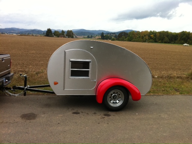

Postby jdaan » Sun Jan 08, 2012 3:16 pm
It's been a long time, and not much progress. Too cold to work in the garage. However, I did take it out on it's first test drive a few months ago. Exterior needs a little more trim and a few lights, interior still needs a bit of finishing, need to build a tongue box, and a few other things, but it's getting close. Pulls beautifully.
I ended up ditching the second hatch below the counter. Too much engineering. Instead, I made the panels in the frame and panel wall at the end of the bed removable, allowing me to access the electrical below the counter from the inside. Not sure why I didn't think of that from the beginning.

Postby Oldragbaggers » Sun Jan 08, 2012 3:41 pm
I really love this teardrop. You have done a fantastic job. And I really like your solution to the hatch. Can you access the space under the galley counter from the outside or is this "footroom" on the inside only?
The profile is cute as can be and the fenders look perfect. Very very nice.
