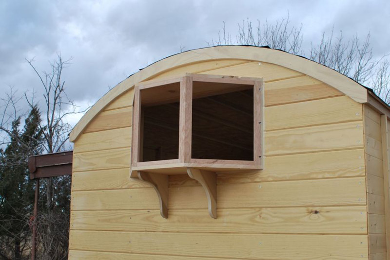

Ive got an idea of installing a window air conditioner in the rear above the tongue box/galley like this Image but make it the dimensions of the air conditioner.

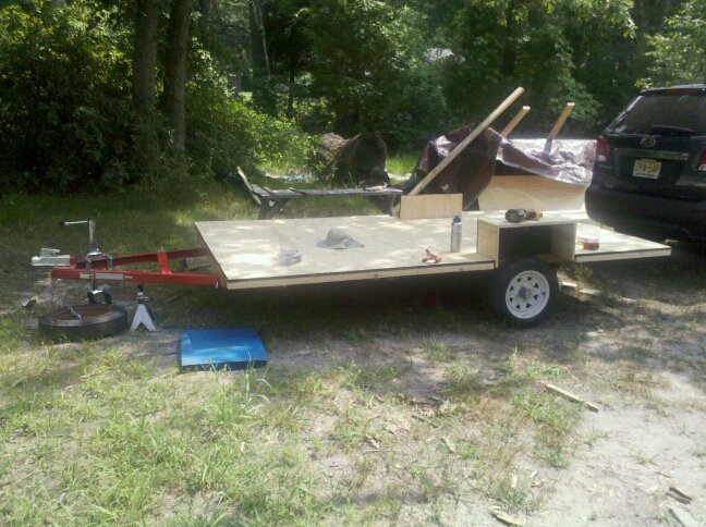

Postby Deryk the Pirate » Sun Jul 24, 2011 11:05 pm
Well made some sawdust this weekend despite the 104' temps on saturday
Ive decided to squeeze the bed in widthwise on top of the wheel wells, Im not gonna cut the hole so large on the walls. I ran out of titebond 2 and didnt feel like driving as far as I would have had to to pick up another gallon...next weekend. Have to tar the wheel wells when Im done and add a few more bolts for the floor to the trailer.
On sunday afternoon the sky opened up... Image

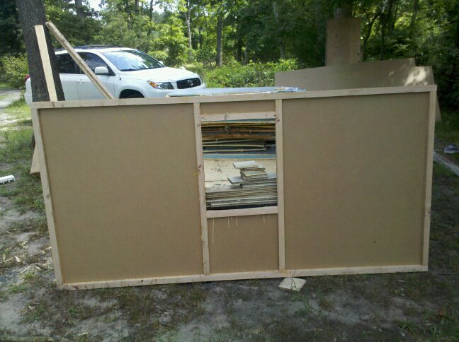

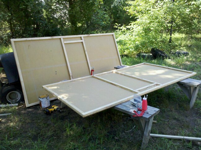

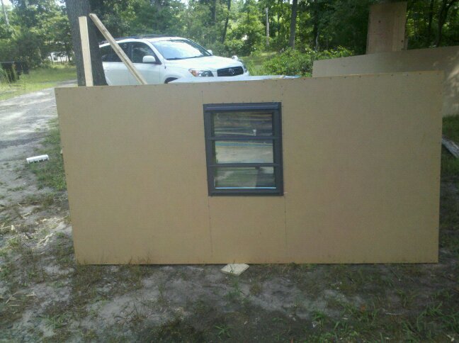

Well another scorcher weekend. Due to poverty Im stickin with my original plan the cabin is gona be 6x8 with the galley on back. Image Image Image

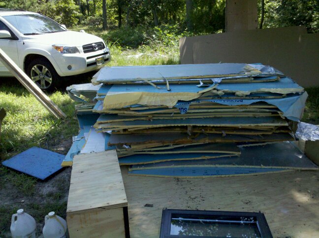

Also got lucky and found someone throwin away foam insulation Image

Nice "Fred Sanford" on that foam. :lol: Wish I'd found that much. That will work great. In my case, most of the slabs were cut into smaller pieces for installation anyway.
