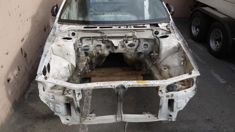

Postby queeg9k » Mon Jul 18, 2011 11:48 am
Picked up the donor car!!! the front end was lighter than I expected, two people can pick it up no problem. Will get even lighter when I cut out the front horns and radiator suport.

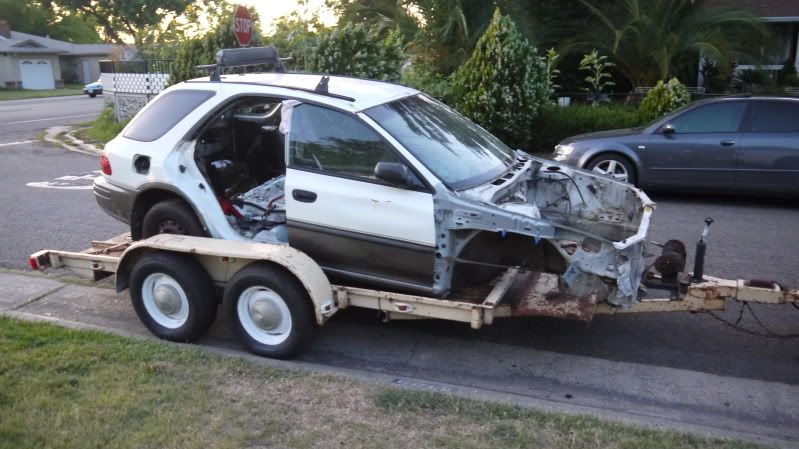

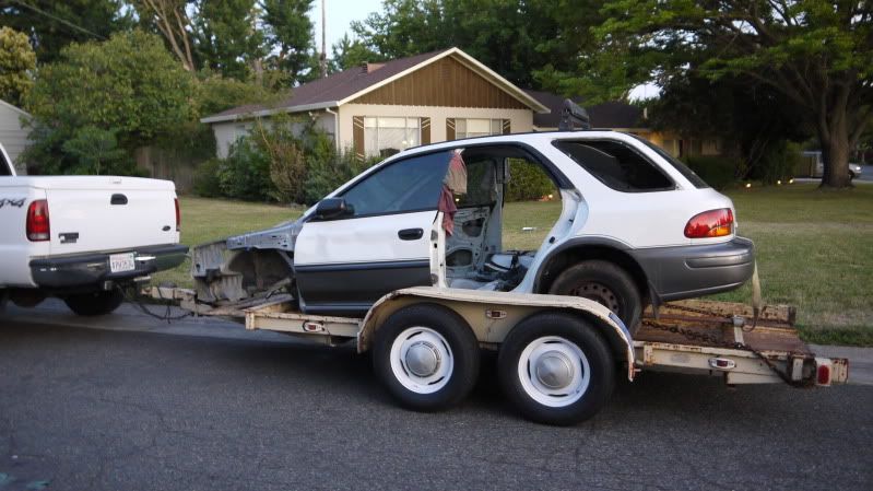

Postby queeg9k » Tue Jul 26, 2011 10:52 pm
It is in its new home!! Not for long I hope, next summer seems feasible.
