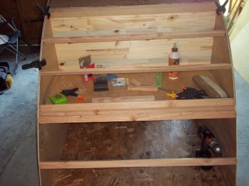

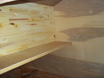

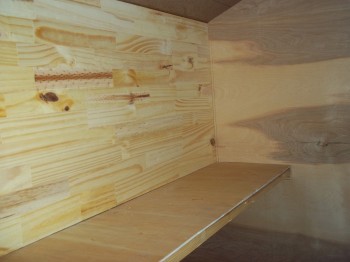

OK..Brief update on the "78" ..Skinned the galley/cabin shelf top. single piece of 1/4" 30 x 41..Then installed the galley bulkhead(upright back)..Solid piece of 3/4" 18 x 41..fit like a glove.. :worship: squared it up and screwed it in..Pine is so much lighter in weigt than 3/4 inch ply..easier to work with(JMHO),looks better..TIP* you can buy pre glued,3/4" wide pine boards at the box stores..All the way up to 36" wide by 8 feet.. 8) So, the spars are in back to the galley hatch and the ceiling liner in the cabin, galley top, and bulkhead..All installed this week..Neighbors want to know when it will be finished..lol.. They think it takes too long.. :lol: They don't get it. Americans have become used to buying plastic junk.Buy handmade crafted tears, Quality is long remembered afer price is forgotten.. :thumbsup: .Danny

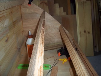

:twisted: OK, the hatch is done except for skin.. I think I will take some pix tomorrow while all the spar(e) ribs :D are showing..The tear needs to be skinned and, I need to select a color for the top(leaning towards deep forest green with clear gloss woodie sides),maybe gloss black top :? :thinking: ..

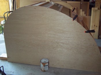

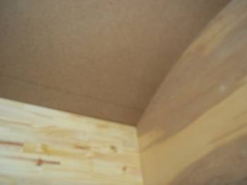

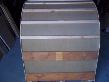

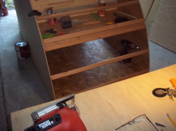

'NEW PIX"
Postby Danny » Thu Aug 18, 2011 8:39 pm
Da PIX 8) ImageImageImageImageImageImage
Danny
Posts: 333
Images: 108
Joined: Sat Oct 07, 2006 11:22 pm
Location: Nebraska
more pix
Postby Danny » Thu Aug 18, 2011 8:43 pm
8) ImageImageImage :D

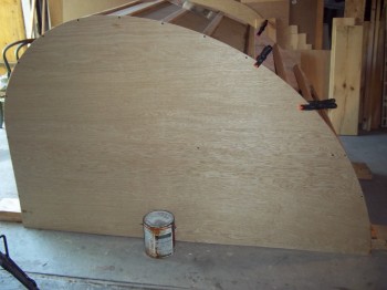

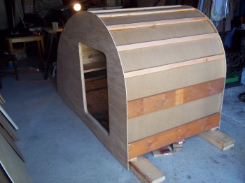

OK, skin is on back to hatch.. will skin hatch and below hatch at rear of tear this weekend..All for now..

Postby Danny » Sat Aug 20, 2011 11:00 am
8) Hatch is now skinned glued clamped and drying..Trying something different(not new) hidden hatch hinge.. so far, it is working well..Still I kind of like the hinge out, I don't know :?

Postby Danny » Sun Aug 21, 2011 4:49 am
aggie79 wrote:Danny,
Your teardrop is coming along nicely. Have you taken her outside yet?
Danny wrote:Trying something different(not new) hidden hatch hinge.. so far, it is working well..Still I kind of like the hinge out, I don't know :?
You have our attention. We're awaiting pictures of this detail.
Take care,
It turned out well, I ended up adding one more spar(turned flat) right behind the hinge spar of the hatch. this was done to allow a inch and a half glue area (gorilla glue), then the hinge being already installed, allows silicone on the hinge plates to adhere to the skins.. so, gorilla glue on everything except where the skins meet the hinge..clear sealant works well and is absolutely waterproof..Care must be taken to get a good heavy bead BUT, do not let any sealant get on where you will paint or stain...Tom, your tear looks very cool..nice fenders..that gray hammered finish on the cabinets, was that done with a can?
