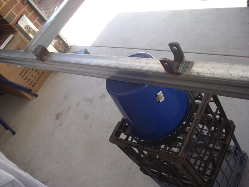

Managed to fix the spring hangers to the frame and sourced a bit of 6mm checkerplate to make some gussets for the front cross member. I did this as I cut the RHS and bent it in to create the draw bar and as such this area needed reinforcing

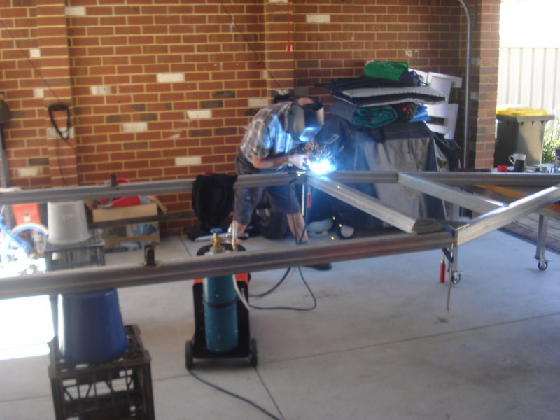

Here is the old man getting Miggy wiv it! :dancing
and here is the high tech welding stands. I knew those buckets from Bunnings would come in handy one day :eyebrows2:

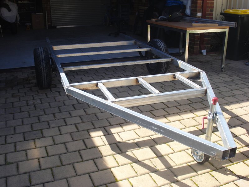

A little more achieved today
Cross members welded in. Wheels on, jockey wheel on and it looks like a trailer!!!
Just need to finish the back, weld on some lugs to fasten the wooden floor stick on some plate to attach the coupling, find, buy and instal lights and fenders then clean, paint and register!!!! :fb

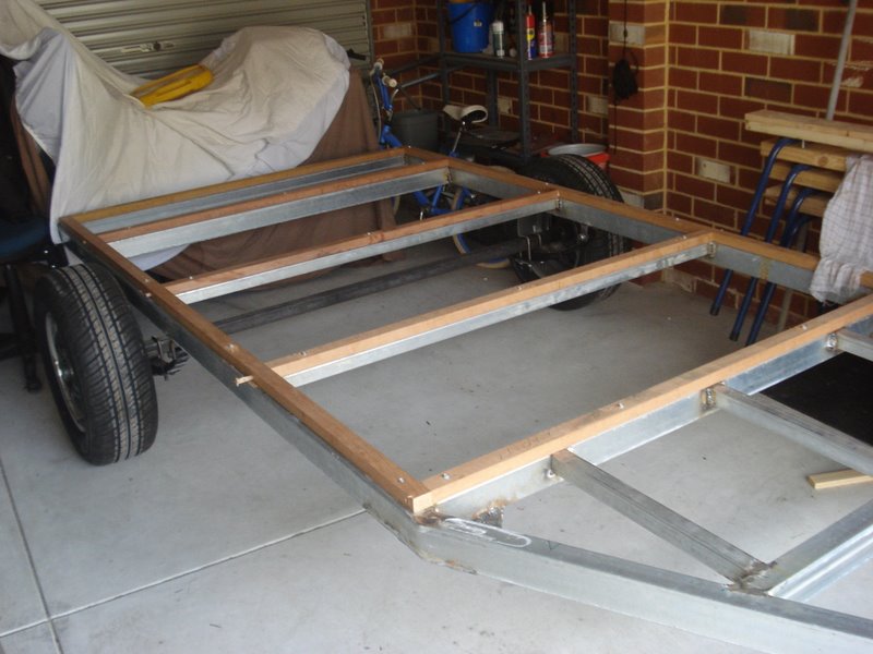

Now the trailer is built (or twailer as my ex mother in law calls em!) I have had cause to reflect on the original design and radically revise it. The major issue is fitting it into the garage
As such I have now come down to a more classical TD design
If I am completely honest this is the 7th redesign !! Yikes… but it is the best in terms of aesthetics and functionality, in terms of meeting my needs

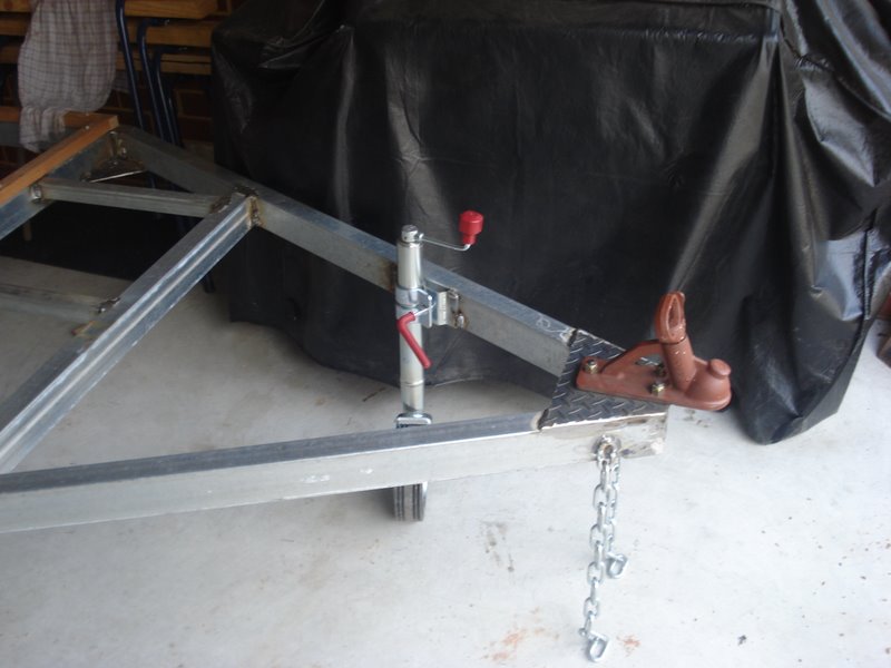

On a brighter note we got the coupling on and the chains
