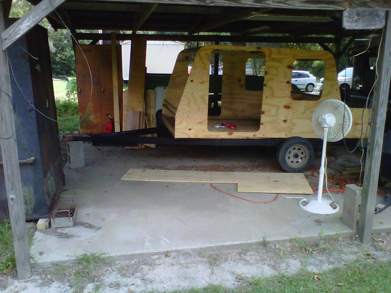

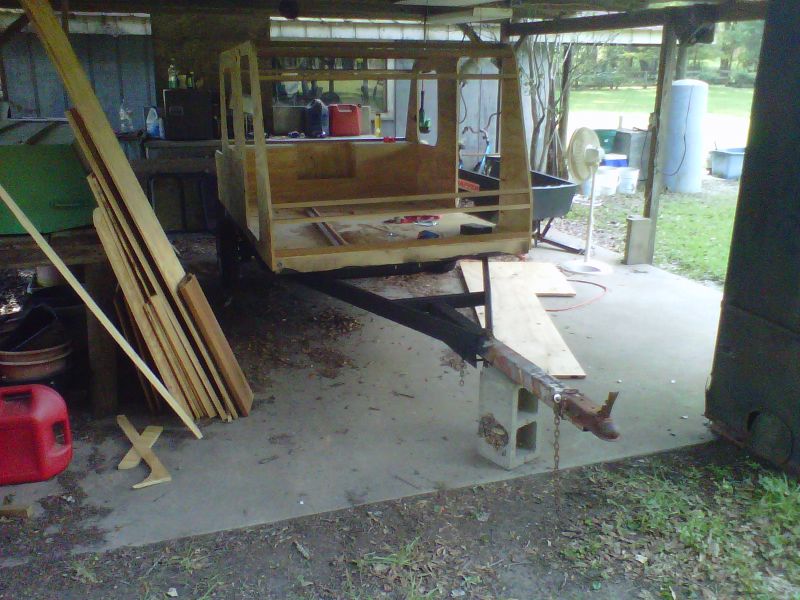

well I bolted the floor to the frame with 5" carriage bolts and right now I have the walls screwed to the floor with 3" drywall screws but will replace with countersunk carraige bolts before I skin it.

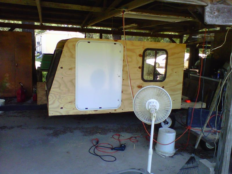

Woodstramp- as far as privacy some 5% window tint should take care of that. The doors I got off of Ebay from a seller named bottomdollarsurplusinc
they always have alot of surplus and salvaged rv parts and they are usually pretty cheap!!!
Cliff- The name was her idea
I think I'm going to order a set of teardrop door handle kit off of ebay to replace the keyed lock on the doors still will keep the thumb locks for added security i think.

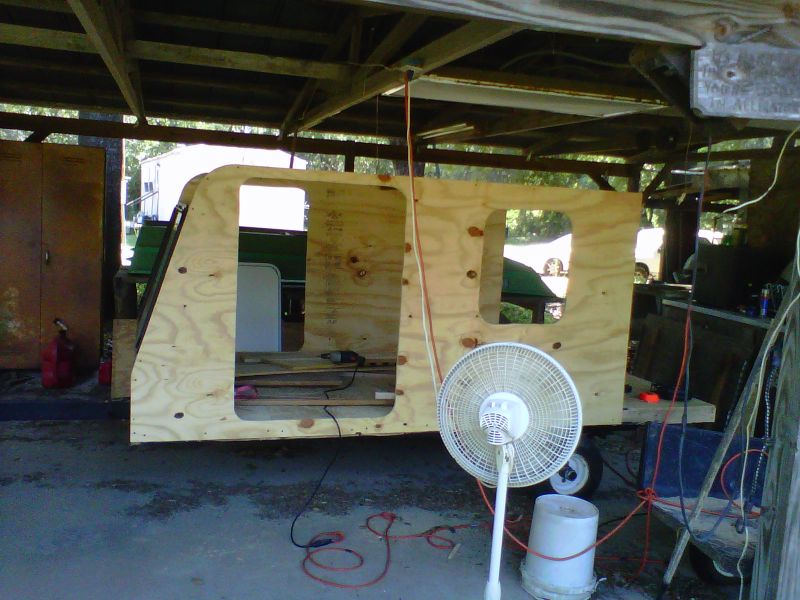

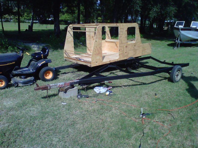

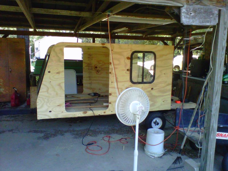

Time for an update and to show why I the shape changed into what it is.

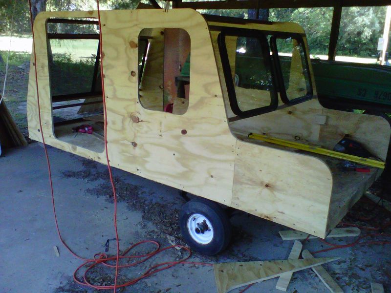

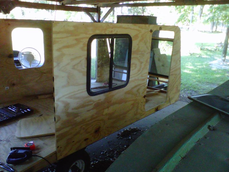

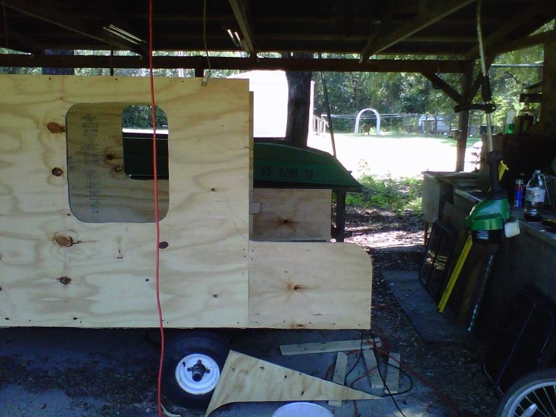

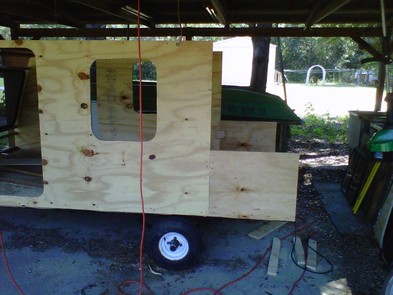

temporarily got the sides scabbed together to start getting the profile finished

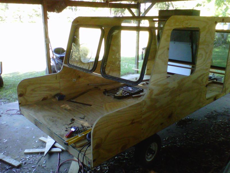

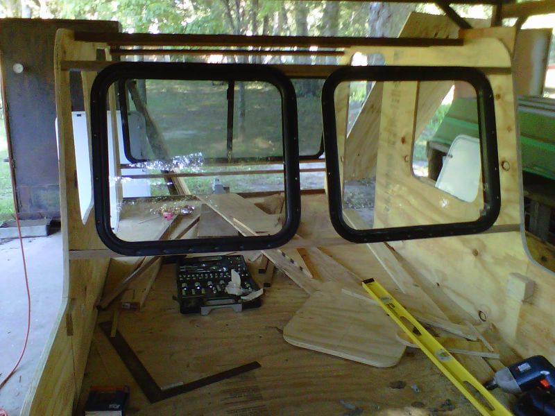

Test fitting the back windows to "fully complete the Room with a View"
I could have saved some windows for my next build but since these didn't open I figured I would still need more anyway, so I used them all on this trailer.
The back lower section is going to act like my galley counter top with a permanently mounted sink and space to set my cook stove.

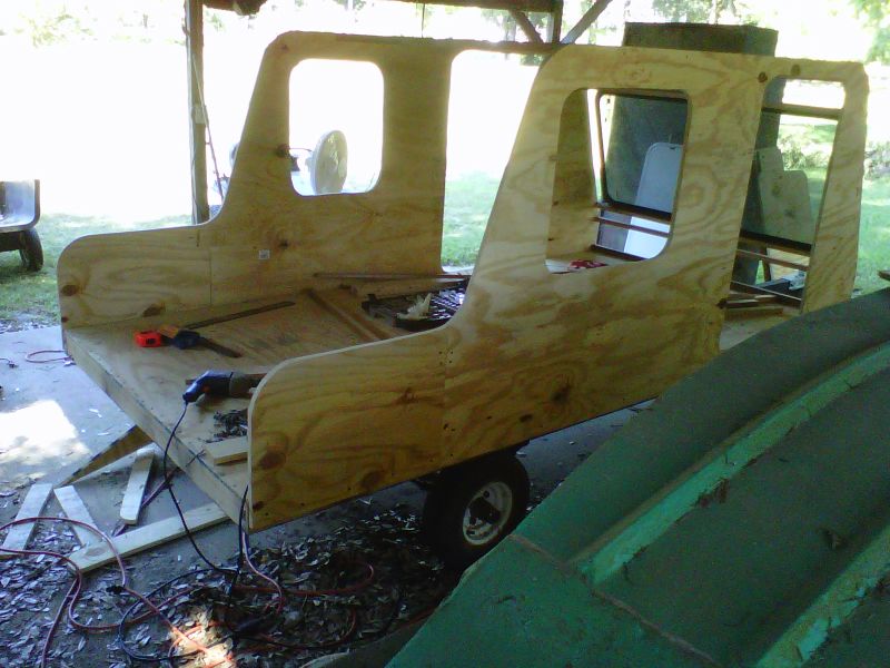

ok new update lots going on.

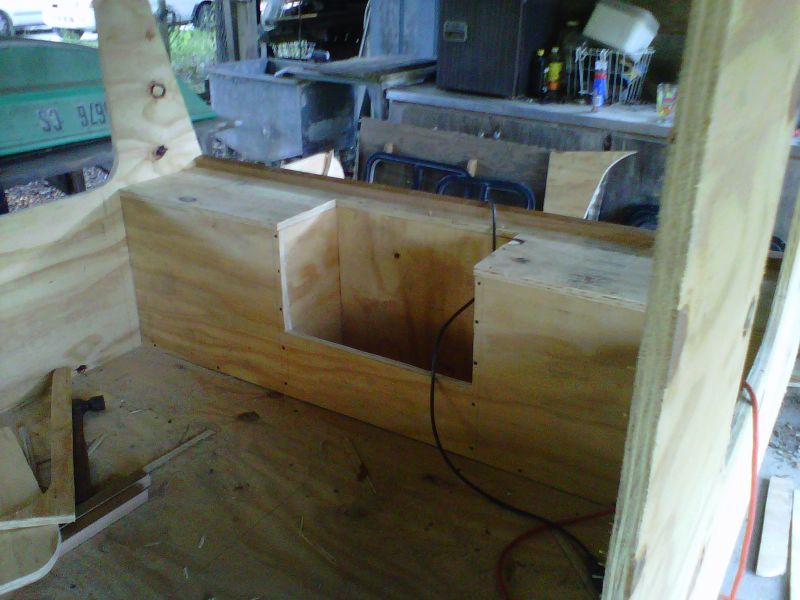

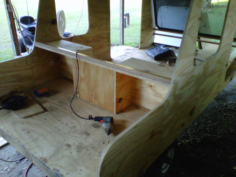

I got the bulkhead wall partially built.
Nothing is glued yet just held together with screws right now.
The cut out is for the a/c which will be vented through the floor in the cargo area.

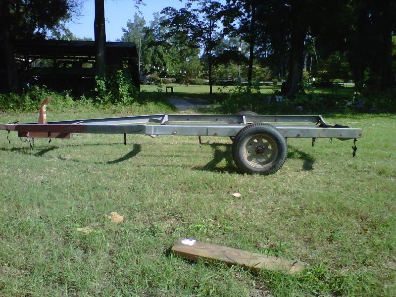

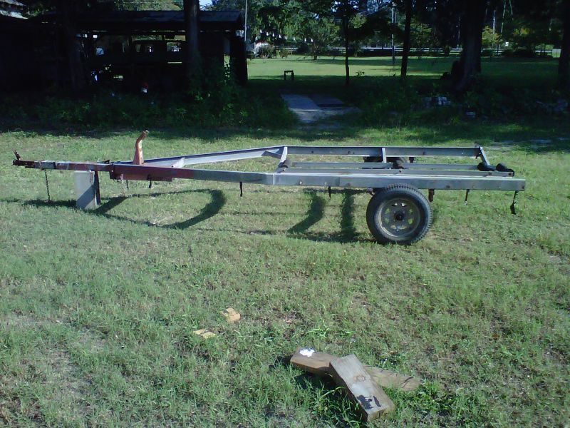

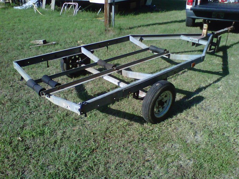

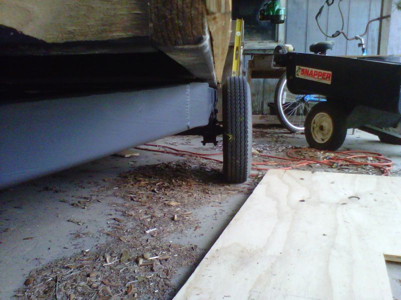

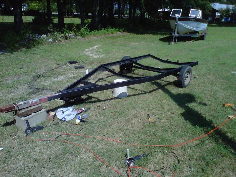

Ok the newest update is I have been worried about the trailer I was building on was too small, so yesterday I did some wheeling and dealing and came home with a new bigger trailer, It has a heavier axle, is 61" wide (which my build is 62.5" wide) and is longer and also has bigger wheels.
So today was spent prepping, painting and transferring my build over to the new trailer.

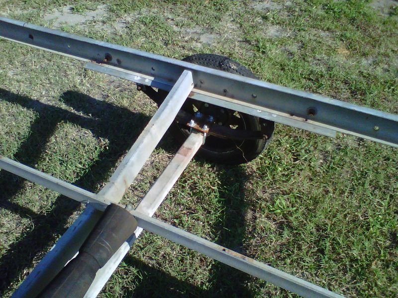

The axle originally rode under the springs but after a quick axle flip It's now a lowrider

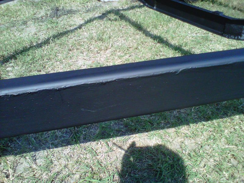

After alot of cutting, grinding, sanding and painting she's ready. I painted it with two coats of black rustoleum spray and then two coats of tsc black beauty fence and barn paint. I haven't painted the tongue because I still need to bolt down the tilt mech. and put on a new receiver hitch and probably cut the tongue shorter.
This is how the tsc paint dries with just a brush. I like this stuff!
To transfer it over to the new trailer I just unbolted it from the old trailer picked it up and slid it over to the new trailer. What ya think about my tow vehicle ?

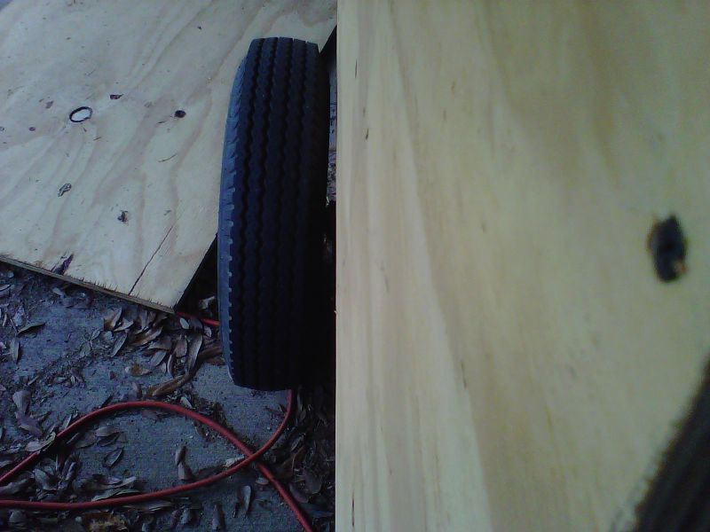

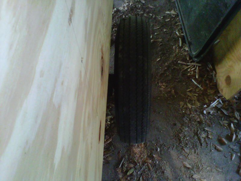

If one of you expert's would chime in here and help me out, I would really appreciate it. Is that enough clearance between the tire and the wall?
I have about 3/4 of an inch between the tire and wall.
