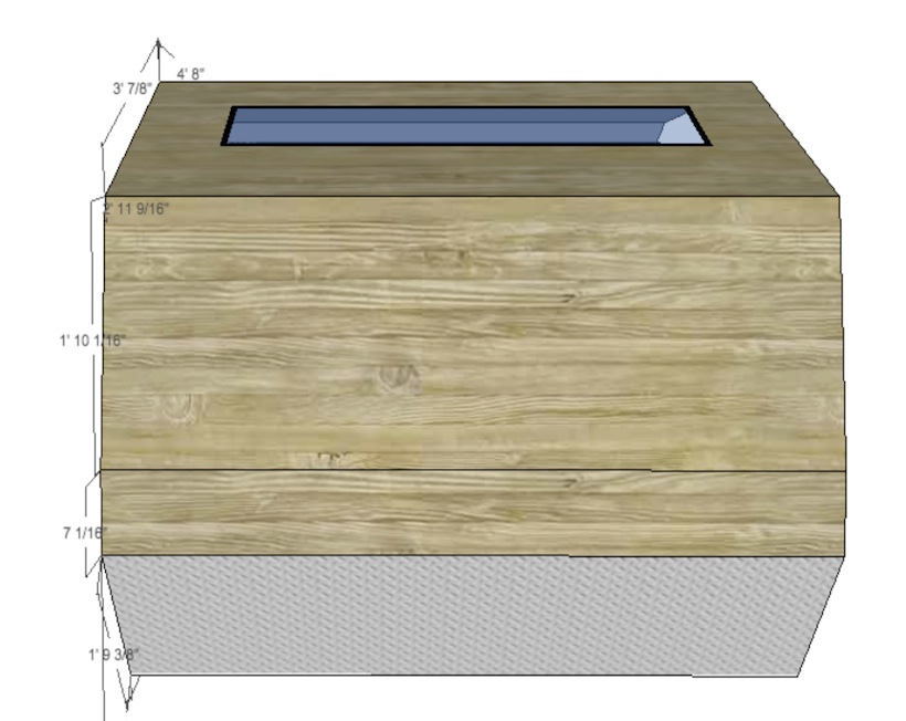

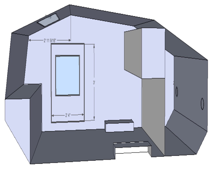

Well I was going to make up nd frame the walls as I go but decided to use plans instead. I got scared. I used Google Sketch Up (awesome by the way) and this was the first time I used it. Really wasnt that hard once I learned the orientation. I use a estimating program for work that is basically CAD oriented.
Check out the profile and let me know of you think it will work. I also included some of the outside dimensions as well. I believe this will accommodate the Jeep very well.
Here is the front. There is also a skylight on the top kind of over the door.

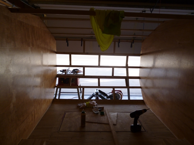

And here is a shot of the interior view. i didnt fully complete it but I think it looks good.

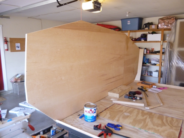

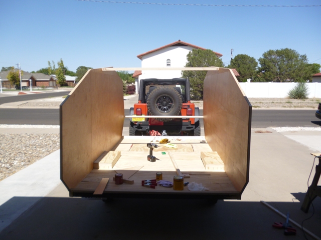

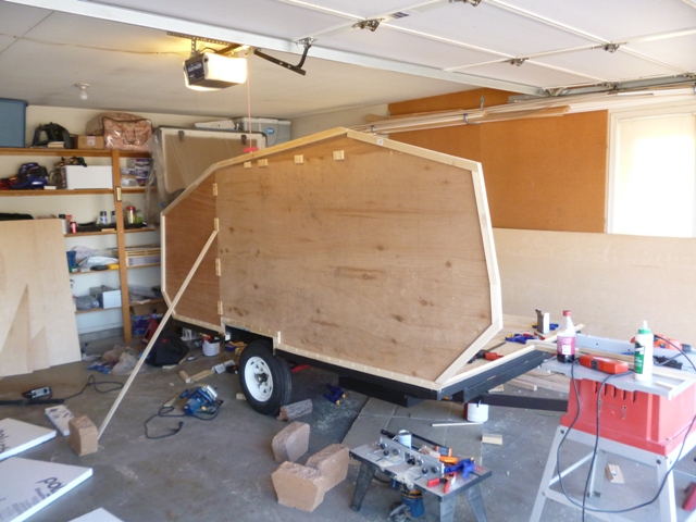

Well I took a couple of days off to work on the trailer before I go out of town for a while for work. I used my sketch up diagram and laid out the lines for the profile using sketchup measurements. Here is a pic of the first wall.
I also came up with a name for the trailer. The Roaming Gnome! Its kind of catchy, hope its not taken :worship: Here is a pic of the gnome my wife and I are going to use on our travels once I but one.

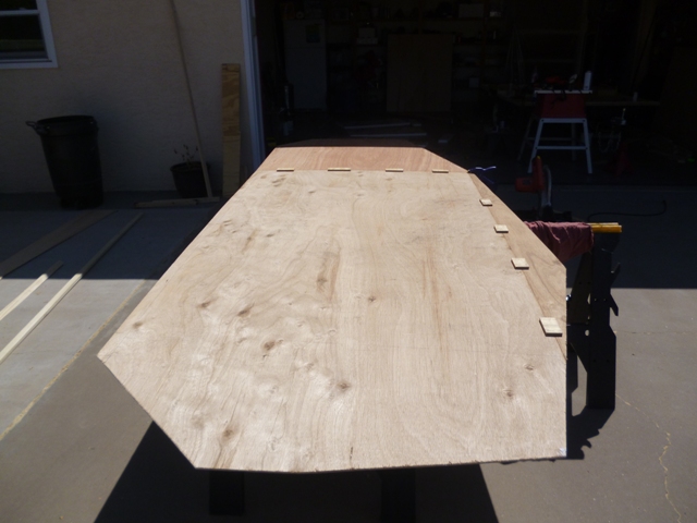

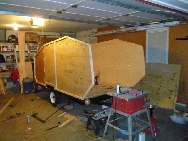

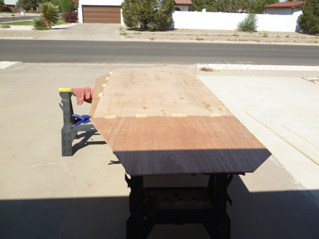

The first wall took all day to plot, cut out and lay the frame around the perimiter. Measure each one 5 times before I rounded up the courage to cut it out. Once it was cut and framed I I placed it on the trailer frame and it matched perfectly. Since I really had no one to bring over to show off my accomplishment I sent pics to my dad, :) .
here are a couple of pics showing the first wall mocked up.

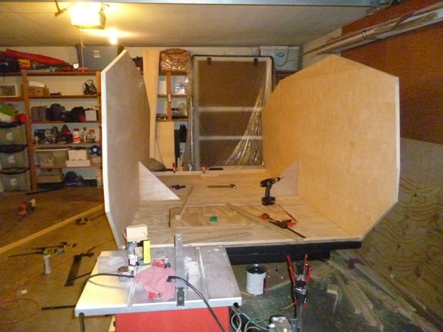

Once both walls were cut out i had to event the trailer out a lil bit with the help of my neighbor and we got both walls to match perfectly. By this time I was very impressed with myself. Here is a pic with both walls up.

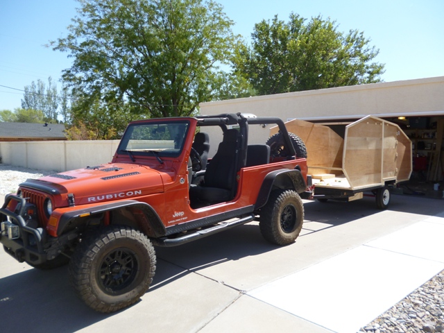

The next day I hooked it up to the jeep ansd pulled it out of the garage so I could start applying stain and polyurethane. This was neat to have it outside of the garage bc I had 5 different neighbors stop by and see what I was up to and they complimented the design and work. The other crazy thing is I have lived in my neighborhood for almost 2 years and have never met this people before. Lots of head turns asd people were driving by as well. This really helps to keep you going forward. I ended up condition the baltic birch ply and then staining it with Cherry Minwax. I had no problems with blotching as I read up on staining Birch which proved to help. Here are couple of more pics.

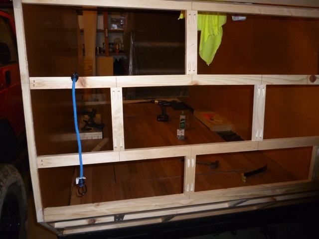

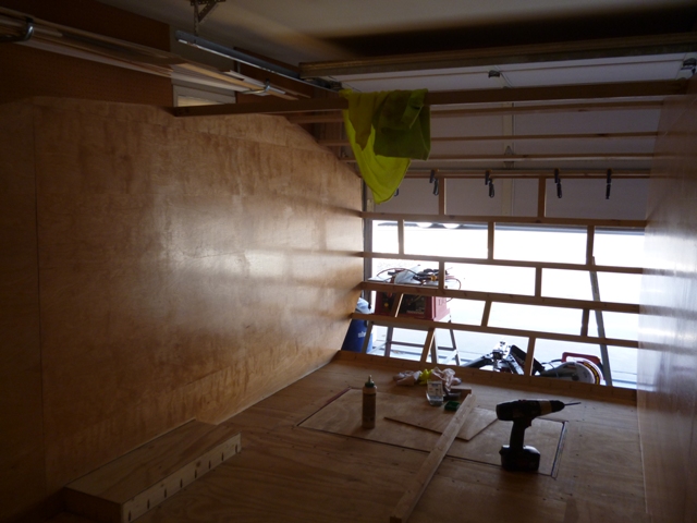

Today I started putting more spars in. I bought 1x12 #2 pinbe and ripped them down to 1x2's. I also blocked the front of the trailer to help give nailing for the interior skins. Here are a couple of pics.

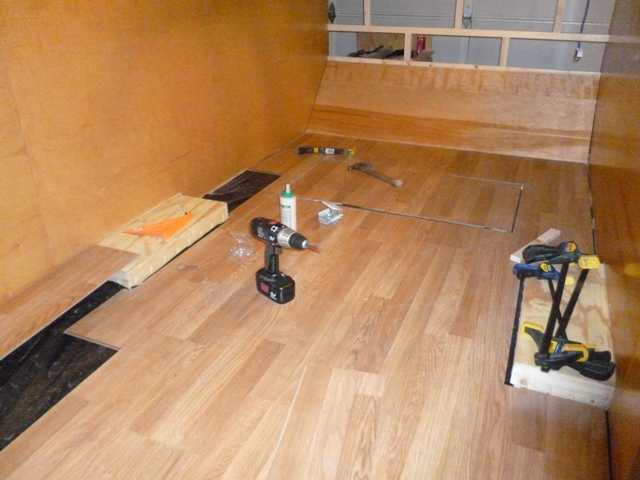

Hey all, well i finally made it back from California so I thought i would work on the Gnome again. Over the weekend I installed the flooring. I purchased this laminate from the orange box over the weekend and began installing it. This was the cheapest flooring I could find that was laminate. I also installed a 6 mil sheet of plastic for an underlayment. Here a couple of pics of the flooring.
I have 2 pieces left of the laminate and then a full box. I can make the 2 pieces work without opening the other box, however if I do not open the other box i have nothing to go over the fender wells. Any one have any ideas of what i could do? I was thinking of just skinning it with the birch and have it the same as the walls.

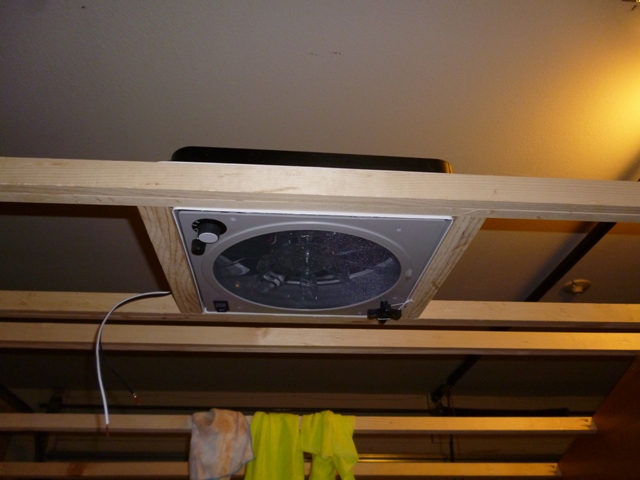

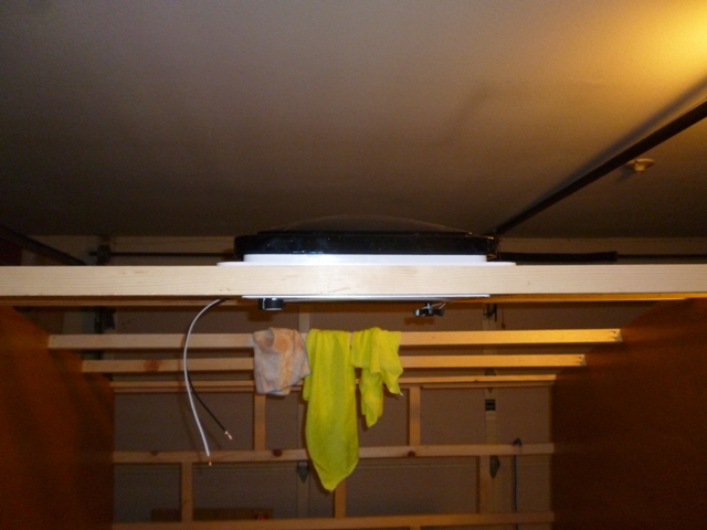

I also got my fantastic-fan in today so I went out and framed it in for a mockup. These fans are sweet looking! Here are a couple of pics

Postby aggie79 » Thu Oct 20, 2011 8:33 am
Michael,
The Gnome is looking great! I really like the flooring. As far as the wheel wells, I'd probably just go with paint. No need to spend the bucks on another box when you are only going to use a few pieces of it. ( :x For some reason, doesn't it always work out that way.) I think you'll love that fantastic fan. They are a nice bit of engineering and work great.

Postby starleen2 » Thu Oct 20, 2011 8:42 am
Nice Build :thumbsup: My question is, why did you use cleats instead of a single strip when joining the wall pieces together??

Postby Zboom » Thu Oct 20, 2011 7:11 pm
aggie79: As far as the wheel wells, I'd probably just go with paint. No need to spend the bucks on another box when you are only going to use a few pieces of it.
droid_ca: if you open the other box could you build a tongue box or shelves or cutting boards or table tops that would all match the trailer?
thanks for the compliments guys and the suggestions. My wife and i sat there and stared at the wheels wells for a while. We both decided not to open the box and take it back so I could get some aluminum angle to trim the belly box. We decided since we are going to have a lot of scrap birch due to the over size width that we would just skin it to match. As for shelving or butcher block this stuff is beyond cheap and would probably get scratched to pieces and look terrible after a while
starleen2: Nice Build My question is, why did you use cleats instead of a single strip when joining the wall pieces together??.
I don't want to lie but I have no idea why I did it that way. i would have liked to have rabbited instaed but the ply is 1/4 inch and expensive so I didnt want to try. i think the 1/4 ply i used as a cleat I had sitting around and was the first thing I saw. When I frame it out it will have addt'l support and I will use a batten on the interior to hide the seam.
