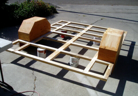

Here's a picture of the floor framing with the wheel tubs temporarily set in place. They actually will sit down 4-inches deeper than shown here. Still trying to decide whether or not to insulate the floor so no plywood yet. I plan on using the floor as my 'bench' and layout table as I work on building the walls so the tubs will installed later on down the road.
[/img]

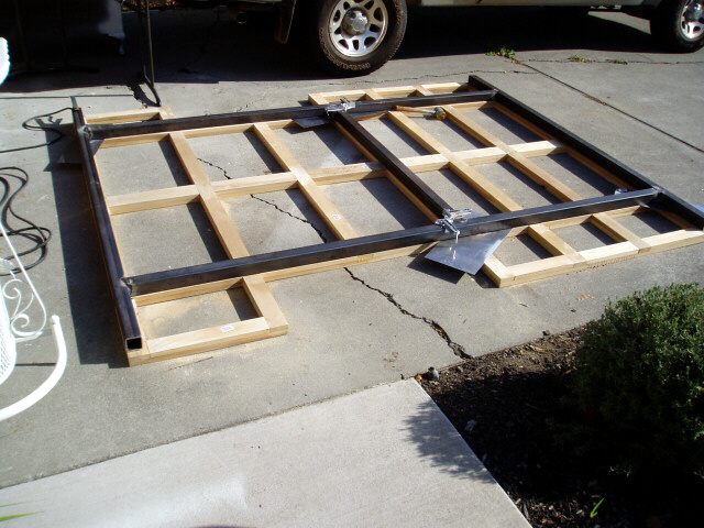

Frame is underway. I used the framing as my frame jig and then held everything in place with picture-frame clamps. Checked for square and did a little tweaking where needed and then tacked it up.
Using 2x2x.120 wall square tubing. 2x2 angle would have been strong enough but I figured a custom built trailer deserved a nicer frame than what I'd build for a utility trailer.

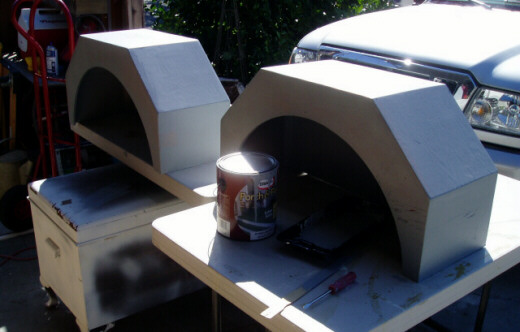

Not a lot of progress as I ended up spending a months budget buying some tools. A little over $200 got me a Black and Decker belt sander, saber saw, circular saw and hand drill so I can move forward on the project. Did manage to finish waterproofing the wheel tubs and give them a couple coats of porch paint.

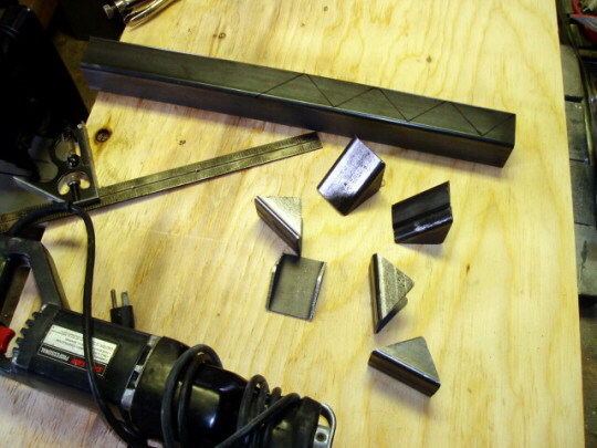

Postby gww25 » Tue Oct 18, 2011 3:00 pm
I'm starting to work on the chassis again and cut some gussets from the scraps of 2x2 stock I had on hand. I was taught never to use flat plate gussets on trailers as they just provide a place for crud to accumulate. This is a harder way to go, especially if you have to cut them as I did with a reciprocal saw. It takes a lot of time and then you have to dress them down with a belt sander. I really wish I had an abrasive chop saw but just can't afford one.

Postby aggie79 » Thu Oct 20, 2011 8:40 am
gww25,
You do some really nice work...very clean and precise! Those brackets look really good.

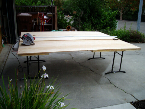

The stuff I ended up buying at Home Depot was regular old 1/2-inch BCX roof sheathing at a little over $31 a sheet which was hard to swallow since that's about what I was paying for cabinet grade 3/4-inch Birch a few years ago. Anyway it is pretty poor quality material but will work about as well as anything. Like most plywood it was not perfectly square or 48x96. My sheets were 48.125x96.1875 but they did have two good square edges. I needed to rip them down to 40-inches wide so I just overlapped the sheets after I squared them to the floor framing and used an aluminum straightedge to cut both sheets in a single pass.

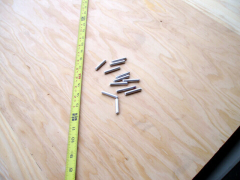

I spent the better part of any hour getting these sheets trimmed square, ripped to width and trimmed to length until I had a perfect fit on the floor framing so I didn't want to screw it up when I glued the sheets down. To make it easy I just made some dowels from a scrap piece of 1/4-inch aluminum rod and then drilled holes in all four corners of each sheet all the way into the subframe. I pulled the sheets up, spread the glue and then put them back down using the dowels as alignment pins to hold the panels in place as I screwed them down. It worked very well.
