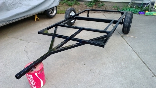

Been a while but I finally had good weather, time and materials - giving me the ability to apply the first coat of black acrylic to the frame.

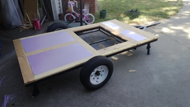

Postby LarryJ » Mon Apr 29, 2013 11:41 pm
Let the sawdust fly!!
Bottom of deck framed and laid out.

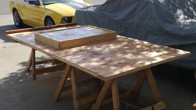

More done this weekend:
Cut and installed 3/4" insulation for the floor.
Finished the drop floor, and added the top layer of 1/2" ply - we now have a nice solid floor.
Flipped it over and applied the first two coats of 'the mix' (four on the edges).
Almost ready for the sticky black stuff.
