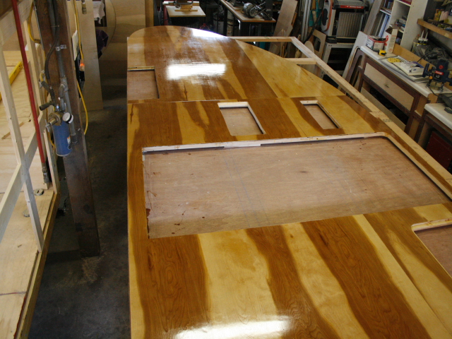

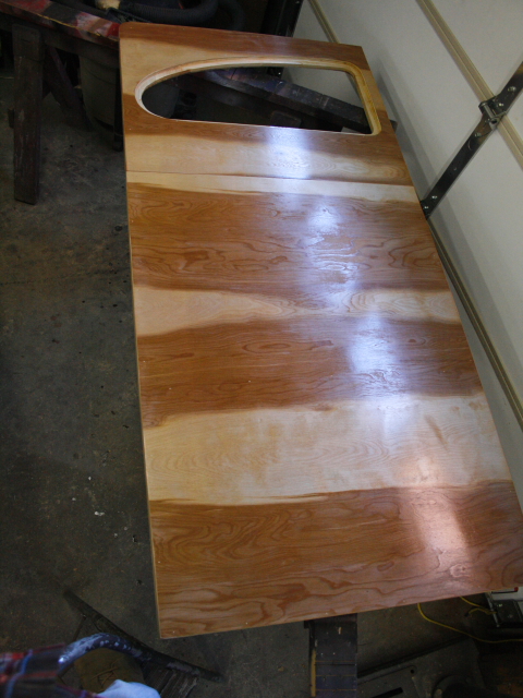

Here are some new pics; I have been able to get two coats of Spar Urethane on the wall the weather has turned cold for a few days and I really don’t want to run the bullet heater or the 150 BTU house heater right now to heat the shop just to put the Urethane on. Any way I found out today that a spot on my right Kidney is cancerous and It is going to require some surgery to fix or (should I say get rid of it) so I’ll have to pull off of the project for three to six weeks to get this done. If I get any more done before the surgery I’ll post the pics.
The door only has one coat on it
Legned Lime, Acworth, GA

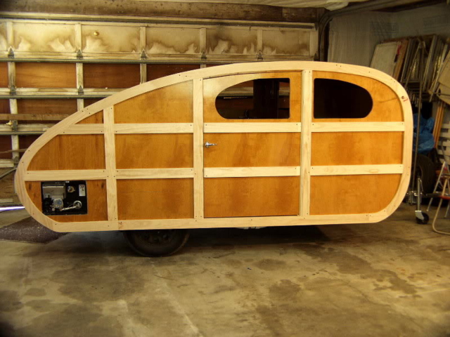

Postby Boanerges4 » Sat Nov 12, 2011 6:19 pm
How did you join the edges of your plywood together? Great build and remember that the saint that advances on his knees never has to retreat. You are in our prayers. keep up the good work. :applause: :applause:

Postby legend lime » Sat Nov 12, 2011 7:26 pm
Thanks everyone for your prayers,
looks like the weather will be warming up next week so I should be able to get this wall completed before all the doctors visits and the surgery I hope.

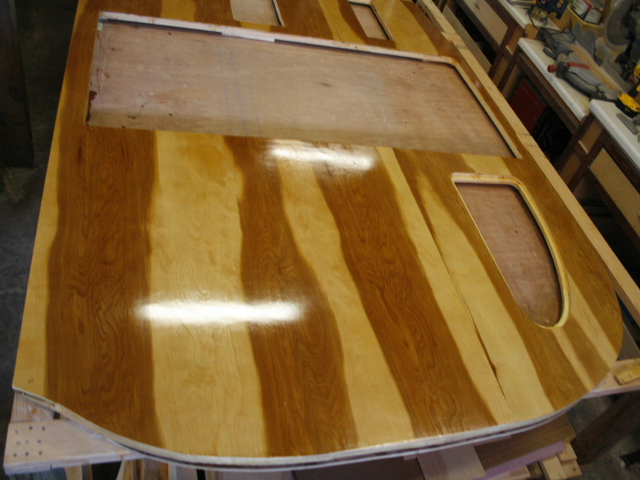

Boanerges4 As for the joining of the plywood edges it's not the edges are all splitting a 1x4 and glued and brad nailed to all the 1x4's that make up the wall structure, this pic of 48Rob cabin car (and I hope he doesn’t mind me using a pic here) shows how the seams will be covered with 1x2 Cypress after they are all coated with five coats of Spar Urethane.

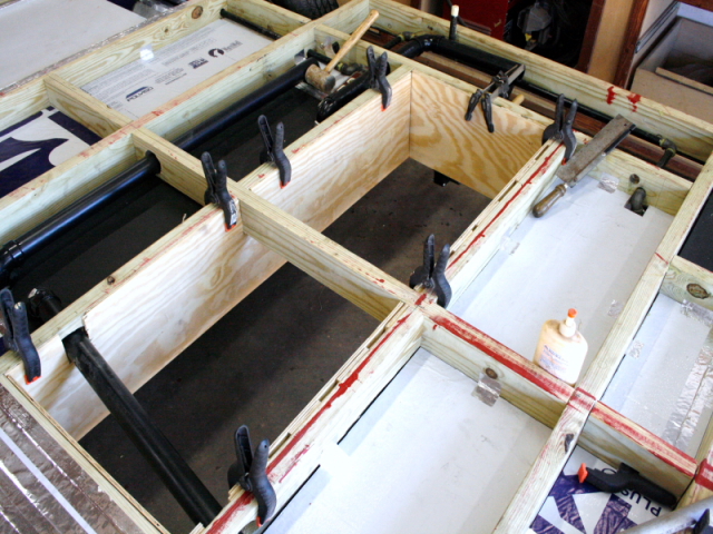

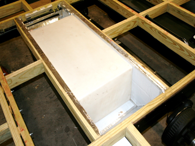

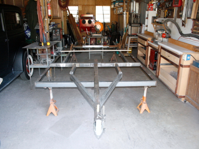

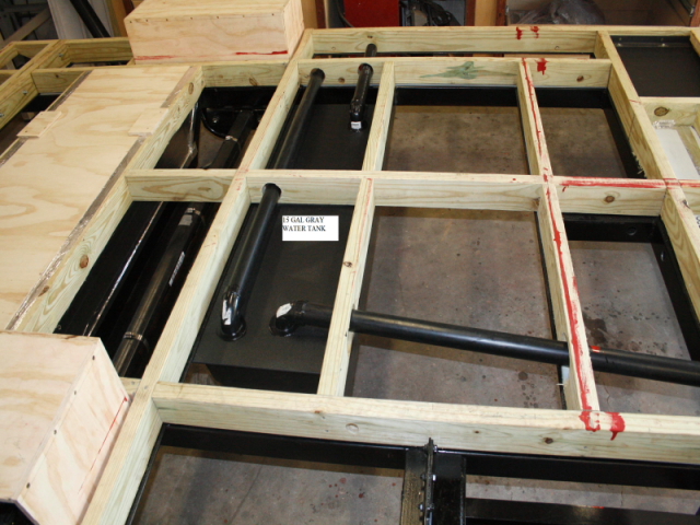

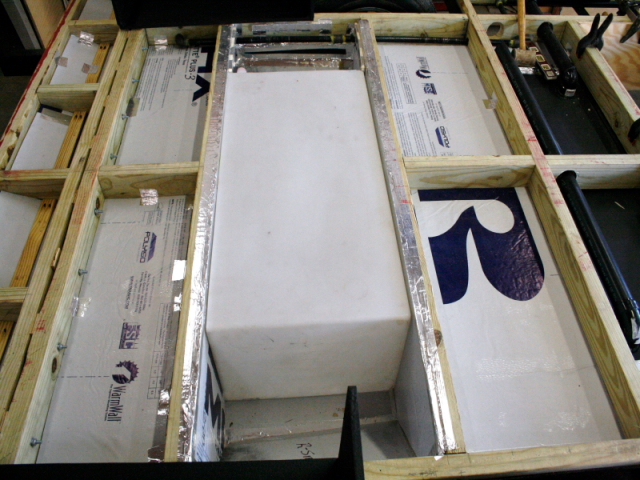

Also when I started this trend I kind of started in the middle so here are some pics of the frame and the holding tanks I installed before I installed the plywood over them, the red paint on the plywood is 4 coats thinned rustoleum and 2 coats of unthinned.
This pic is the under floor storage I added

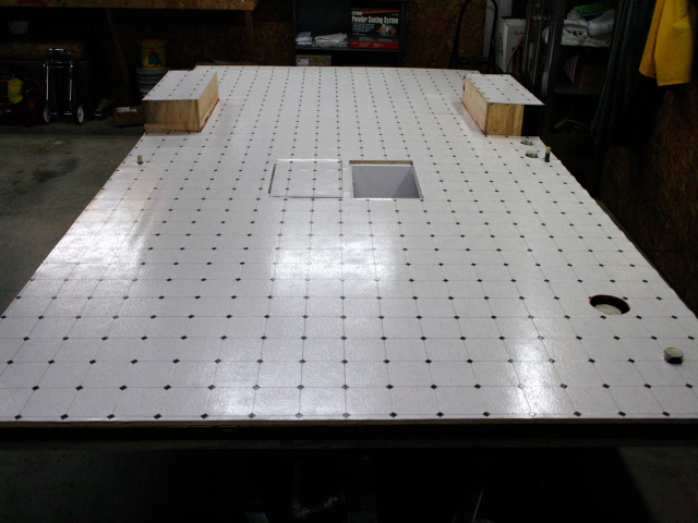

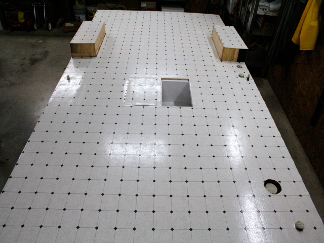

floor covering cut and layed out
Postby legend lime » Tue Nov 15, 2011 8:47 am
Moved the frame up to the garage in the house and layed the floor covering out, cut ready for glue.
The cut outs in the center are for under floor storage
