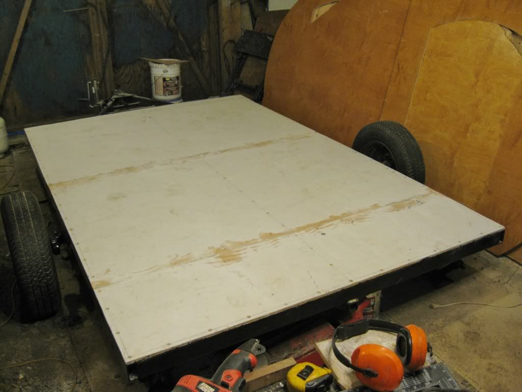

The floor is on, countersunk the holes and used #12 metal screws to secure the decking after construction adhesive was put between the sheets of 5/8" plywood and finished up by using the belt sander to ensure a smooth transition between the ply for the vinyl floor to go on. Image

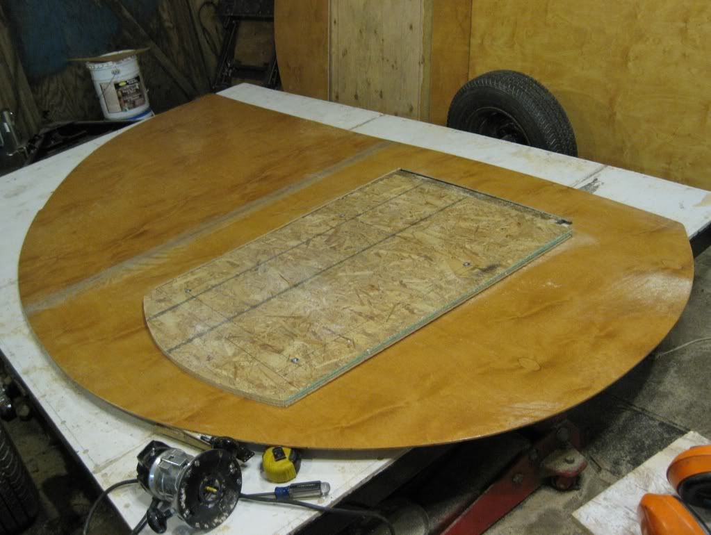

A shot of the door pattern I made from OSB after I'd finished routing the door openings. Secured the pattern to the door with screws at each corner where the window will be cut out, drilled a hole at each corner and ran the router around. Not being a woodworker, I was plenty nervous at this step but things worked out really well.
