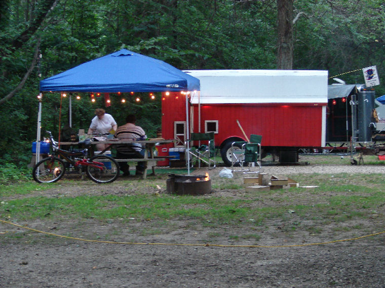

I dug around in my album and found this pic... Here is my auxilery kitchen dining room set up on the barn
If you look real hard , in the background you will see the other tarp set up we discussed on my buddy Jeffs cargo conversion.

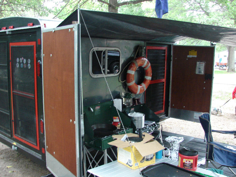

Here is a better shot of his.....
