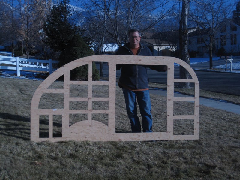

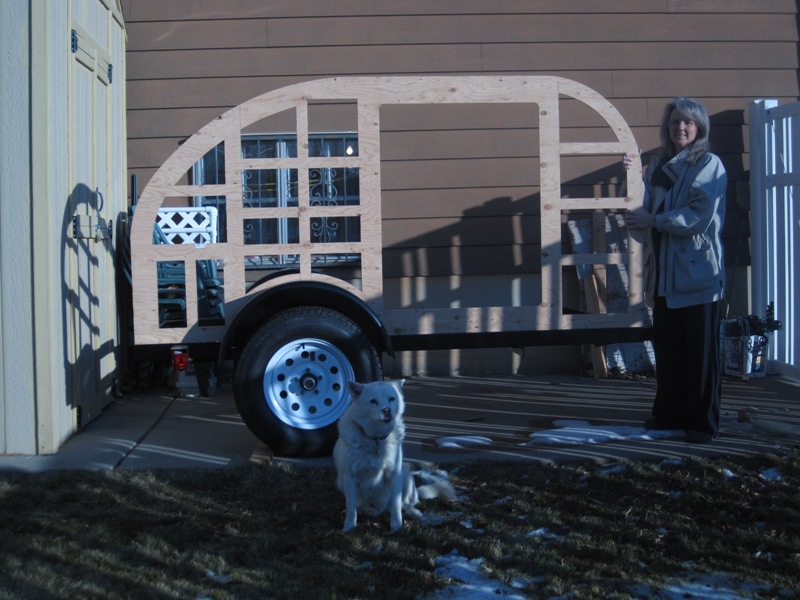

We learned a few things while working on our template. The most important is don't even think about using a router "free hand". I can cut pretty straight lines with a saber saw, not so with a router. That router has a mind of it's own and goes where it wants to. One of the best investments I've made so far is a set of Porter Cable style guide bushings. They made a world of difference.
So after a little "practice" we have a template.
To get a better idea of how big our trailer will be, my lovely assistant held it up on the frame. It'll be 69" from the ground to the roof.

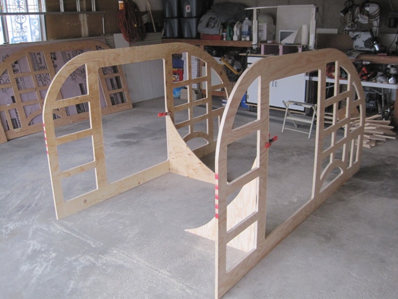

Postby PSBreen » Fri Dec 30, 2011 5:30 pm
Just had to stand up the walls to see what it'll look like. Now back to work. Need to sand the edges and cut some insulation. Hoping to add skins this weekend.

Postby canned o minimum » Fri Dec 30, 2011 7:47 pm
"I" see that THIRD wall... izzit gonna be a DUPLEX ? LOL !

Postby PSBreen » Fri Dec 30, 2011 9:01 pm
Nope not a third wall, just our template. I do have to remember to build a left and right wall though. :D
