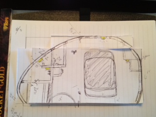

Postby CHUNKYMONKEY » Sat Mar 10, 2012 12:04 pm
A rough layout of my profile.

Postby droid_ca » Sat Mar 10, 2012 12:11 pm
looking good :applause: :applause: :applause:

Postby CliffinGA » Sat Mar 10, 2012 11:28 pm
Looks great Angela!! When you coming up my way to my 2 tears?
Cliff :thumbsup:

Postby CHUNKYMONKEY » Sun Mar 11, 2012 7:34 am
Cliff I want to come over soon. My house is under contract and that has been cutting into my free time. I'd like to come over when you are working on yours. I could be an extra set of hands if you could use them. I plan to get my wood for my sides next Sat.

Postby Oldragbaggers » Sun Mar 11, 2012 9:43 am
WELCOME ChunkyMonkey. You're in for a very satisfying and rewarding adventure. I think it is very cool that you are using your dad's trailer. You will no doubt be thinking of him as you build, and you'll be taking a part of him with you when you camp. That's awesome.
It looks like you're off to a great start. Keep the :pictures: coming. And any questions, as you can see all you need to do is ask and some kind soul (or several kind souls) will always be willing to jump in and answer!!

Postby Oldragbaggers » Sun Mar 11, 2012 10:02 am
Next weekend I plan to get the side wall ply. I'll then spend much time working on my profile outline.
Angela
:goodmorning:
Angela, when I was working out my profile I bought a cheap ($10) piece of luan underlayment and layed out the profile and door opening on that first and cut it out. After I had done so, I realized I didn't like the slope of the backend as much as I thought I would. Also I discovered I didn't like the shape or placement of my door but that wasn't really apparent to me until I cut it out, stood the wall up and crawled in and out of it and took a picture of it (actually the picture revealed to me that it didn't look that "balanced". I didn't really see that with my eye.) I made the adjustments on the luan. I have used it many times to figure out (and often change) the placement of different things. Since it's not my real wall I didn't mind drawing all over it. And it's much more durable and easier to handle than cardboard. Also, since I am building a sandwich wall, I keep using it over and over to trace the profile on different pieces. Only after I was sure I had the exact shape I wanted and had my other structures figured out did I put the saw to my real sidewalls. (Placement of other structures was important to me because I am building a sandwich wall.)
Depending on how you're constructing your wall this may or may not prove useful to you, but I thought I'd toss it out there.

Postby CHUNKYMONKEY » Sun Mar 11, 2012 10:26 am
Thank you Becky, That is very smart advice. I will definitely consider doing that. I plan to have solid 3/4" ply (MDO) but still would be smart to draw and cut the luaun board to perfect all shapes and cuts.
I have reviewed your work many times and loved the journaling you and so many have done for this site.
Keep the advice coming, I certainly can use it.

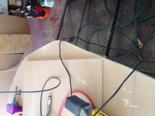

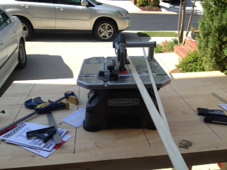

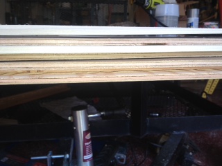

Postby CHUNKYMONKEY » Sat May 05, 2012 12:29 pm
Well I've been distracted by many other events this spring, the best of which I finally sold my second house.
I have been working the past two weekends on my tear. Last week I purchased 3 sheets of 4x8 MDO 3/4. They are so smooth and will make an nice exterior surface for paint. I am stretching the sides by ripping the 3rd sheet (two 1 foot pieces from the 4' end, two 1 foot pieces from the remaing 4x6 piece. I am cutting a 1/4 in slot in the end pieces to join them. I got the first side glued today and have a few pictures to show.
After the glue dries I will begin cutting my profile. My CPES arrived this week. It's past time to order my hardware.
had to show my new Rockwell Bladerunner
Hopefully by tomorrow, i will have both sides glued with the extended isdes
8) :? :shock:

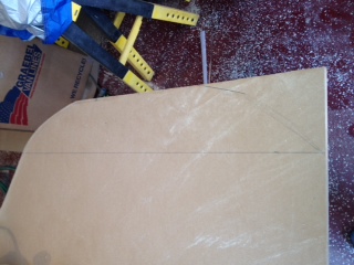

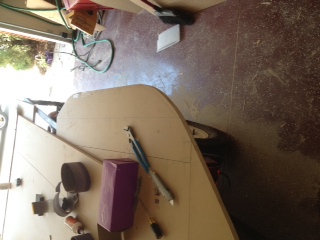

Postby CHUNKYMONKEY » Sun May 06, 2012 2:57 pm
a few more pictures as i'm cutting out the profile. Still looks a bit like a whale. My belt sanders keeps tearing my belts.
Taking a break
Got second side all glued up with splines today
Maybe this week i'll get both sides cut and shaped up.
