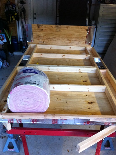

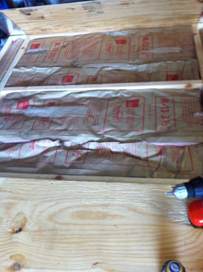

We finished skinning the underside of the base with the peel and stick rolls. Figured out why it was taking me more, I mistakenly bought the 6" instead of the 9" wide rolls. I then flipped the base back over and used some simple 2x4 size insulation, put the floor back on.

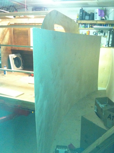

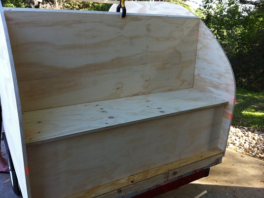

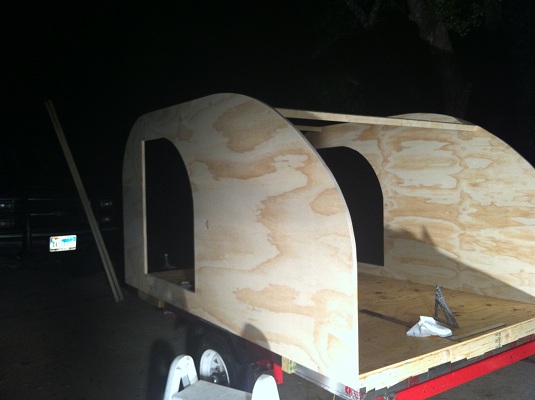

Next we cut the door in the first wall panel, then clamped it to another piece of plywood and traced and cut the second wall.

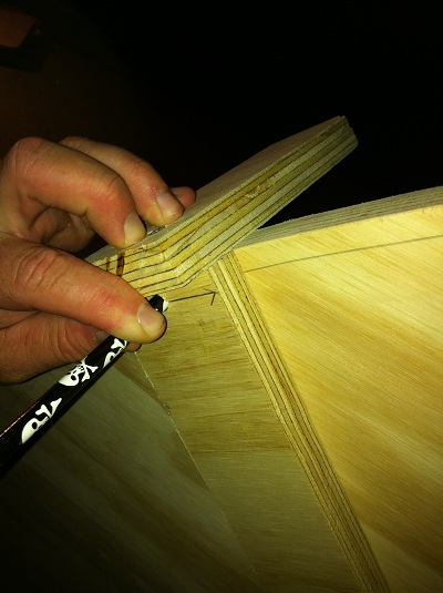

Finally we built a simple jig to mark the 3/8" cut for the hatch seal.

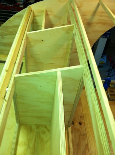

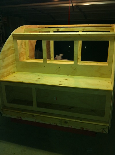

Finally we mocked up the cabinets to help us decide on the set up we wanted.
That's all the pictures I took, but we ended up deciding on three even doors across the top galley cabinet and on the bottom it will be three matching doors but two openings - I'll get pictures up soon for this one.
Galley cabinets are ready (no doors yet), working on interior cabinets next. Then gluing sides, cabinets and spars in place. I found a local supplier for the 1/8" birch and I'm hoping to get that and my wiring supplies ordered next week.

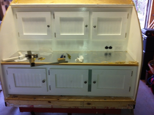

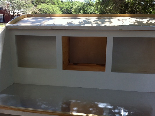

We did another dry fit to figure out the layout we wanted for the galley cabinets.
We ended up with varying depths, drivers or street side for us will be spices over the sink, middle (I ran out of wood but can add later) is going to be almost 100% utilized for the Galley area for dish storage while the cabin side of the middle is going to be a flip down door with a small stop point on the end for placing portable dvd player for viewing, the passenger or curb side will be toiletries on the cabin side and cleaning supplies/small propane bottles, etc on the galley side.
Once everything was how we wanted it, we glued cabinets, walls and spars in place and parked it until next time.

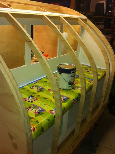

We used a simple 20" wide roll of aluminum roof flashing for the galley counter top. First spread glue on the wood surface, laid down the aluminum and the put a bunch of heavy stuff on it (covered it in boards and then some 80lb quickrete bags on the boards). Let it dry for a day and then my wife found a tip online for bending this stuff around a corner by essentially using a body work hammer right at the corner and then working down to continue the bend. She did an awesome job and it's a much cleaner solution than the (cut and hide with trim) I probably would've done.

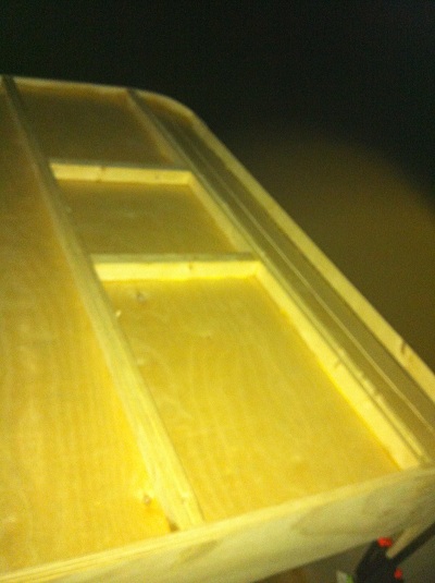

She then started painting the galley area while I was working on the hatch.

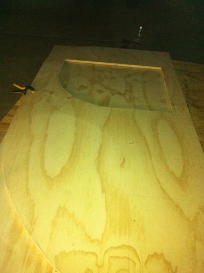

I was excited about this part - the first hatch framing test fit (it's not completed and I'm hoping the cross spars in the middle make a big difference on keeping this thing square in the corners).

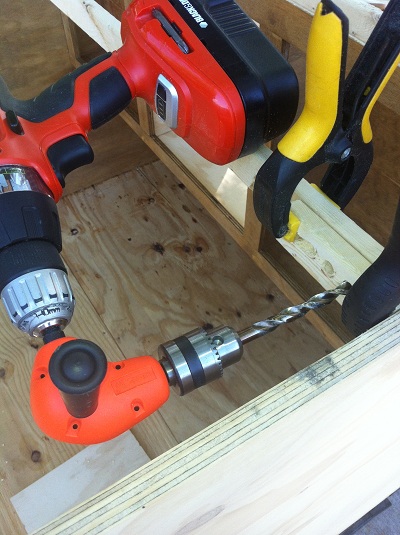

Quick update on my build.

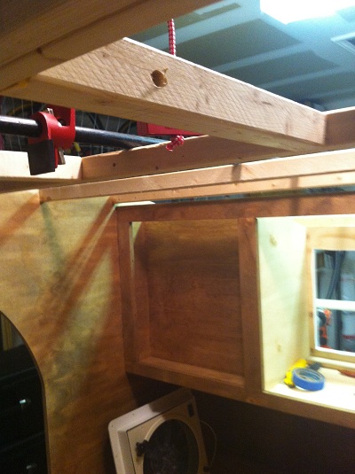

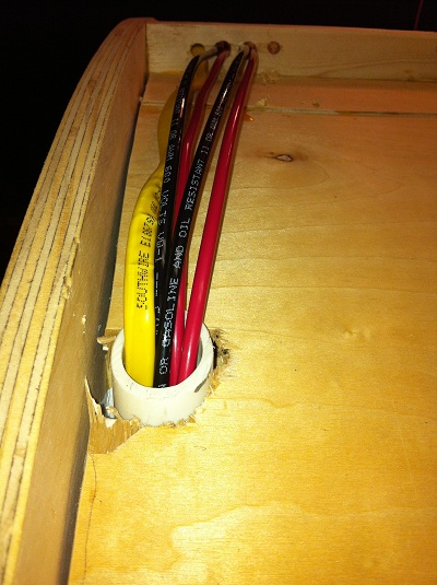

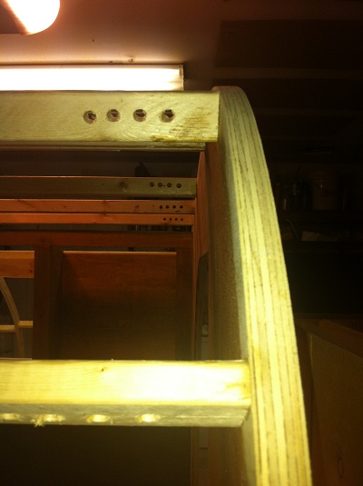

Lesson learned - drill your wire routing holes in the spars before you glue them to the walls. I didn't have enough room between some of my spars for the drill so I had to use a 90 degree adapter for my drill.
They're all completed now though!
I test fit my vent fan and marked the wire placement there and drilled as well.

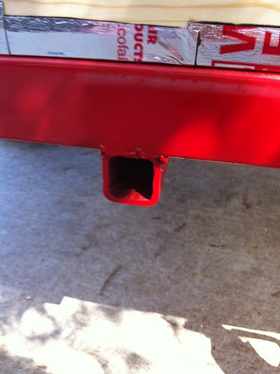

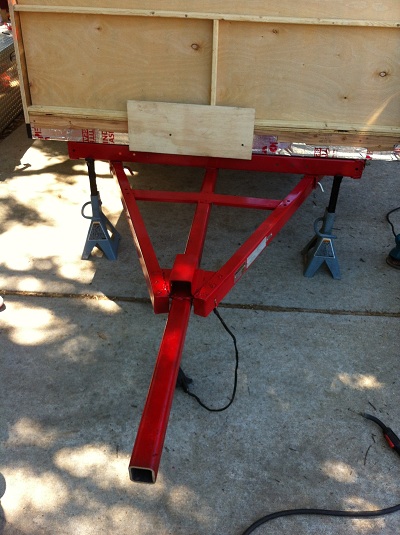

Welded in the trailer tongue extension enough to fit my trailer box using a 2" square tube that runs from front to back. (This one would've obviously been much easier to do before anything was attached to the frame)

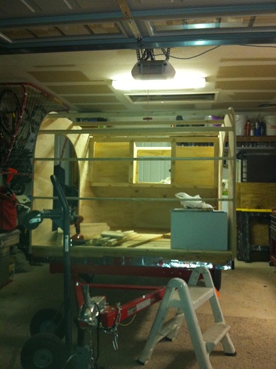

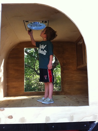

Interior skin is in - this by far was the most difficult thing we've done on the project. I had a poor cut (1/8" too wide for about 4") that put the ceiling in a bind between the walls right at the front radius. It's in now though.
My measurements were slightly off the generic benroy plans because my walls are attached a couple inches higher on the sides (to clear the existing HF fenders). We ended up leaving the 'headliner' much longer than the plans, and after all others were completed we marked the location of the last spar and then attached it to the headliner. After drying overnight we then used a flush trim bit on my router to cut off the access headliner before installing the last spar to the walls. This worked great for me and prevented a mathematical error, I was worried about cutting too much off.

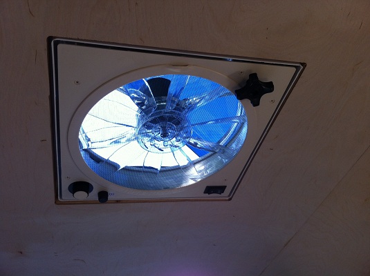

Cut in the opening for the vent fan, and had my quality control check approved by my little one. :)

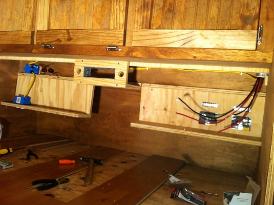

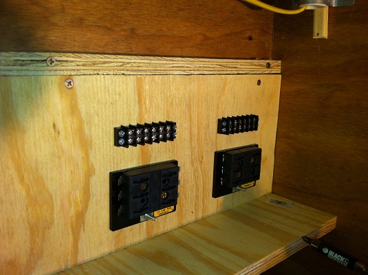

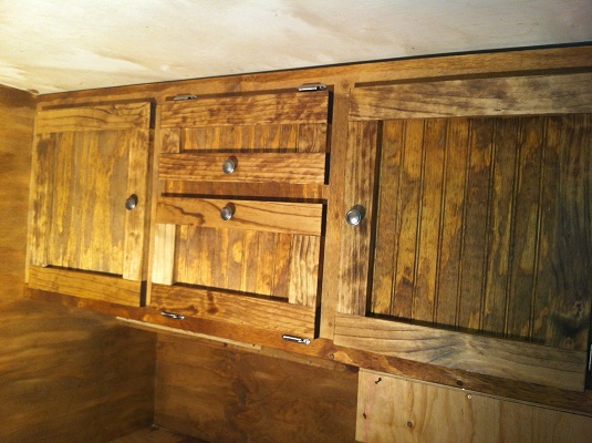

Cabinet doors are assembled, and either painted or stained. We had not even hung a cabinet door before this weekend so it was a little challenging to make the doors and hang them but so glad this job is done now! Well almost done, we still need to add the 'false cabinet divider' to one of the lower doors on the double wide opening and probably add another coat of paint and stain (we're sealing all the stain at once after it's all on).
Started on the electrical as well (you can see the plugs in the above picture - 1 110v and 2 12v in the galley on the right.)
We decided to cut our stereo mount into the raceway, the middle 1' is locked in place to house stereo and 2 12v plugs, while the outside 2 foot sections will be removable for maintenance as needed. I plan on running 2 batteries down the road (1 accessory [stereo, 1 12v plug in cabin and 1 in galley], 1 trailer functions [lights, water pump, fan, etc]).
I butchered the cut for the conduit, really glad this is hidden in a small cabinet. I've purchased new hole saws now and will attempt the light mounts in the ceiling at some point this week.
