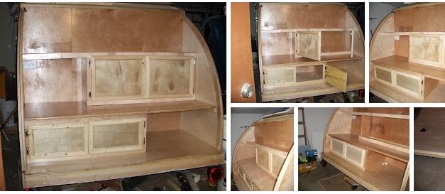

Postby pohukai » Sun Sep 23, 2012 9:07 pm
Galley completed. Doors made of luan and framed with routered 1.5 x 3/4 fairing strips; the same stuff I used as spars. Cheap and with 2 coats of varnish seem to be fine.
Next week I plan to finish the electrical interior stuff.

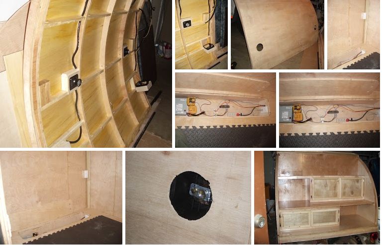

Postby pohukai » Mon Oct 15, 2012 9:02 am
Well, since the tail lights can not hang below 15" from the ground and saving my shins while walking around the trailer at night is a priority, I decided to embed them into the hatch. Due to the unusual shape of the HF lights, embedding them was a little challenge. Here's what I did.
I also got a 12v fuse block and have most of the wiring completed. I can run on 12V drill batteries or the computer power supply. I have 2 120mm computer case fans for roof ventilation that I'll frame and mount so that it can be flipped to provide intake or exhaust.

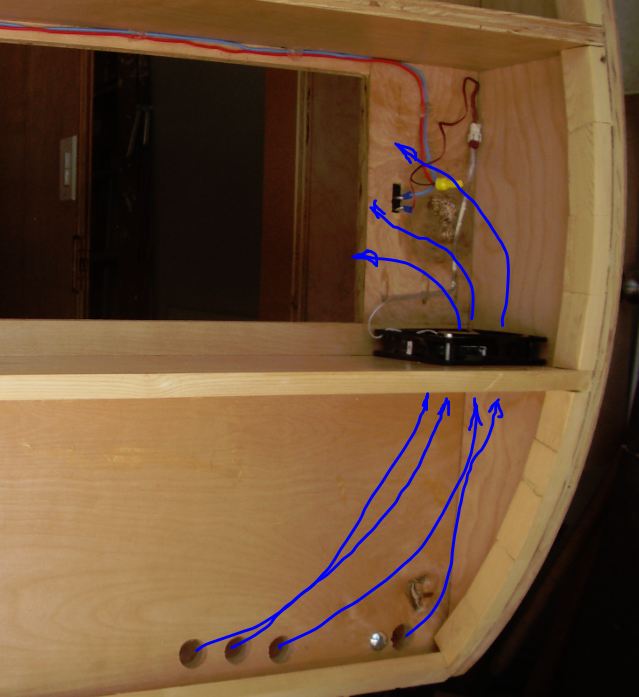

Postby pohukai » Sun Nov 04, 2012 6:28 pm
I had a brief delay with making my Halloween costume from the leftover styrofoam I used for insulating my ceiling which was scavenged from a dumpster. I had about 6 different "Jack" expressions I changed through out the day. The blocks of styrofoam are glued together with left over exterior latex house paint cause that's all I had. It worked great.
I finished the wiring of the front air inlet. I use 120mm computer case fans with a hole in the shelf. The air holes on the bulk head open up to the bottom of the 2x4 frame under the camper floor. I may place some screens underneath to keep little fury friends from visiting. Tonight, I'm planning to skin the last section of the teardrop.

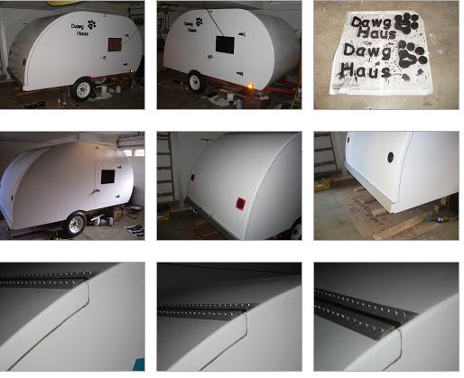

Postby pohukai » Sun Jan 13, 2013 11:06 pm
Did a lot this weekend.
  • 3rd coat of white rustoleum paint
  • mounted bumper
  • attached hatch with living hinge
  • mounted tail lights
  • mounted letterings for 'dawg haus' - passenger side only
  • remounted doors and hardware
  • mounted hatch handle

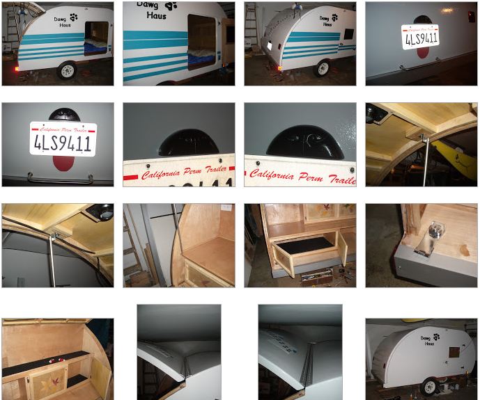

Postby pohukai » Mon Jan 28, 2013 12:32 am
With an all white teardrop, I felt I needed something more. The verdict is still out (aka, the wife) with the painted lines on the side. Thinking of yellow lines. Also, out of a 2x4, I carved a dog nose for part of the license plate light.
I made the hatch props from some 1/2" stainless steel rods that I found in the neighbors garbage can about 5 years ago. I plan to use 1/2" kwik clips to hold them in the stored position as well as in the 'open' position.
I slept in the the teardrop for the past 4 nights although only parked in the garage. With a thermarest and sleeping bag, I really slept well. (Although I rarely have difficulty sleeping).
